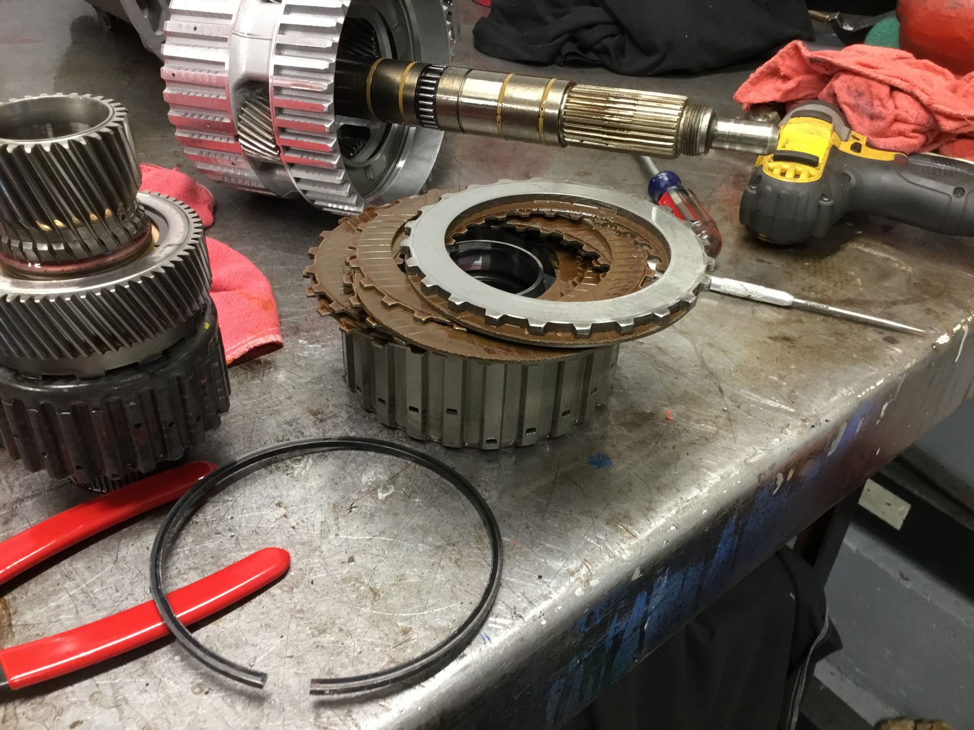

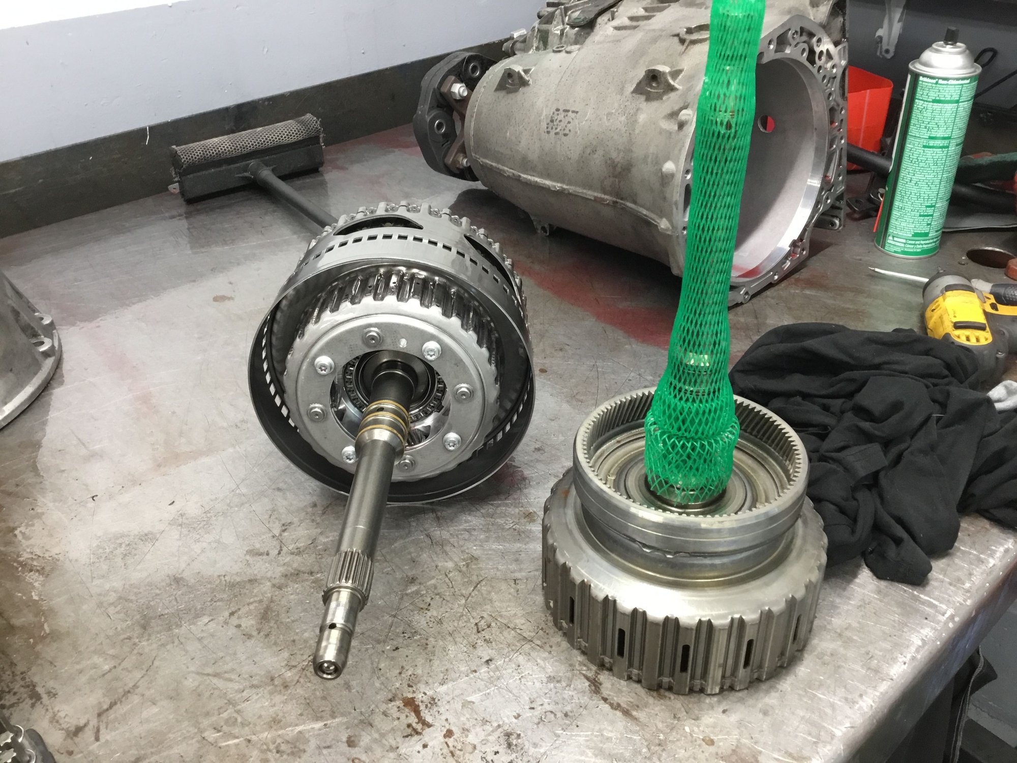

Had some spare time on my hands so did what every normal car guy does….yank the trans and engine out for some mods !!
So picked up a new TCU from Troy that is called the Sequential TCM that has instant up shifts with no delay from the paddles and has full pressure.
Love it but since I will be making more power this year I am adding one extra clutch in 4th and 5th gear clutch packs,only use those gears when roll racing, and running them a little tighter as per Troys recommendation to accommodate the faster shift times of the TCM. Had to mess around with the clutch’s and snap rings but in the end well worth the extra piece of mind and more holding capacity for sure.
The smaller drum is forth gear.
The drum with shaft is third and I also had it Cryogenic treated for strength since it is a known weak point when making more power. One extra clutch as well.

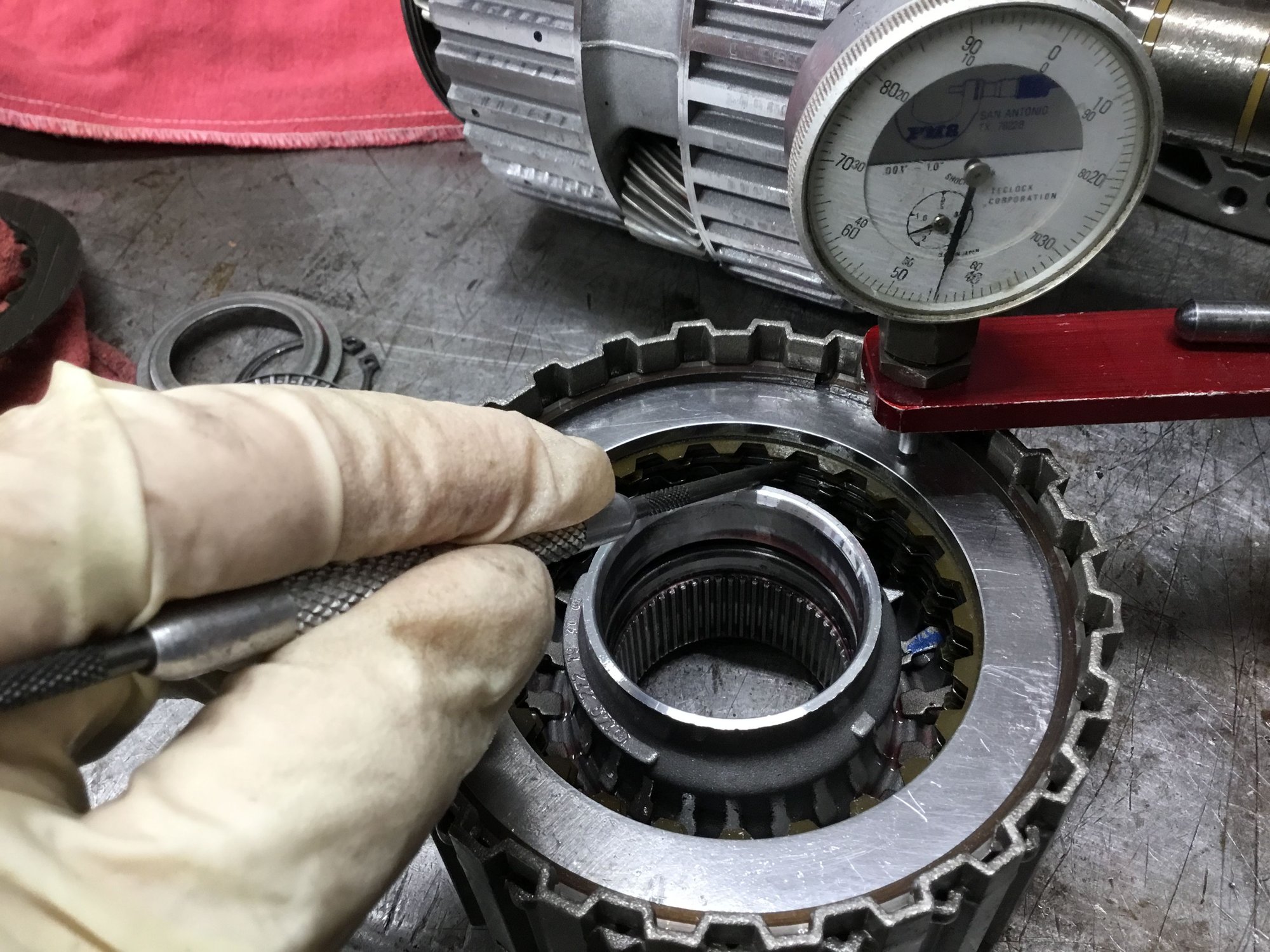

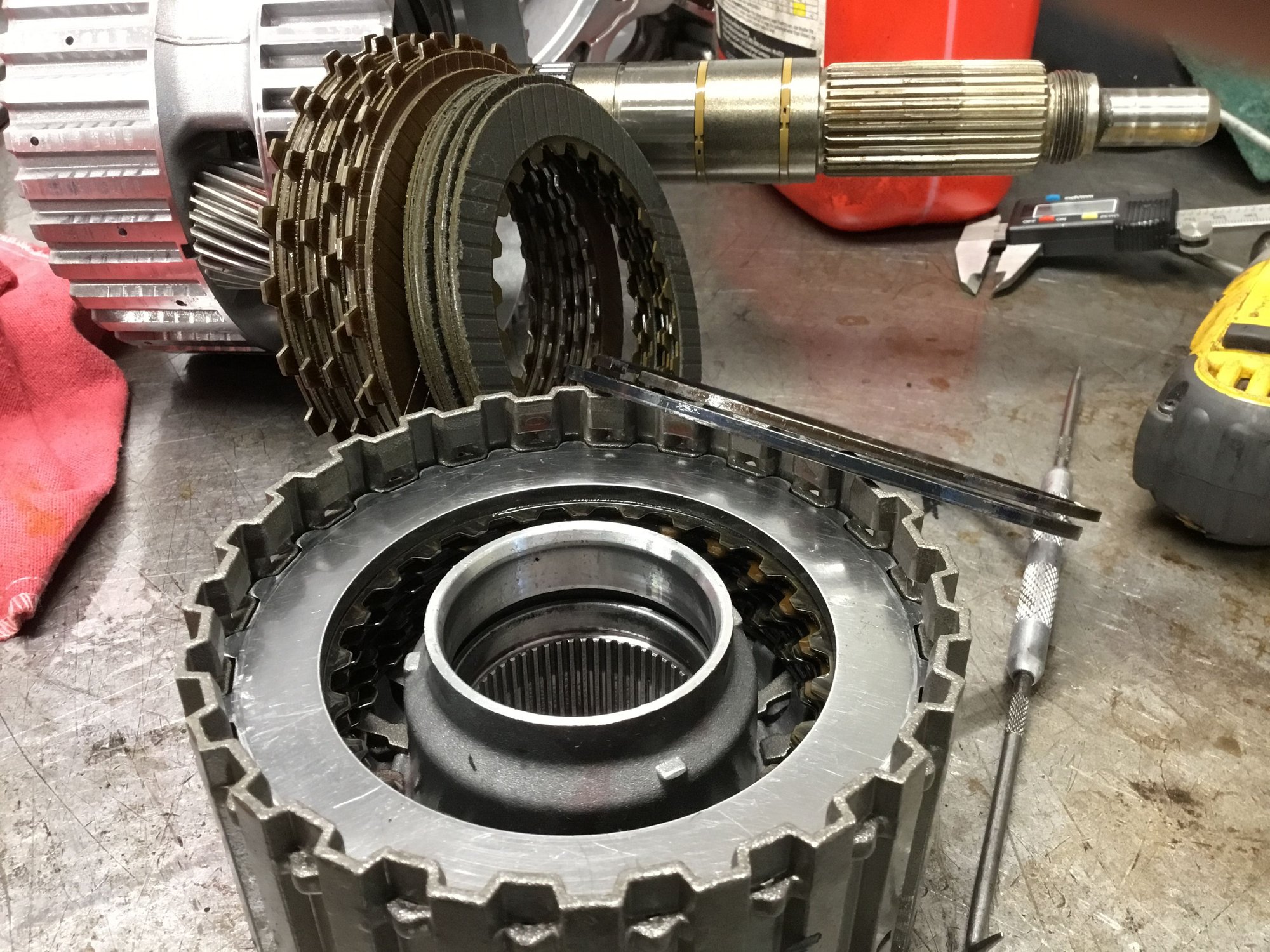

So what I am trying to do ,painstakingly, is to get my clearance exactly where I want it.
The reason is the new TCM shifts VERY VERY fast and we need the clutch pack to “come on” very fast with no delay since 3-4 shift are the only clutch to clutch shift.
You can read all of this stuff on Troys web site.

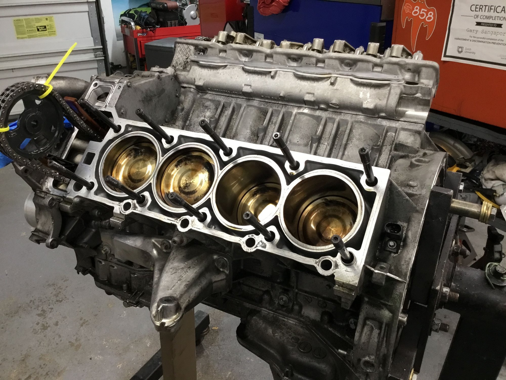

Cylinder walls look great and head gasket seal as well.

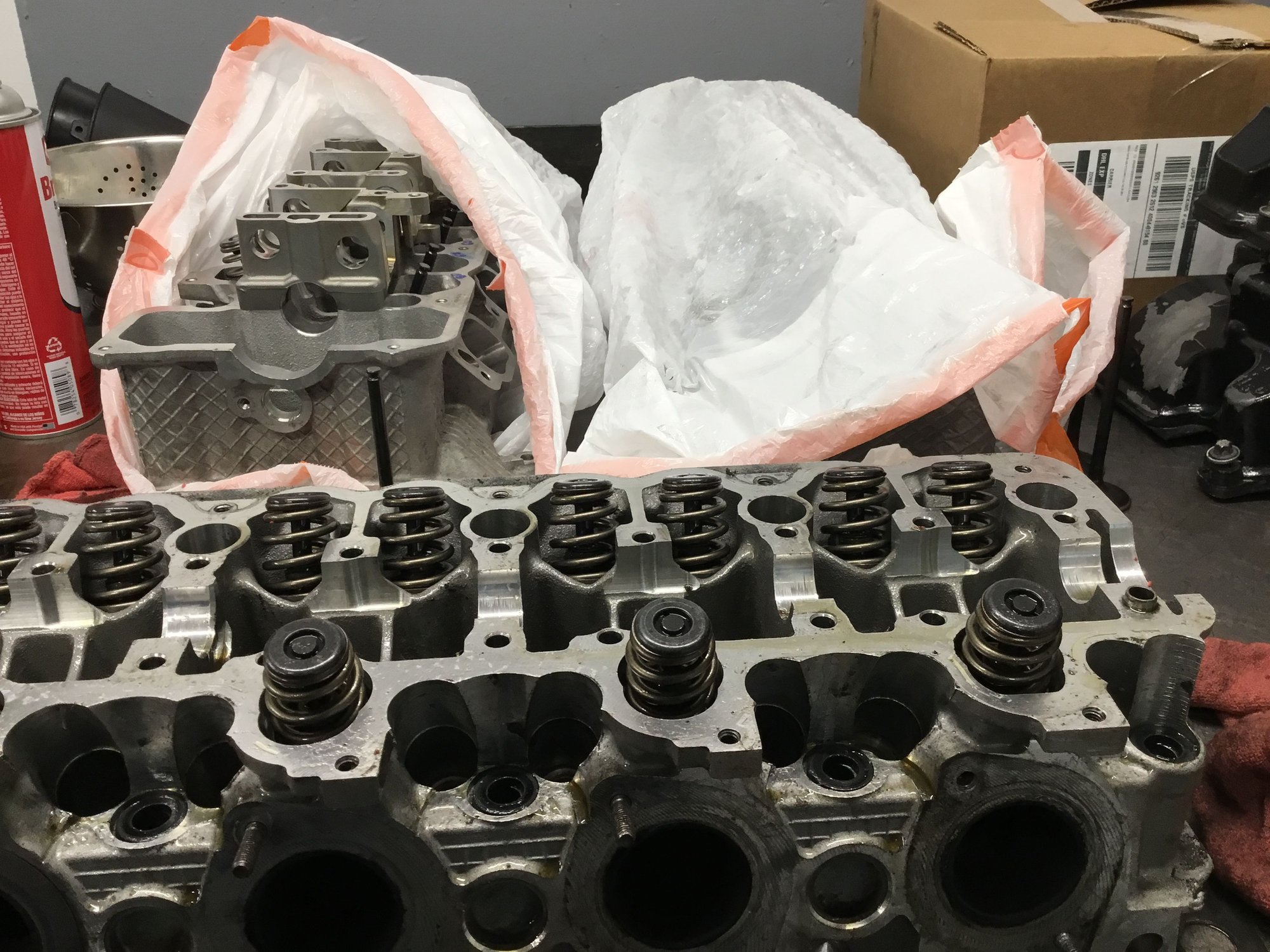

Just need to swap over valve springs to new heads. The new heads flow 40+ cam more than these that where ported already so a big improvement for sure.

So I have found that since running higher spring pressure that the rocker arm shaft saddles are showing a little more wear than wanted so I opened the feed holes and chamfered the holes which I had done before but went a little more this time. I think a WPC treatment would really help but then I have to send cams to California for the process and don’t really want to do that this time of year and the chance of damage to the cams.
Also found that the piston rings could not handle the pressures and where really worn out so cleaning up the bores and going with Tool Steel Nitrite upper rings and Napier 2nd rings and they should hold up to far more pressure/abuse……..I hope !!
Block will be back to me on Monday.

So the bores where not that bad so that’s great. Pistons are getting coated in PC-9 from Swain Tech Coating,and really good anti friction coating, and will be a little thicker to keep piston a tad tighter in the piston bore.
With the Tool Steel rings I should be able to spray it harder and make more power in the end and not hurt anything again,not that it wasnt running perfect before but would soon start showing signs of oil burning Im sure. Bearings also look like they came right out of the box.
