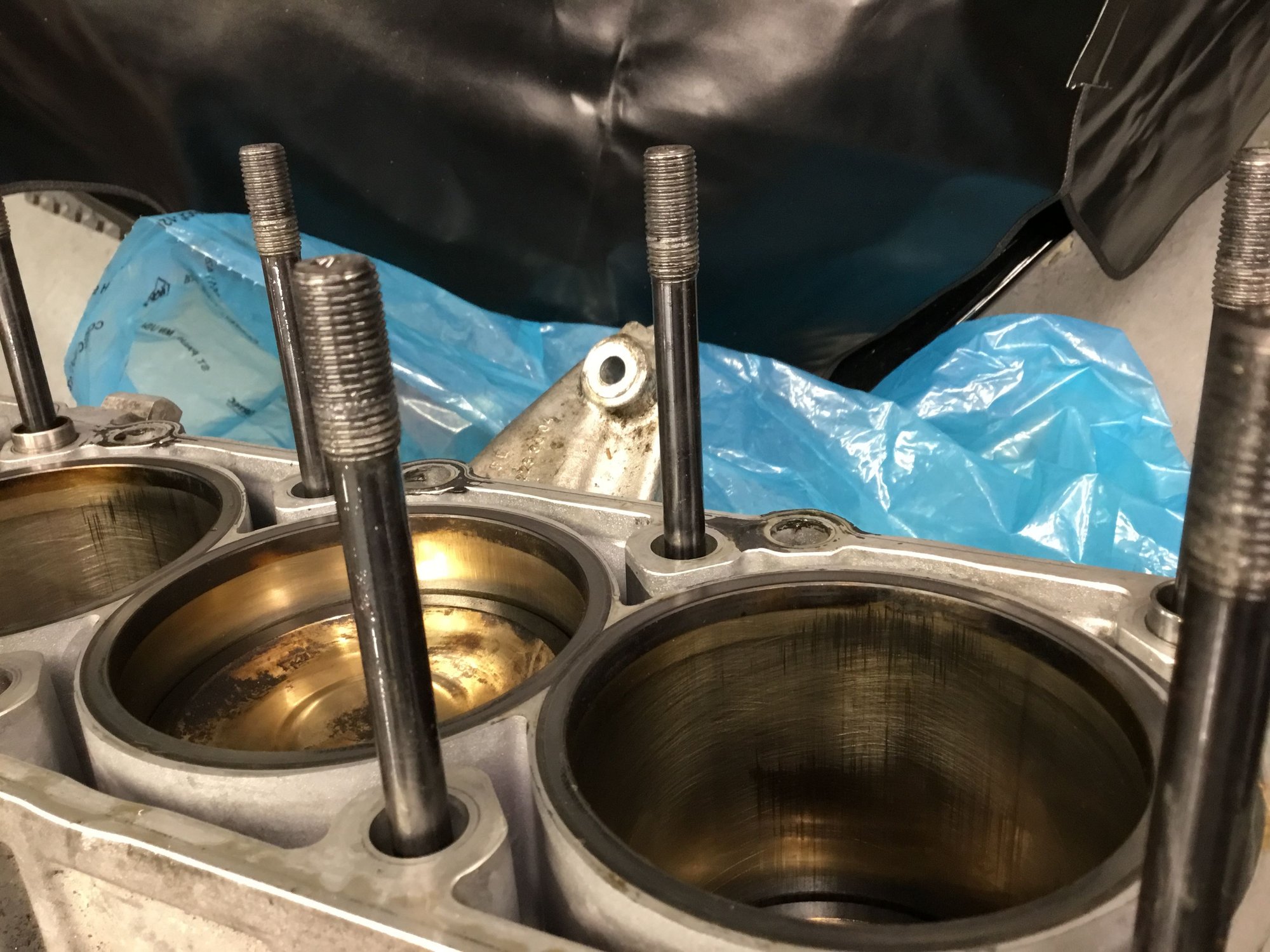

So I have found that since running higher spring pressure that the rocker arm shaft saddles are showing a little more wear than wanted so I opened the feed holes and chamfered the holes which I had done before but went a little more this time. I think a WPC treatment would really help but then I have to send cams to California for the process and don’t really want to do that this time of year and the chance of damage to the cams.
Also found that the piston rings could not handle the pressures and where really worn out so cleaning up the bores and going with Tool Steel Nitrite upper rings and Napier 2nd rings and they should hold up to far more pressure/abuse……..I hope !!
Block will be back to me on Monday.

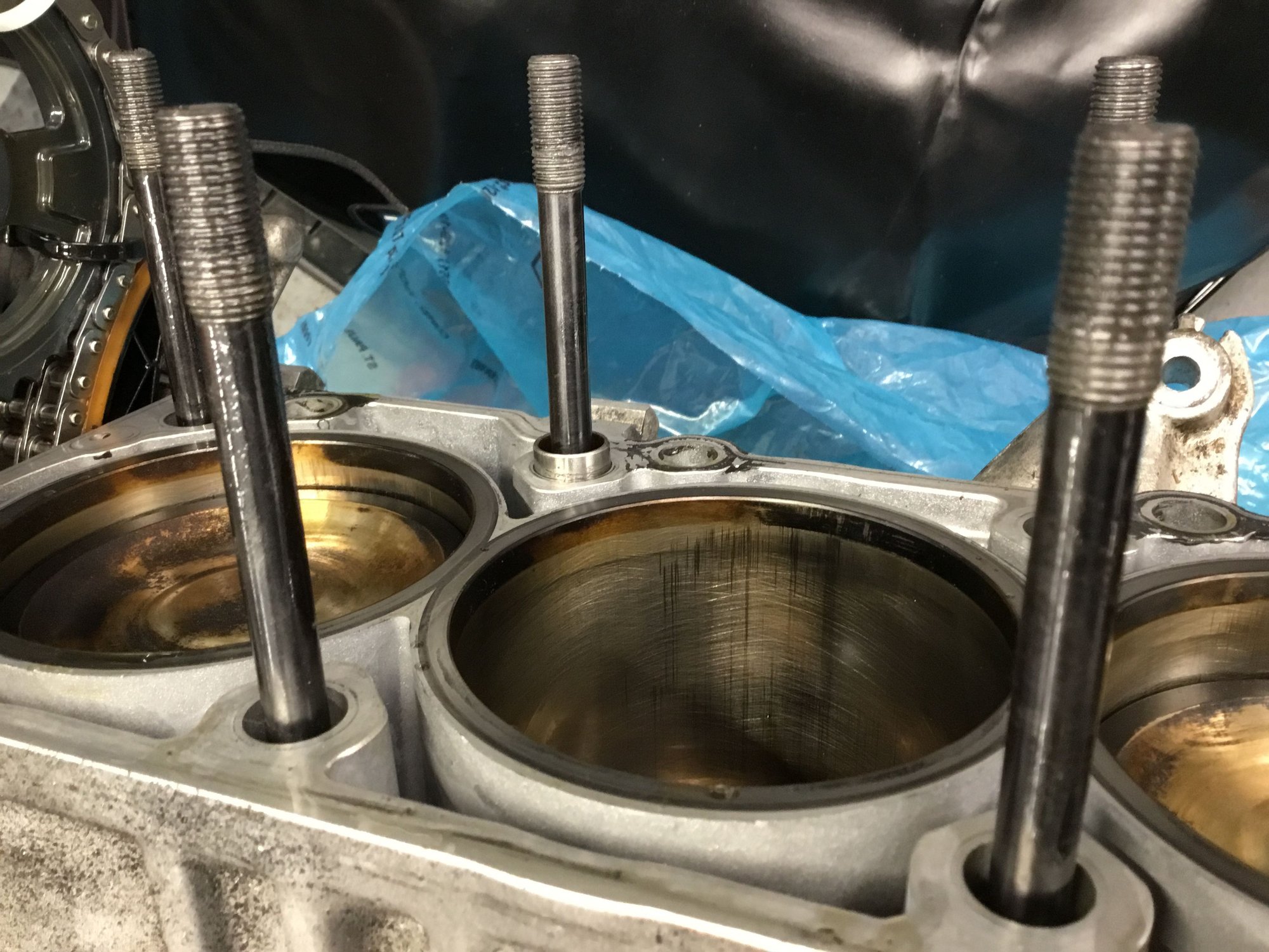

So the bores where not that bad so that’s great. Pistons are getting coated in PC-9 from Swain Tech Coating,and really good anti friction coating, and will be a little thicker to keep piston a tad tighter in the piston bore.
With the Tool Steel rings I should be able to spray it harder and make more power in the end and not hurt anything again,not that it wasnt running perfect before but would soon start showing signs of oil burning Im sure. Bearings also look like they came right out of the box.
Just to recap the cylinder walls again. It was really bugging me as what I was looking at and had some smart guys help me out but no definitive answers.So here is my best shot. If you look at the picture on top,closets cylinder to you looking at it,you can see that there is a "good" spot on the wall. So the piston was stoping at the top, rocking in the bore,then proceeding down Which is crazy to think of it that way. The very top of the stroke is call the "dwell" time and is how long the piston sit's there at TDC. FYI- A longer connecting rod will give you more "dwell" and technically more power from the compression stroke.If there is to much clearance the piston will rock a little to much and at the same time the rings will move slightly in and out of the piston and the wear process begins from there.So the lower scratch's are from the skirt and the upper the rings and piston ring lands.One of my theorys was warm up time before I would kill on it but I always,or so I thought ,warmed it up well but I guess not enough who knows.

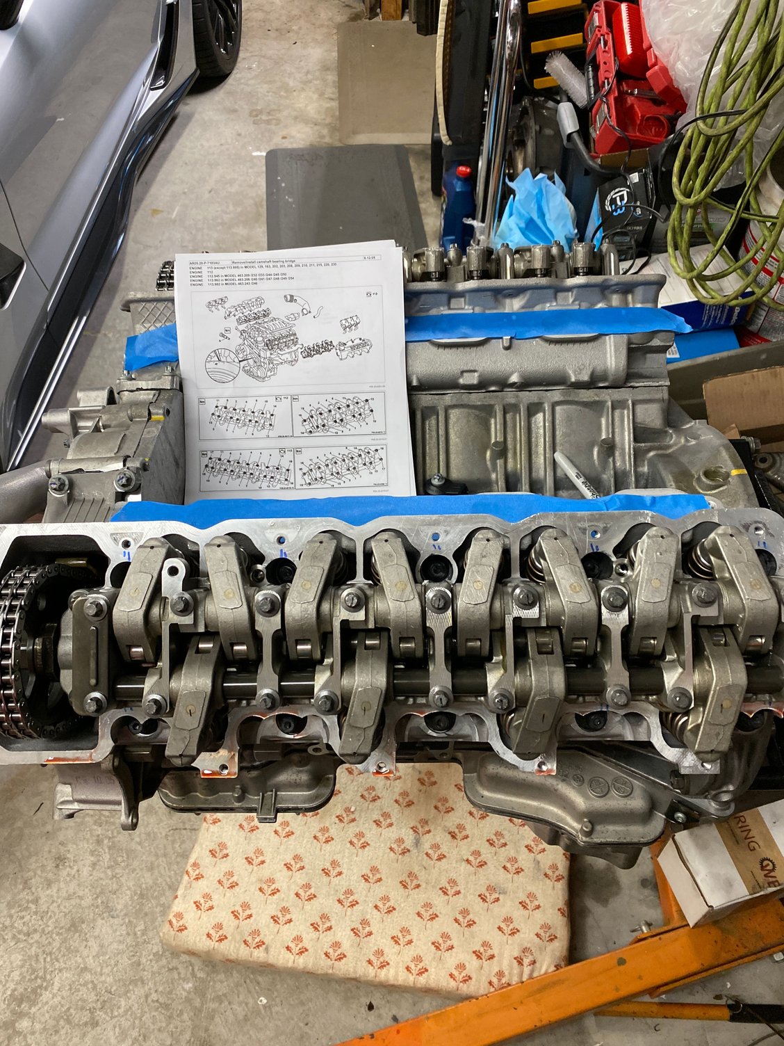

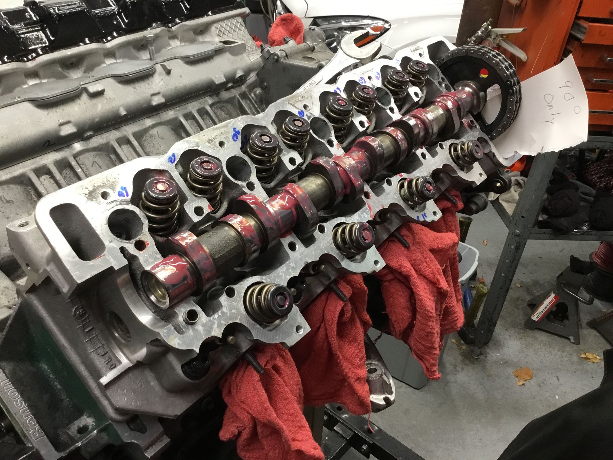

So the heads are on and fermenting over night lol. I torque them 25,50,to 60lbs,let them sit for the night, then next day loosen each stud to 50lbs then go to the final 85 lbs on one continuous swing of the torque wrench with the garage temperatures at 70 degrees. This has worked for years on any engine I built with up to 25lbs of boost so I stick to it.

LOL yea that's how I roll !! There are so many steps to this engine with bolt tightening and sequence that you can get lost real easy. Just the rocker arms alone are crazy with the torque,90 degrees the bolt order that every one has to be marked each time or you will get lost in it. And since these are all torque to yield there is no do overs !!! Bolts are crazy money now for sure !
see, now that you say that and it's been so long I can't remember specially doing it right back then but I can't even remember it at all other than in pics. So I have to trust I was thinking properly 7 years ago.

Actually 5 years ago. And I handily took a pic and it looks like I was reading from the directions:

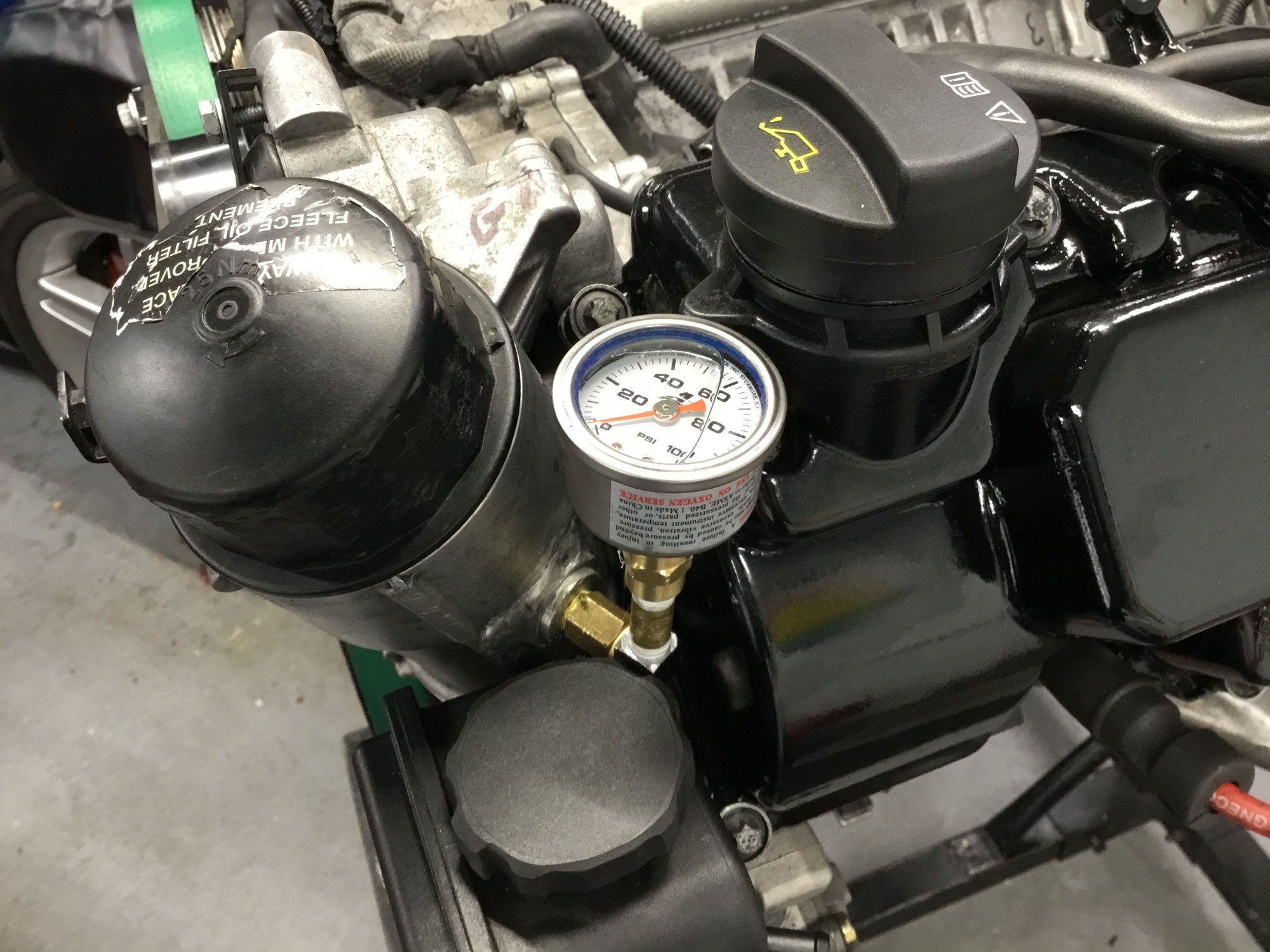

oli pressure gauge in place of the pressure sender for the interior dummy light. So at first start up I will know I have good pressure. Spun the engine over by installing and jumping the starter on the engine stand to prime the oil and it has 30 psi.

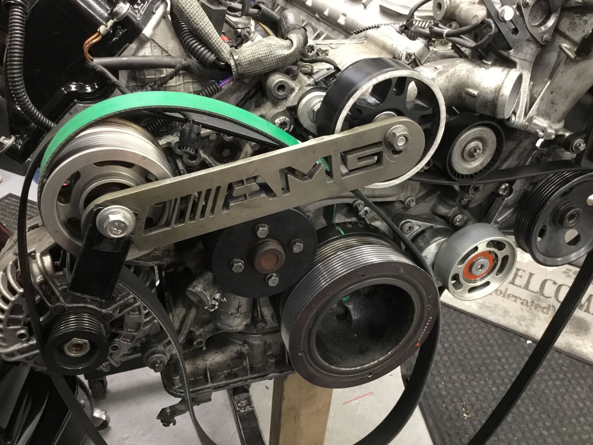

My belt wrap kit with an extra support and a 100 mm idler pulley. I also moved the idler up 1/2” to get the very most of wrap around the pulley. When I get the blower on you will see just how close the pulley is to the blower pulley.the bracket on the left off the cross brace gives it an extra anchor to keep things from moving.

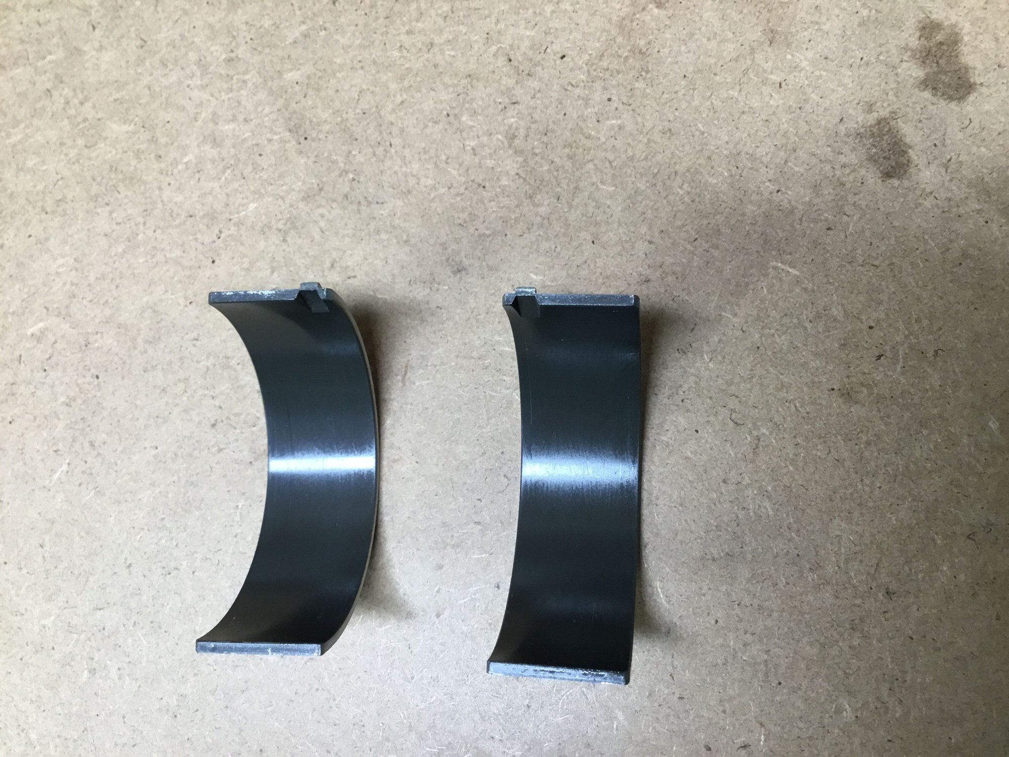

Forgot to show this earlier. This is what the rod bearings looked liked after 5,000 miles of severe nitrous and rpm abuse….literally brand new ! Swain Tech coatings rock for sure !! Wish the cylinder walls looked the same LOL
So what is normal oil pressure for these engines?
Was adding the oil pressure gauge pretty straight forward with the fittings?
And would it be the same as running an aftermarket gauge inside and by pass the factory gauge?
Where did you get the 100mm pulley? And how does it help? Just taking up more belt slack?
Yes I ask a lot of questions. lol.
Old Jan 5, 2025 | 08:03 AM
  #145
SICAMG's Avatar
Joined: Jul 2014
Posts: 3,324
Likes: 585
2005 e55 AMG
No problem with questions.
Oil pressure is around 100 psi cold and 10-15 at idle. around 65-70 when hot at higher rpm but I will check again when this rebuild is fired up.
There is no gauge in these cars.
I added the fitting on the side of the filter housing like this to keep things out of the way and not sticking out, but they sell an aluminum oil filter cover that is tapped for 1/8 npt thread to install a gauge if you wanted so very easy to do and they are around $35.00
Pulley came from UPR and the purpose was to get the belt wrapped around the pulley as much as possible.If you look at traditional belt wrap kits the idler pulley is way to low and gives very little wrap.This way with it raised up and a larger pulley is much better.When the blower is back on I will get a picture to show you.

LOL For sure you have to mark every bolt because you can not keep track of where you left off on the torque number or the last 90 degree turn.

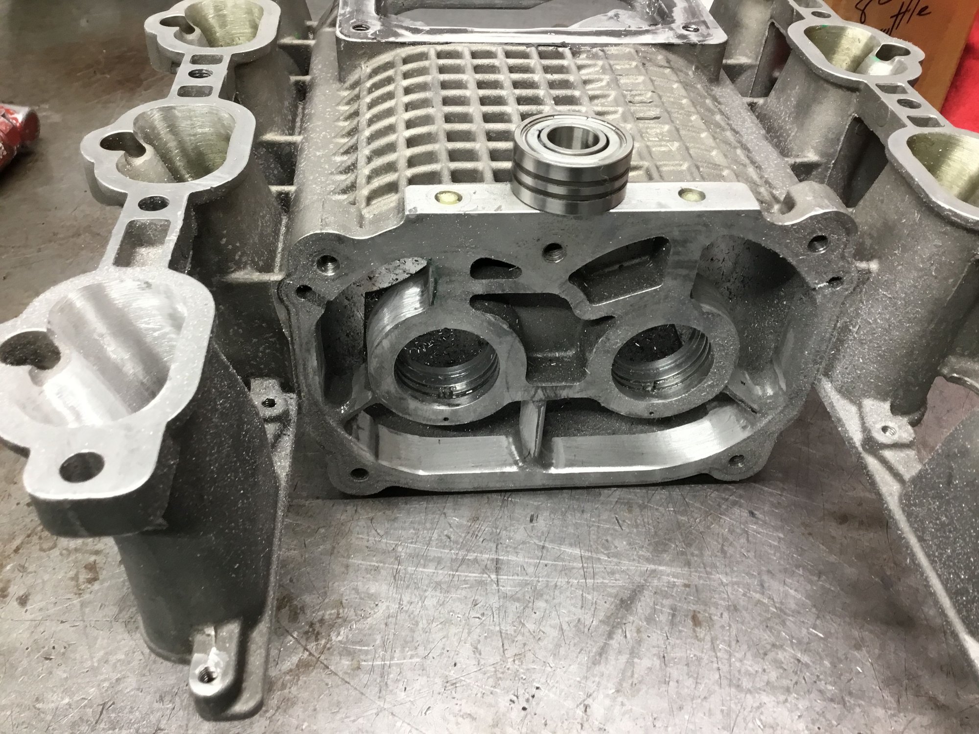

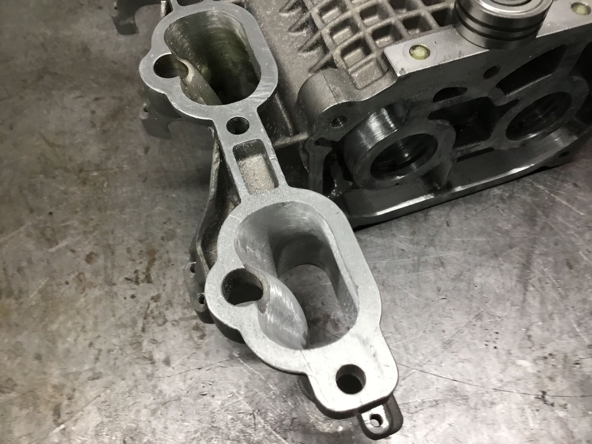

Decided that since the bearings in the blower case are original I should change them. Major pain in the *** to get them out for what ever reason. Normally they don’t fight so much but these did. Mercedes uses some crazy injected epoxy into the two holes you see left and right of the bearing sitting up top that requires constant heat to keep soft or it returns back to its hardness again. It’s a two monkey moment as we call it in the shop,you and a buddy,so they can keep the heat going. That stuff travels down around the bearing and holds it in place.
I also decided to really clean up the inlet section and port the runners out a little more since I have gone this far,figured it cant hurt.

Nice! The equivalent of a port and polish on the supercharger plumbing.
