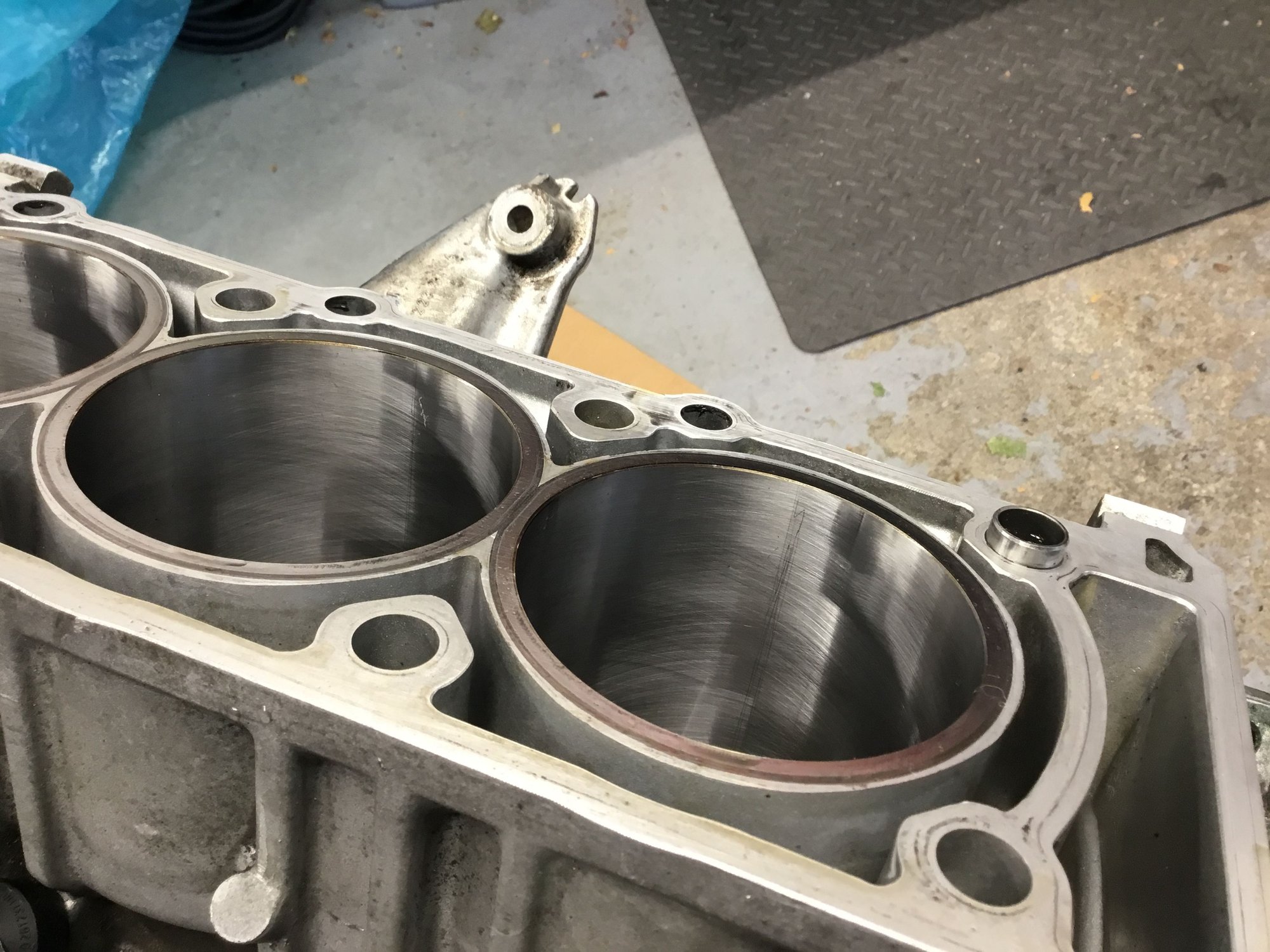

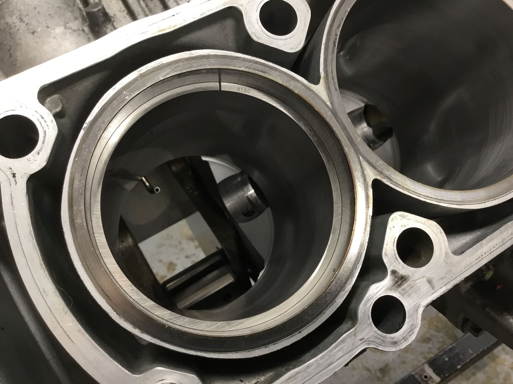

All back to normal. Took my machinist a little time but said bores are perfectly straight so real happy about that.
They cleaned up perfect ! The small scratch looking lines are just from the dial bore gauge.

Very good cross hatch there.
Love all the attention to detail.
You have great attention to detail, of the attention to detail.
I missed the cross hatching, until you mentioned it, even though I know a properly honed cylinder would have a clear cross hatch finish.
Keep honing that attention to detail.

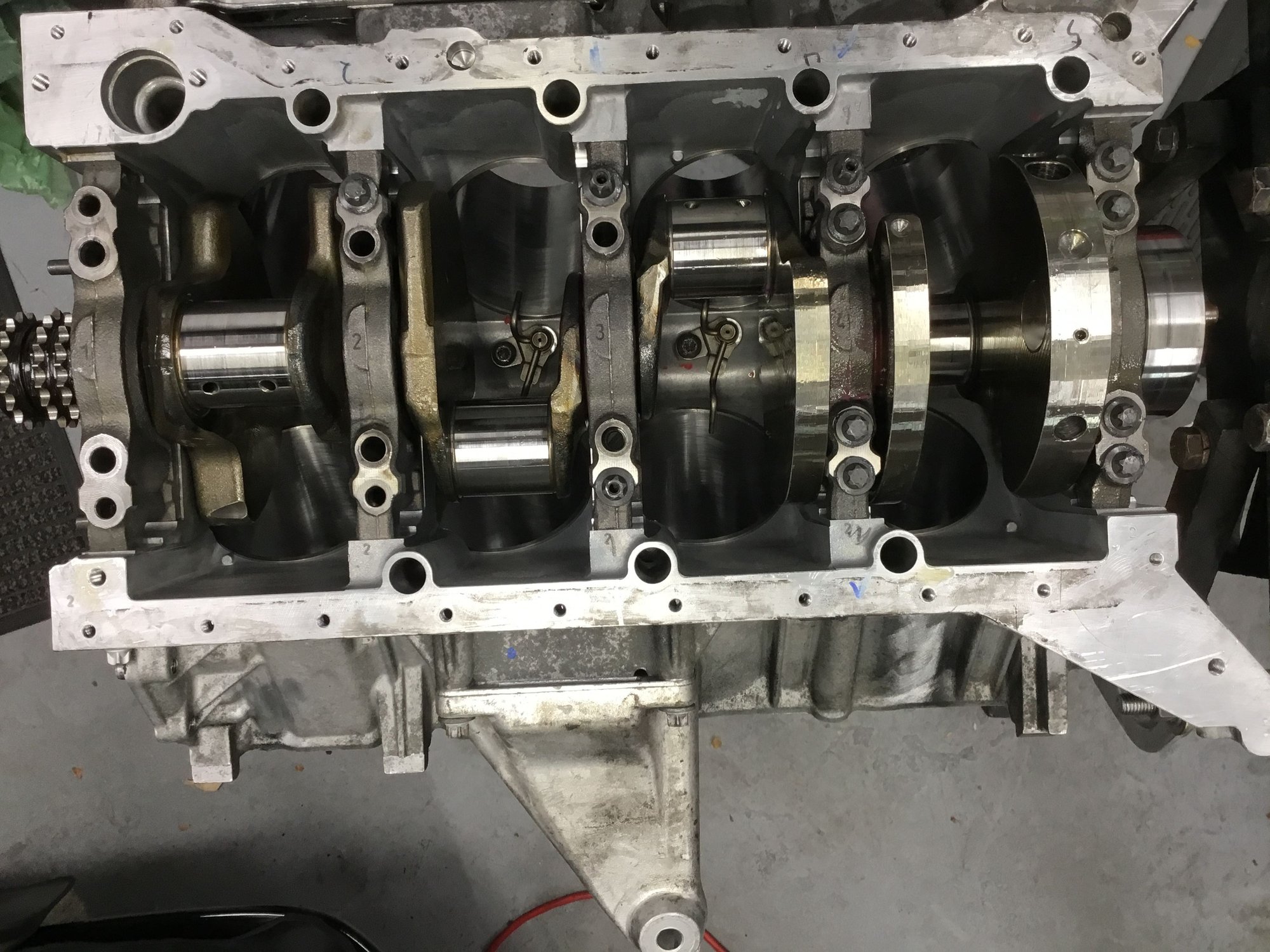

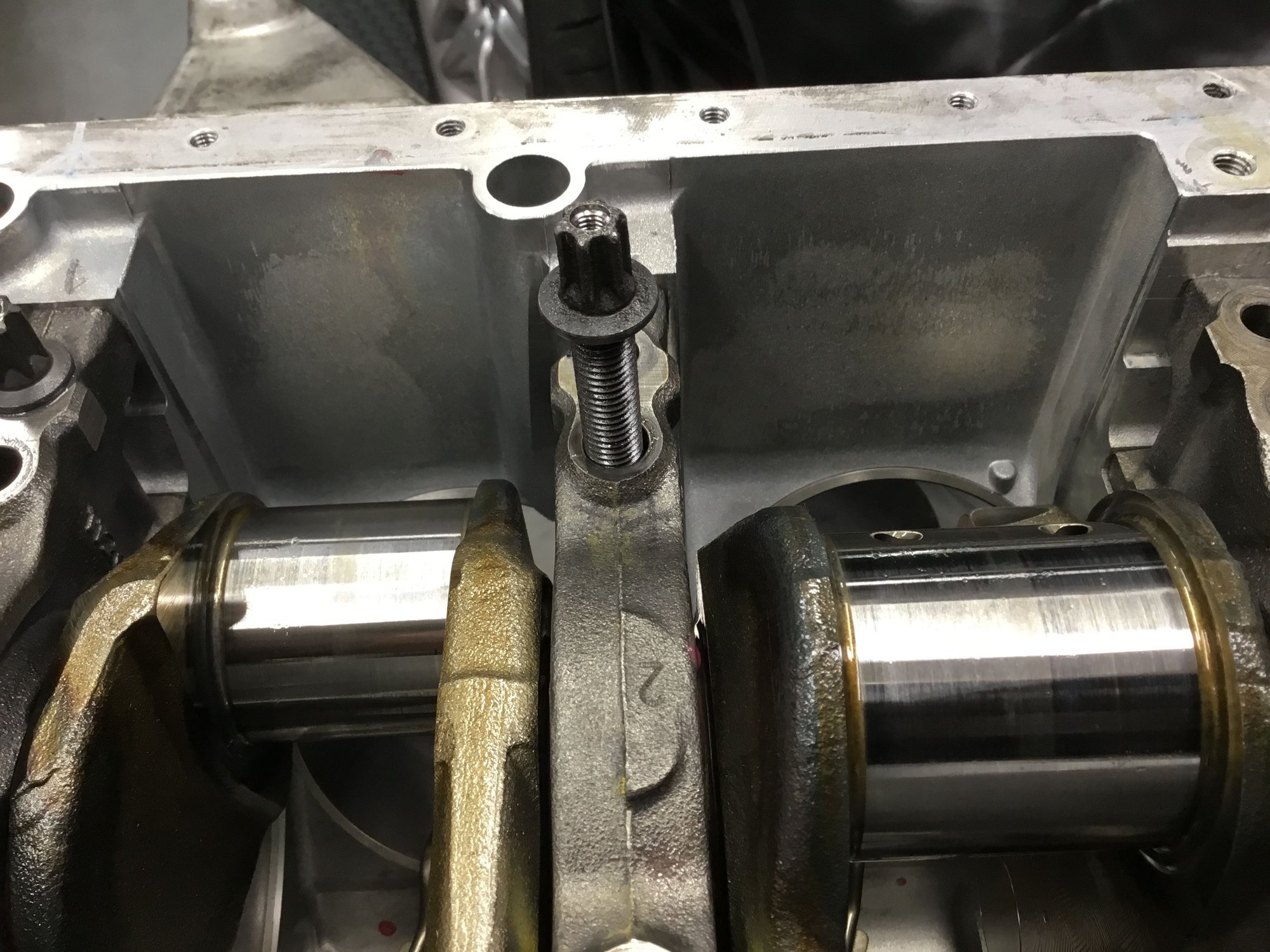

Crank going in but ran into snag with bolt one bolt. There is one of the oil pump bolts that the pump bolts to and is the larger 10 mm wide,they call it in the bolt discriptions stuff, cap bolt that I can’t seem to even get a part number for.
Strange that I don’t even remember this particular bolt lol and there is only one bolt this size as well. Can't even find it in a picture anywhere.

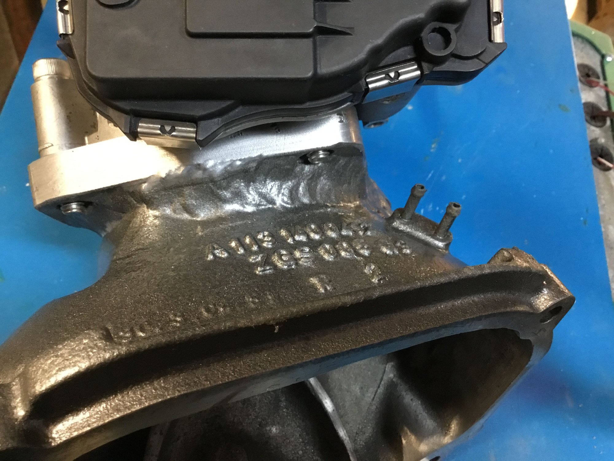

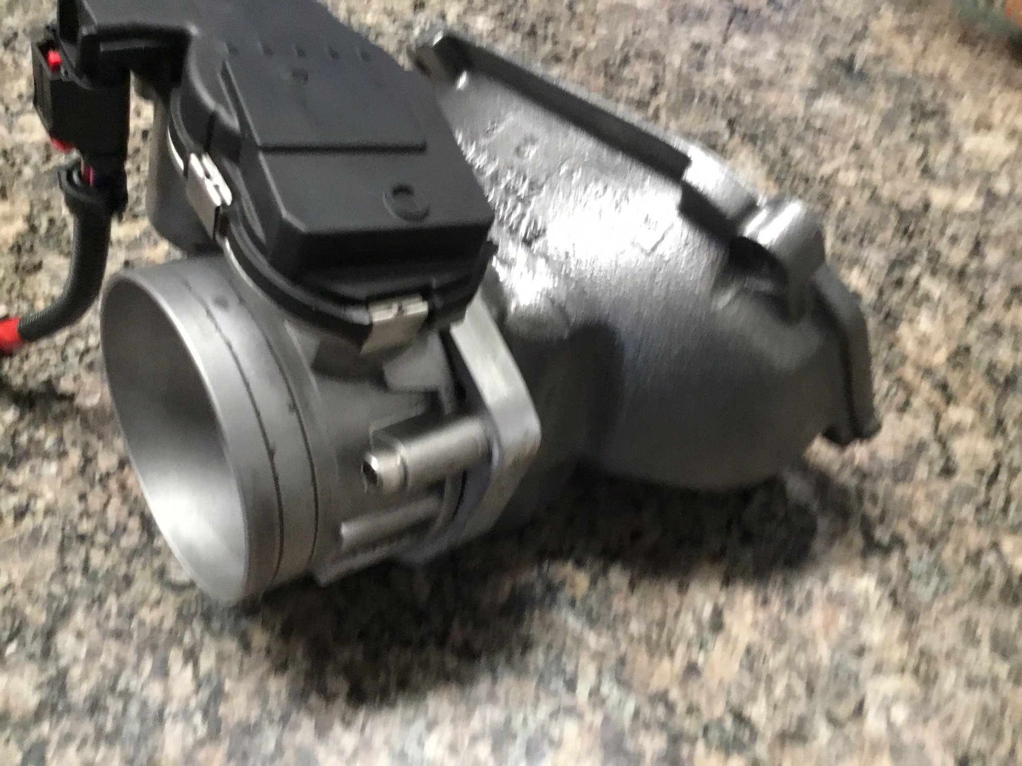

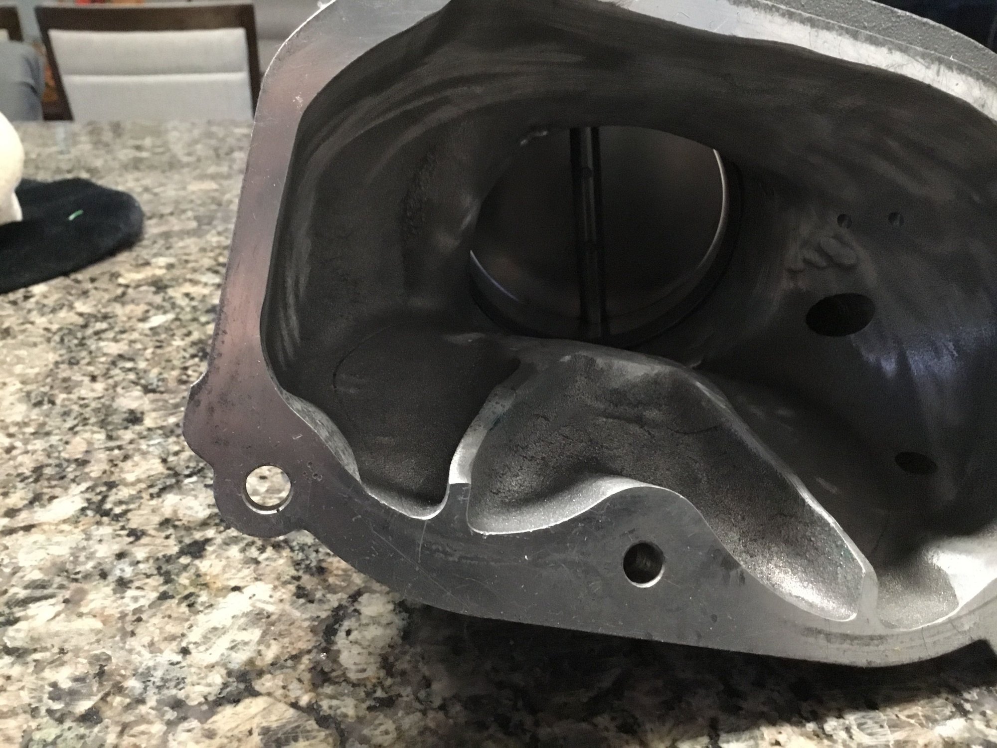

I decided to run a Hellcat throttle body but did not want the fire wall clearance issues so I cut the snout down very low and then welded the adapter plate on. Then hogged everything out including internal blockages in the snout.I also made an adapter to put my 82 or74 throttle back on in case I have a drivability issue and then I would not have to pull the blower off every time. Hopefully she will run fine like every one else’s.

All back together.The plate sitting on top will be my adapter plate I am working on to go back to a stock throttle body in the event there is some sort of drivability issue, then I will not have to pull the blower off to do the swap.
Not a pretty set up but at least I can get my intake tube right back in the stock location.
It was more work than I thought and had to weld a lot of extra material in order to grind the inlet hole bigger to match the gasket since I was breaking through every where on the snout. Still not as big as I wanted but big difference from where it was.

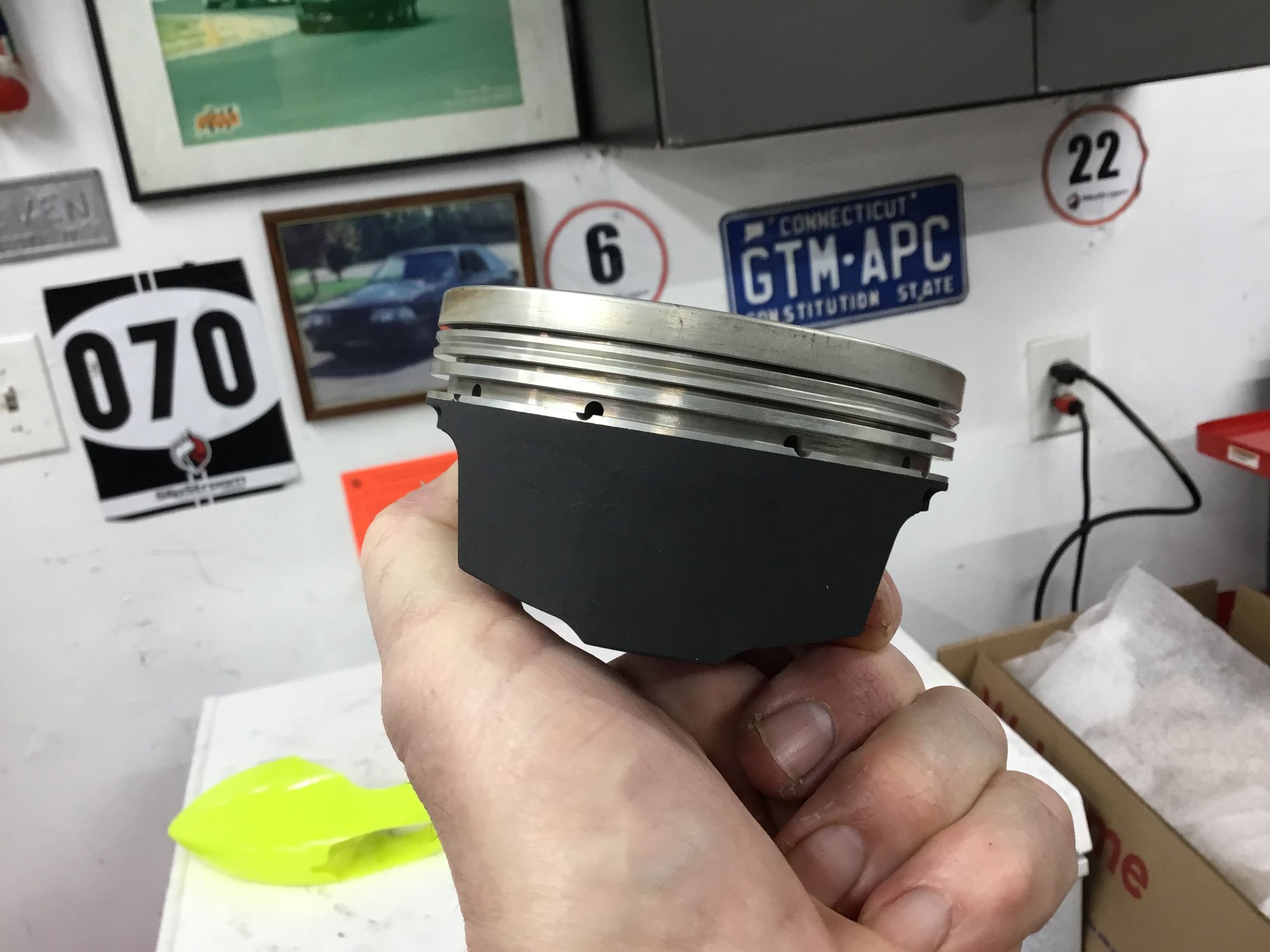

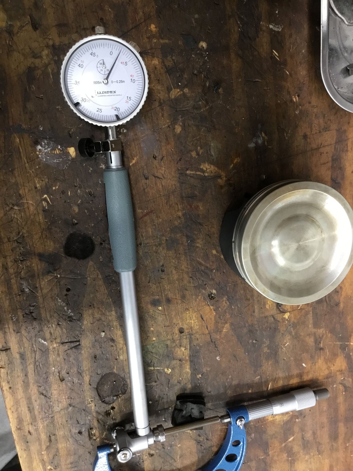

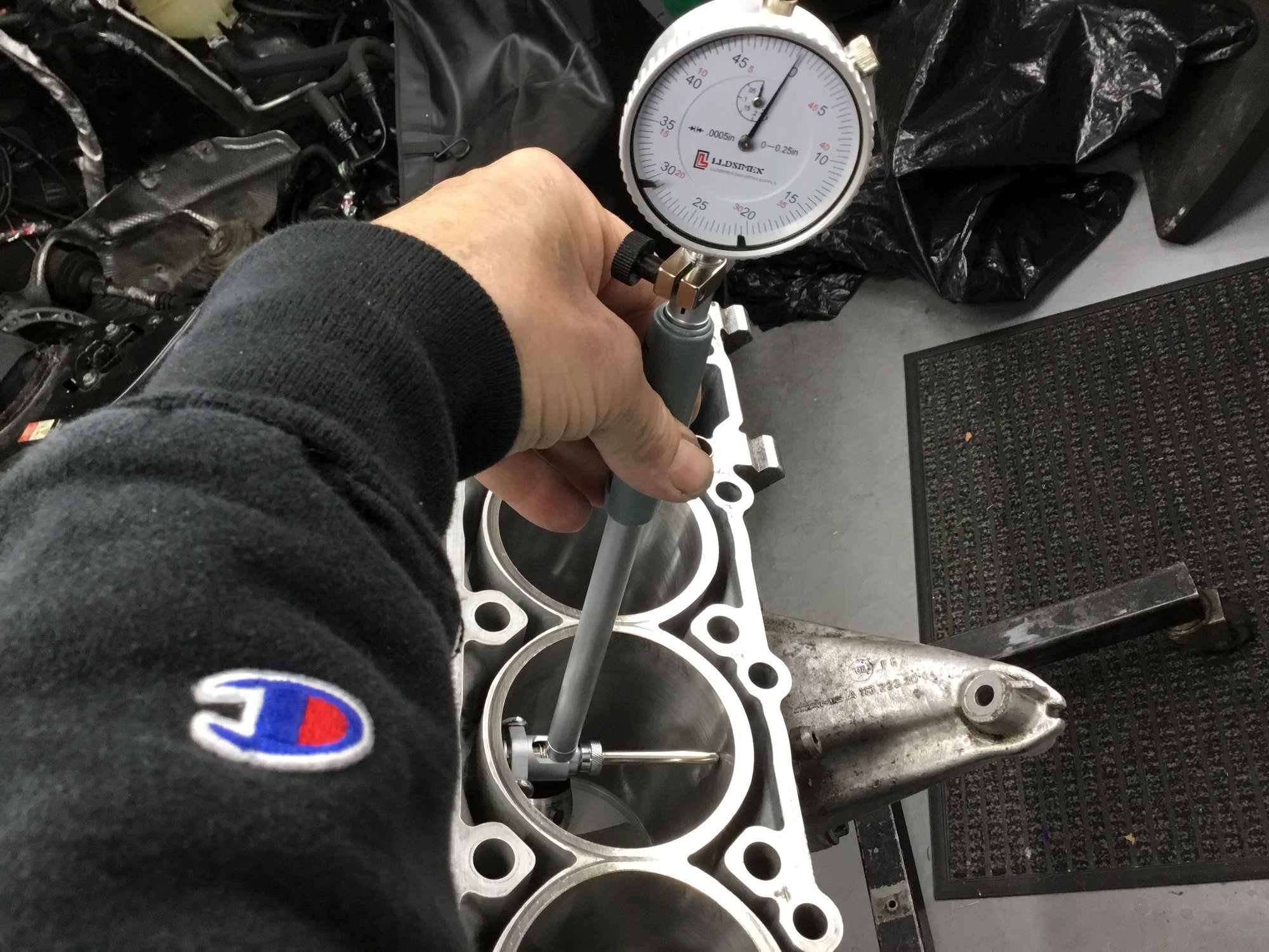

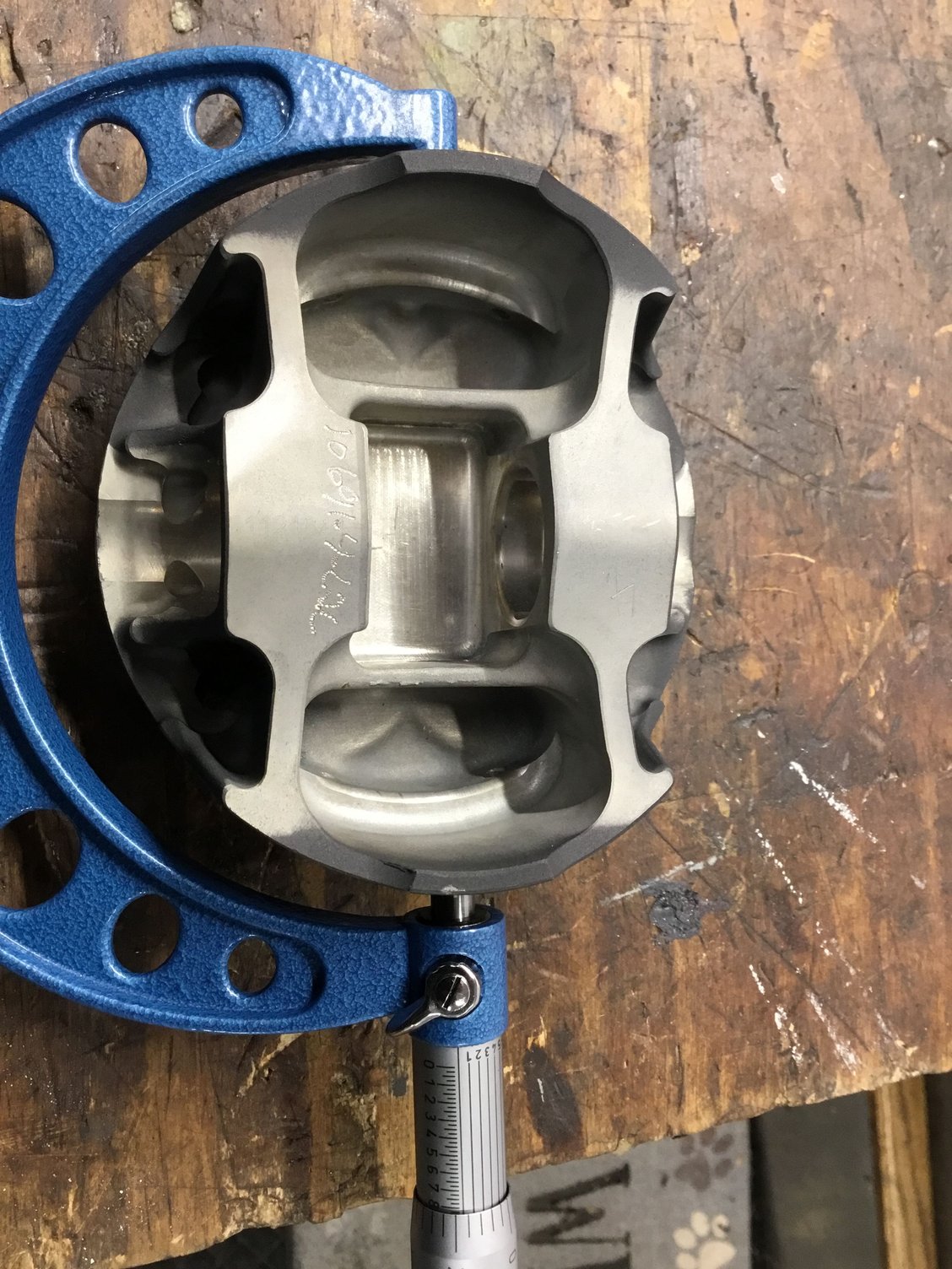

Ok so pistons are back and all is well in Gary land lol !!
Top picture I am measuring the bore, you want to set the gauge to zero,than measure the piston,then take the caliper and measure the bore gauge and that reading on the gauge is now my piston to wall clearance….perfect at around 4 thousands. Much better than the 7 I had.
Pictures are out of order but you get the jest of it.

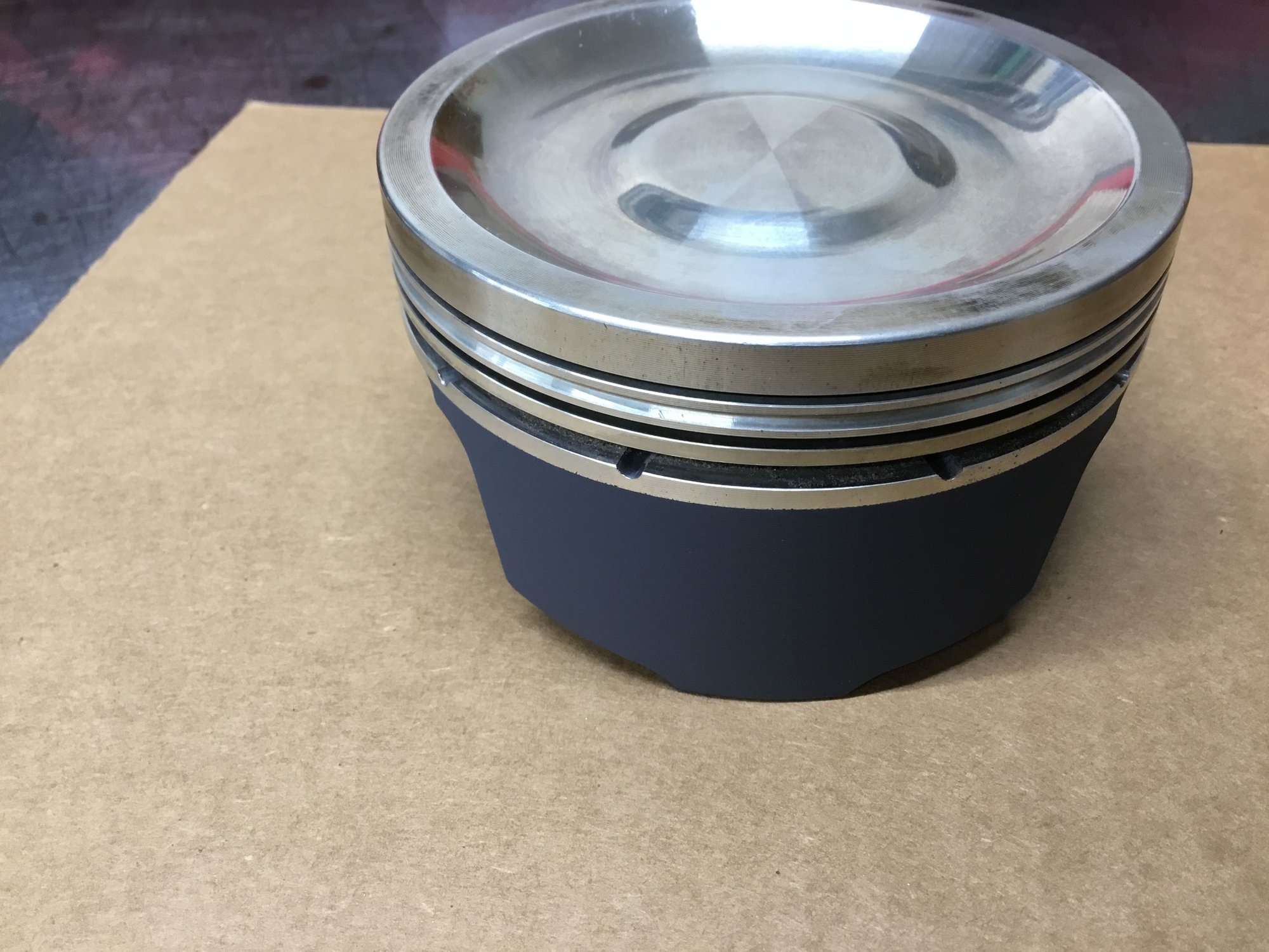

Coated piston with 3 thousands added to skirts.

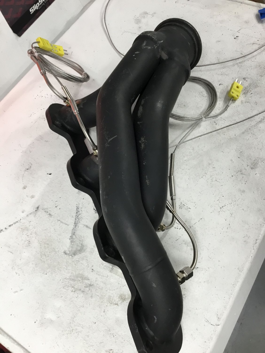

Making headway with EGT set up. Bungs are in and welded so now I just have to get them coated by either Jet hot or Bonehead Performance.The company that did them a couple years ago did a sheety job,redid them and still is flaking off. I have used Jet Hot but even those over years of use start to look chalky and dull over years of use.

Have you tried Cerakote on them. Redline Rebuild on Hagertys YouTube channel had this company do some parts for them.
https://www.westmicerakote.com
https://www.westmicerakote.com/post/...ebuild-project
I was thinking about having them do some headers for me.
Old Dec 23, 2024 | 05:55 PM
  #125
SICAMG's Avatar
Joined: Jul 2014
Posts: 3,327
Likes: 586
2005 e55 AMG
Hey man....
That is what is on there right now and it comes right off after a while,few months, so the prep work must be wrong or the coating is no good for the heat.
