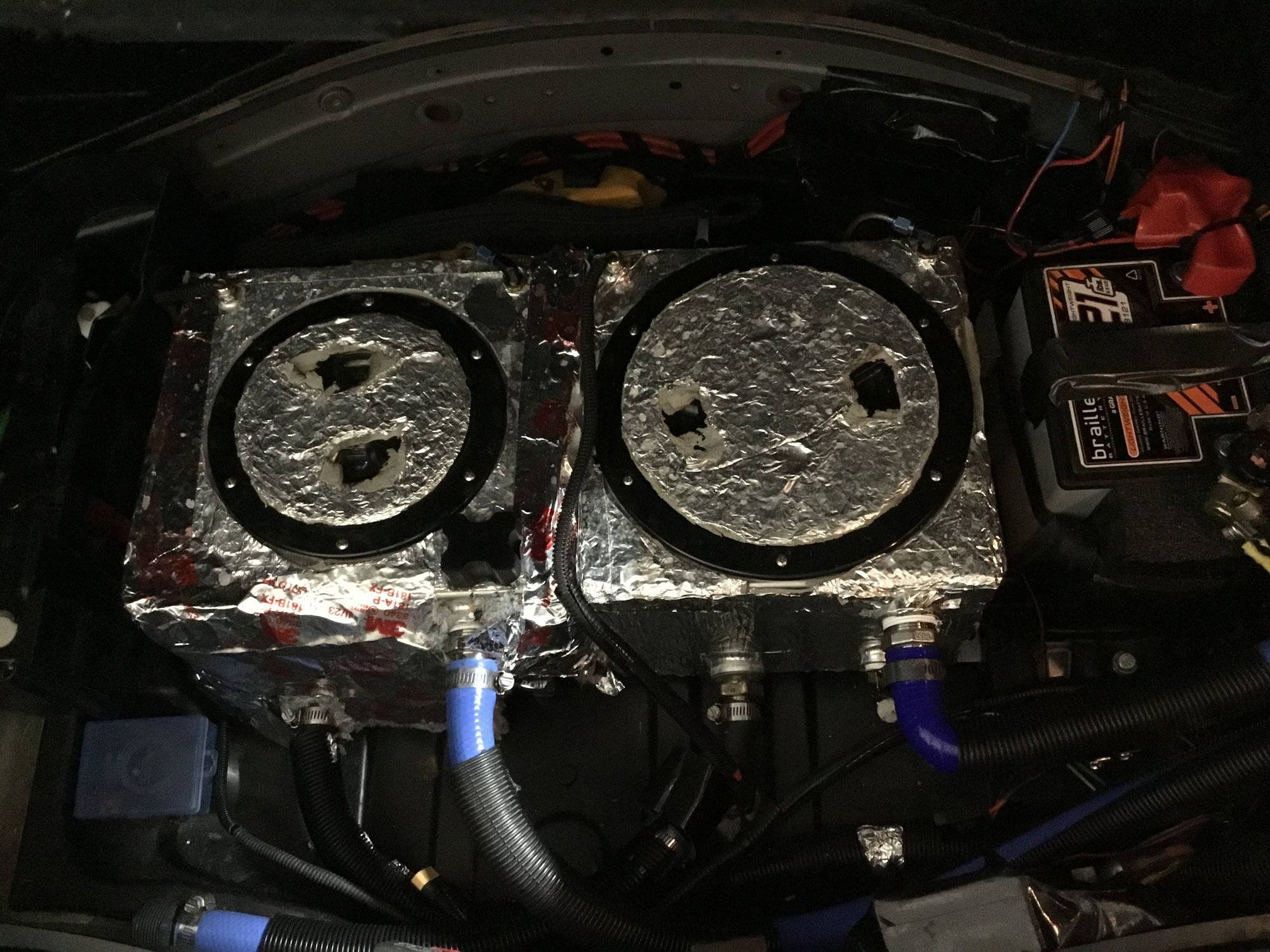

This is my supercharger cooling system. I run a Stewart pump up front and 7/8” lines in the whole system,two front mount coolers that are Heat Dispersement coated by Swain coatings, the single pass mod to supercharger cooler with two inlet and two outlets, two rear 3 gallon tanks with pumps inside each one. The right tank is the return tank from the supercharger and that takes in all the hot water from the charger. That then gets pumped into the other tank on left side and cools everything down to ice water numbers and returns back to supercharger. I thought it made no sense to return hot water to one tank,try and cool it off and then send it back up front. Why not have a two tank system and cool that very hot water down before it gets to the second ice tank. So after a run the first tank is completely melted of ice and the second tank still has ice in it so it definitely works well for me. Tanks are all wrapped up and the ice will stay for an hour or so before lane calls with no melting.
On a side note it appears that even with the bigger throttle body and port work the supercharger just can not keep up with the engine in high rpms. I will lose 2lb's or less from say 4,500 to 6,500rpm where I run it. Of course lower rpm ,say 3,500 I can spike it to 16.5lbs but just starts dropping as rpm climbs. Only solution is remove the stock intercooler that I believe is the only cork in the system and go with top mounts...really don't want or go Weistec....Blaa....
This has been, along with endless belt slip, an ongoing problem for 3 years now with no solution for it that has been done. The new Dura belt was for sure an improvement but not a cure all.

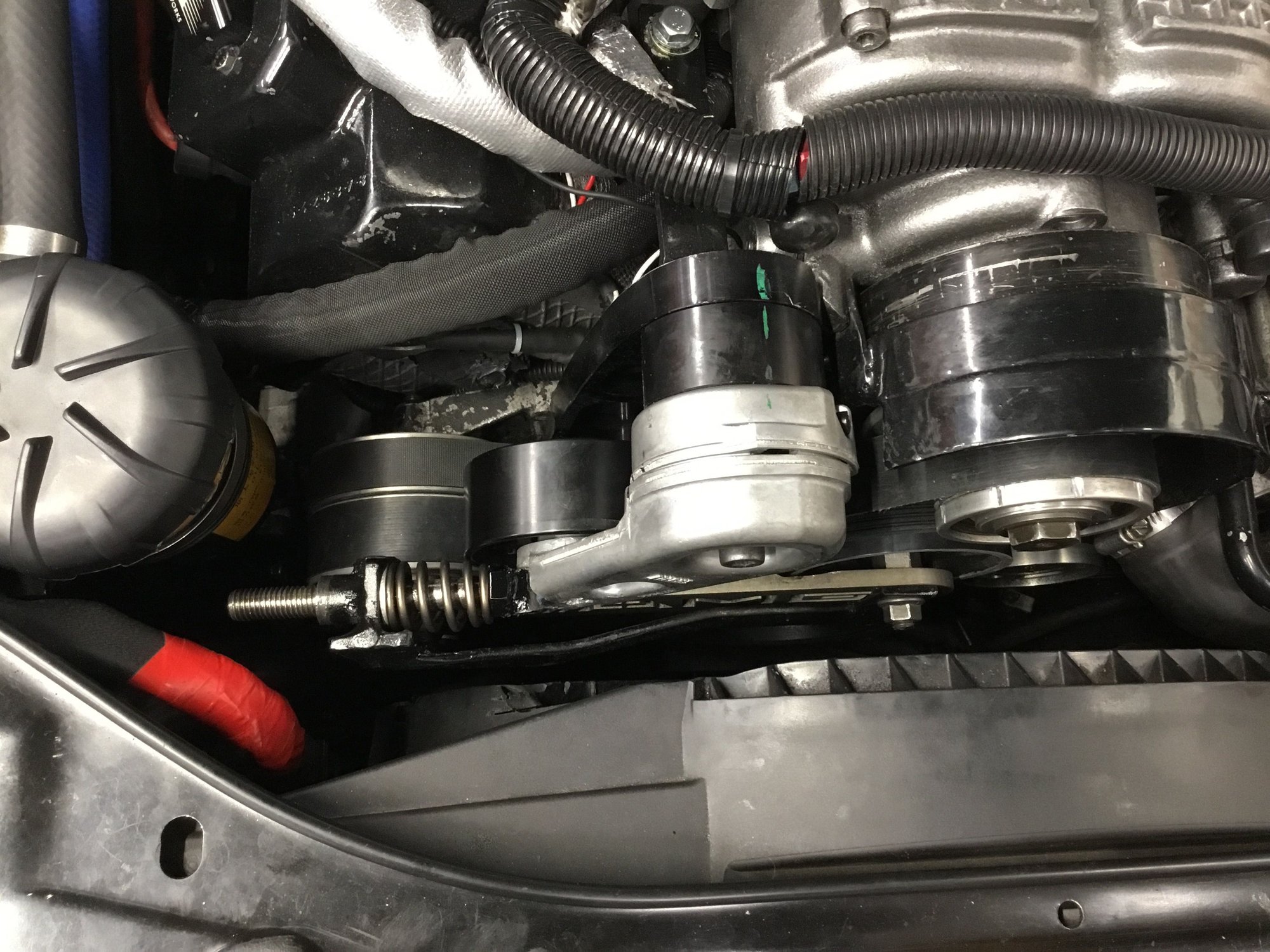

So after dealing with belt slip for 3 years now I went out on a limb and tried something that I had on my stock tensioner a while back.
I have tried carbonate pulleys ,Grip tech pulley,custom 'belt wrap kit, VRP tensioner kit and even the 50 lb. Billet tensioner that was a disaster. It would literally smoke the belts from having the tension so tight ! So I came up with this that was a royal pain to get right but will keep tensioner from bouncing and will have a little more pressure. I will make some runs tomorrow and see how its does.
I believe that with the 3.06 gears,10 lb lighter torque converter and 90 gram lighter per piston assembly that the engine comes up so fast now that the belt just can’t hold it.. The factory intercooler doesn’t help either and is backing boost up and “stalling” the rotors in the blower so to speak.

Yeah, that blower should have its own dedicated belt. I don’t know how you would find room for it though.

If I am interpreting your belt routing correctly, you have your serpentine also running your supercharger. If you took the supercharger off the serpentine, you would reduce any slippage, but you would need to put the supercharger on it’s own belt connected directly to the crankshaft.

All M113K engines use a separate belt to to drive the supercharger. The regular drive belt for accessory's is 6 rib and the supercharger is 8 rib.

Okay, I see. I was wrong about the design of the engine, regarding the placement and routing of the serpentine belts. So, the slipping is isolated to the supercharger belt?

Correct.But I got a lot of it under control with the helper spring so happy about that. Just have to put it on the Dyno and see what she doe's.

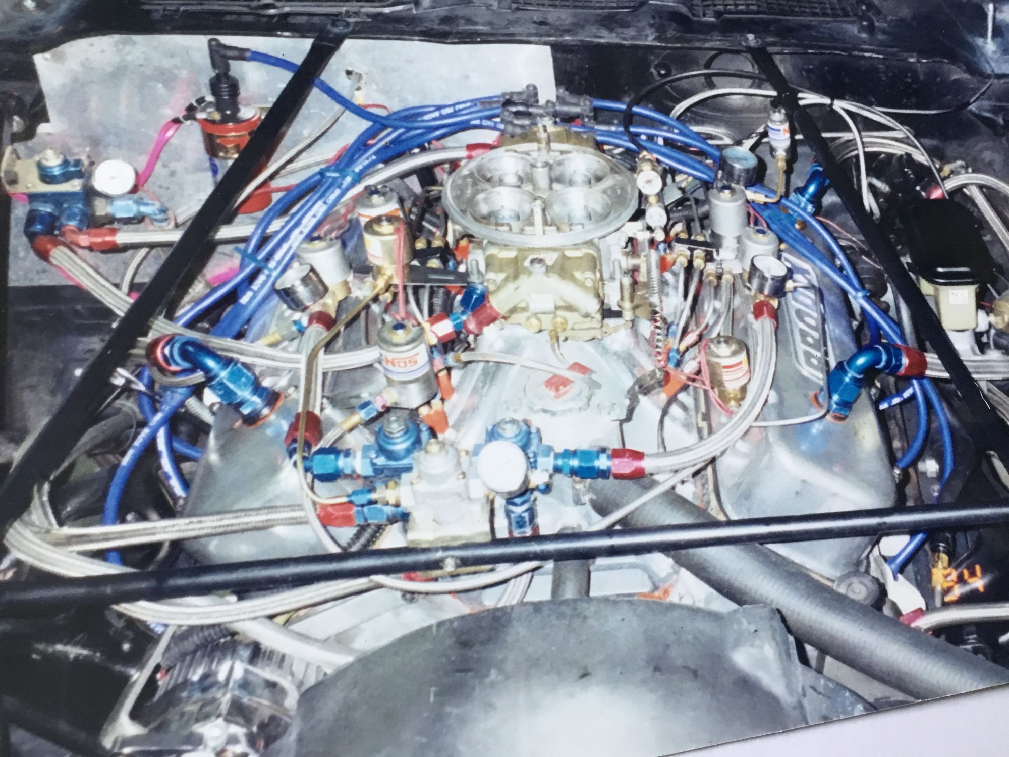

I would like to do a Buick Grand National,1987, I had three of them way back. Do a Big Block Chevy,twin turbo and around 1,200-1,500 hp.
big tires ,full suspension and set up for roll and top end. Would run a 4l80 e transmission. Love the big block stuff. Here is one of my past engines in my street car. I really loved my nitrous !! Lol Three stages 100 + 150 + 200 for a total hit of 450. Had 2 bottles in the car and 4 more in stock for a constant rotation on the weekends. Spun that engine to 8,500 rpm with aluminum rods and light weight crank and broke valve train parts like I was changing under ware but was very easy to work on !!
Good times back then for sure.......

Im not sure if I posted this before but I have an S10 with a BB 454. Although nothing like what you had. Mostly stock so I could drive it on the street.
