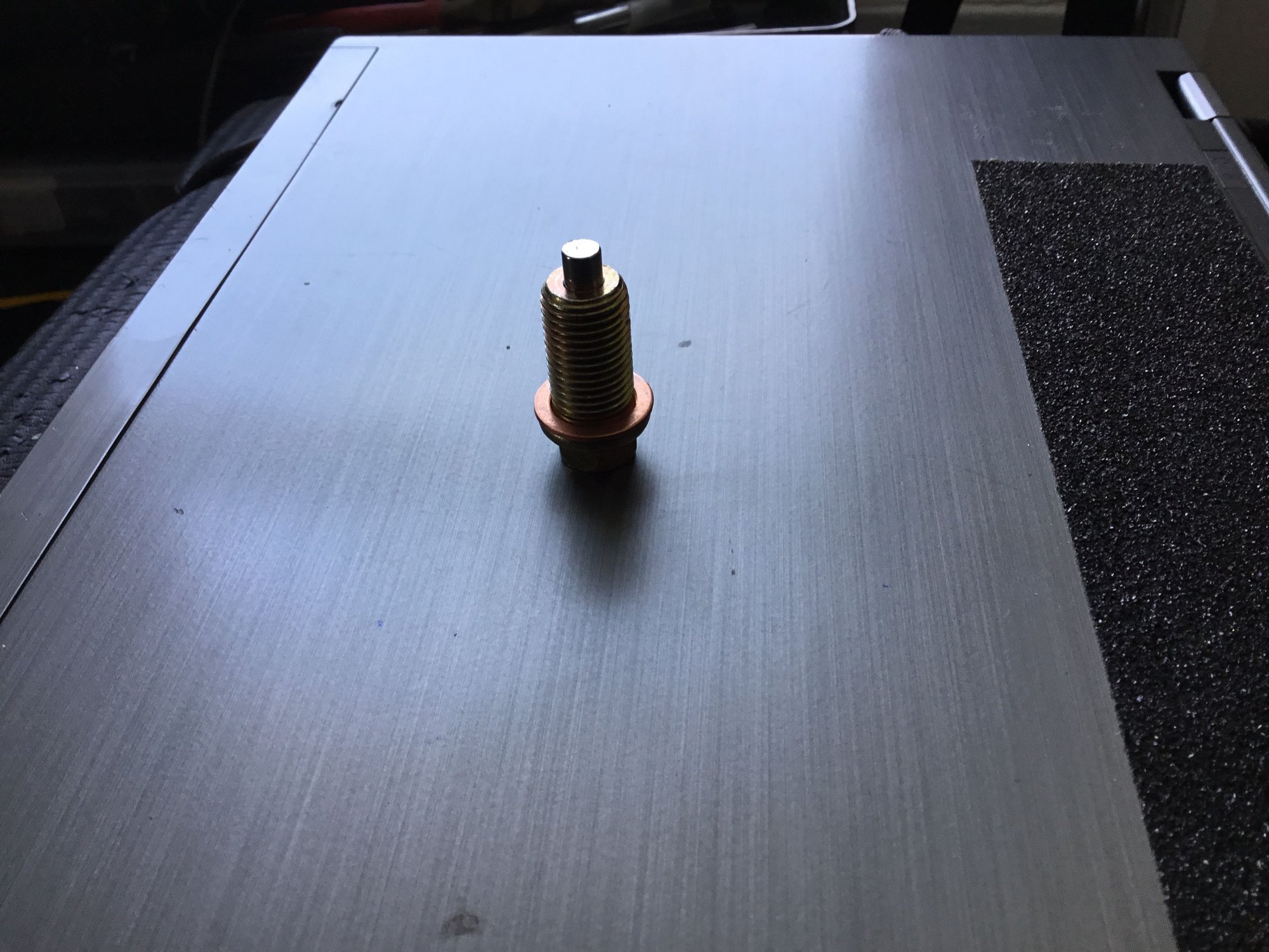

Magnetic drain plugs that I got off EBay. Cheap insurance for any metal particles floating around.

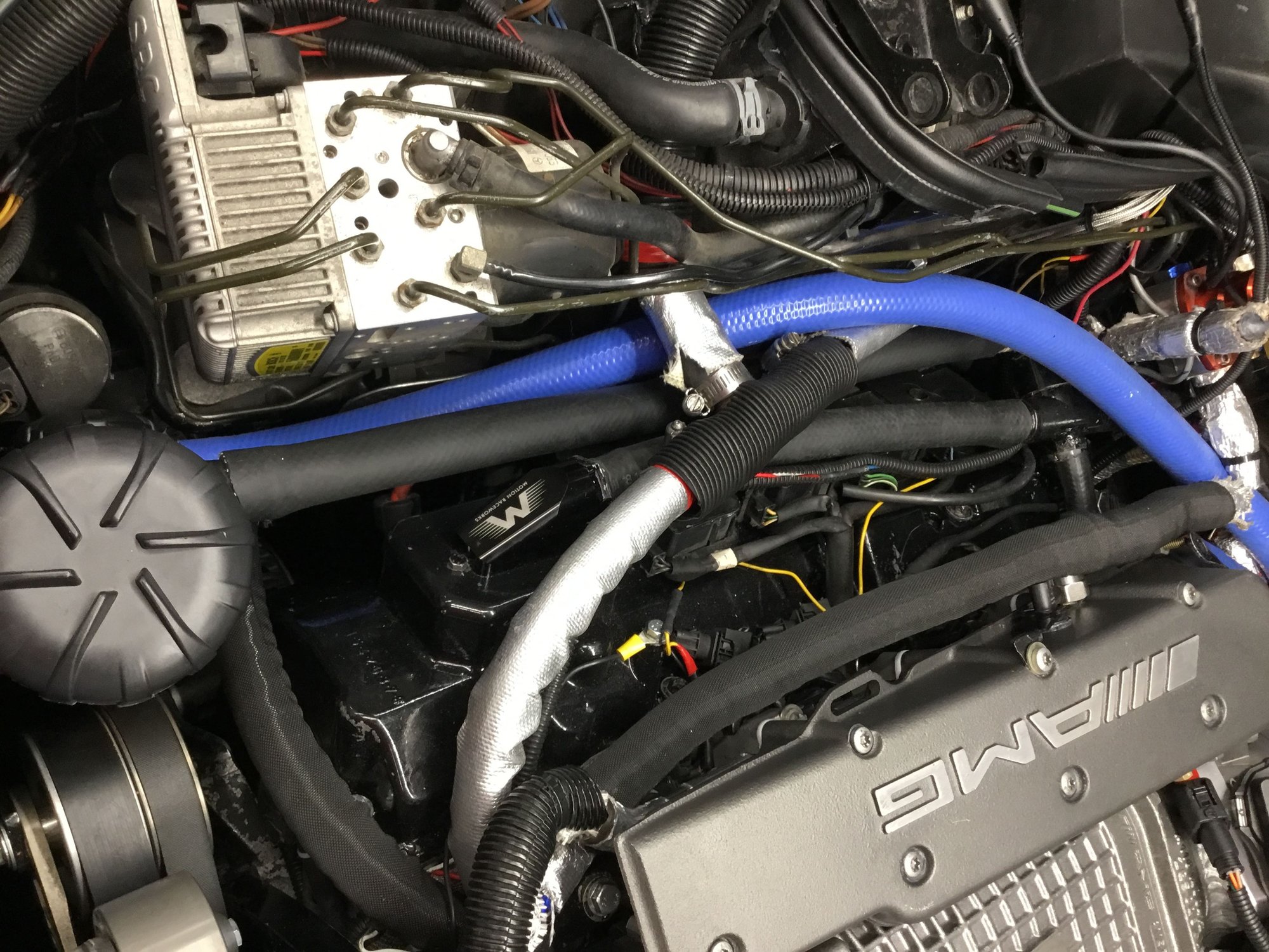

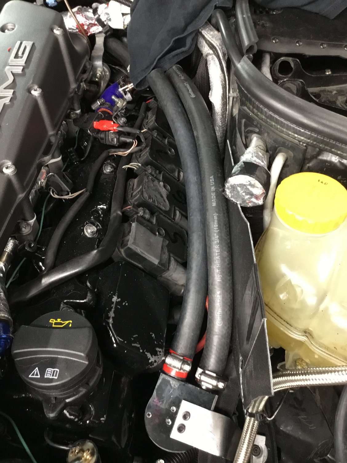

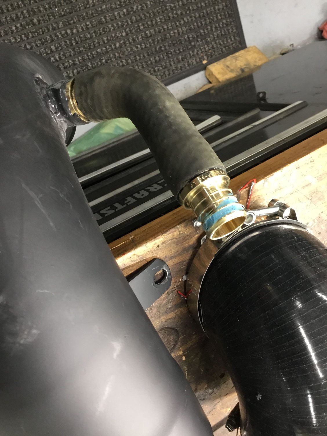

Oil Catch Can/Evac Set up. Air is pulled from valve covers into catch can then into intake tube. 3/4" fitting is cut on a 90 degree angle and also angled into the pipe. Far more elaborate than factory plus the Hellcat throttle body has no provision for vacuum like factory. This system has worked well for years for me and it’s amazing how much water and oil end up in the can. I just have to make better /permanent connections and she's good.
I have one, Catch Can, on my Expedition as well and same thing and have to empty it out every couple months.
Nice. Do you have a link to that magnetic plug?

Off Ebay a while ago but it is a M14-1.5 magnetic oil drain plug.

Have you seen any leakage around the magnetic drain plug? What torque setting do you use to tighten it? I am probably not telling you anything new, but it is very easy to over torque a drain plug. Typically snugging the plug, and then adding no more than 1/4 turn is more than sufficient.

No leakage. Torque setting is "Tight" LOL

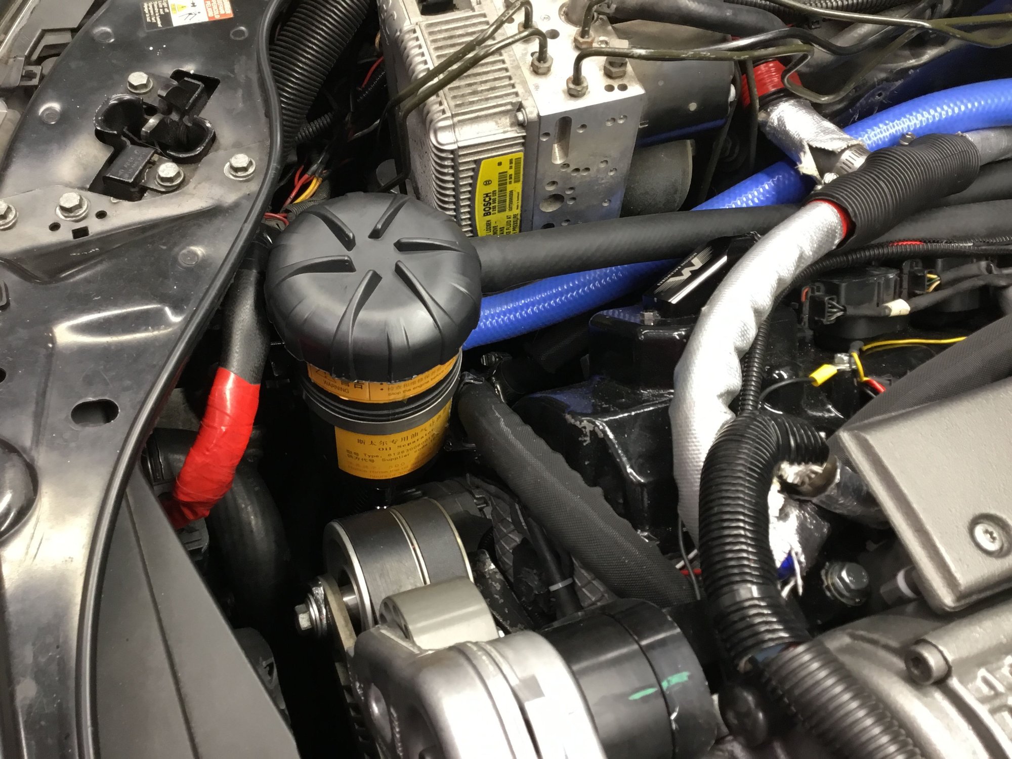

Finished up a new catch can set up. Decided to use a diesel Pro Vent 200 with the stainless filter. The hoses where a royal pain in the *** since they are 7/8” but this set up is far better at pulling any blow by that will head out the valve covers. I am pulling from three different places from the engine.
Also trying a new blower belt from a company called D&D Dura and is much different than the Gates. The groves are wider and deeper so I am hoping this is going to help being deeper into the pulley grooves for more bite.
Hoping to do a few hard runs and data logs tomorrow and get some good info to see where everything is at ,especially boost.
Rings should also be pretty well sealed up by now I hope.
