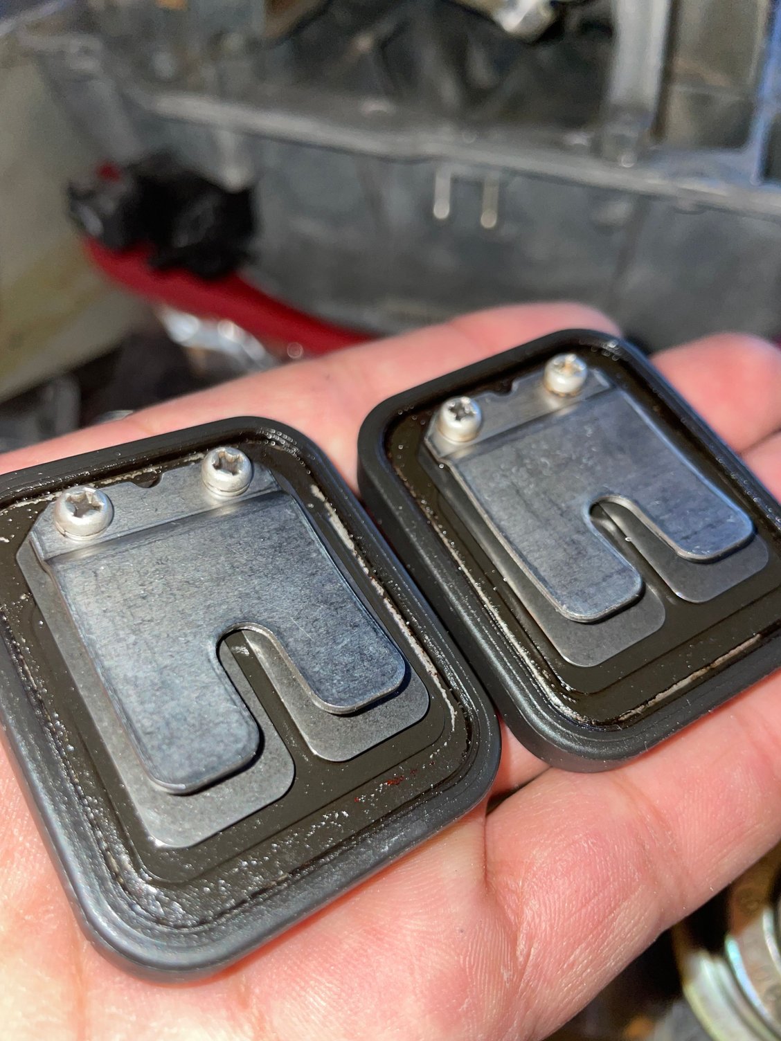

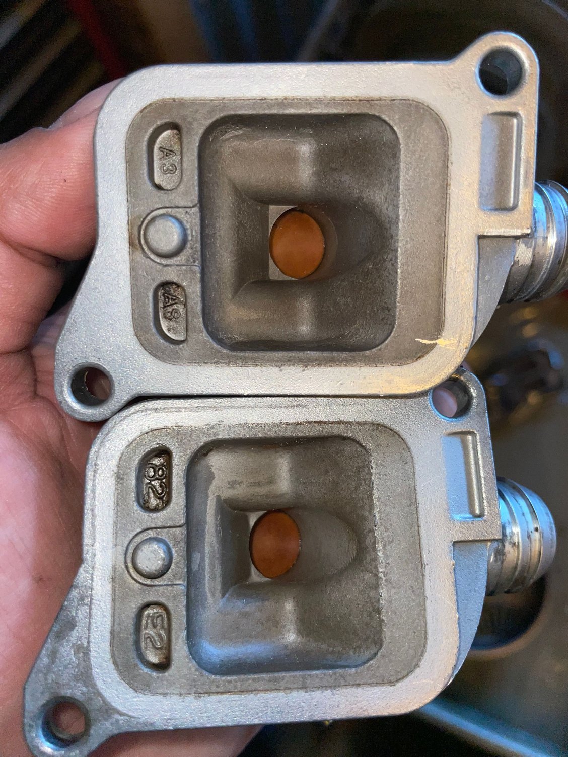

M113 SAI pump check valve cleaning
I’m in the middle of an m113 rebuild . Through out the process I’ve been doing lots of soda blasting to remove carbon build up everywhere i find it . I didn’t bother to get before shots but here are the results. I’m very pleased . I took extra time to make sure the reed valve was super clean because it was caked with lawyer of reddish brown carbon that was pesky to remove with the baking even after a soak in diesel fuel . See my YouTube channel for more content @TheLongRanger55
Reply 1
