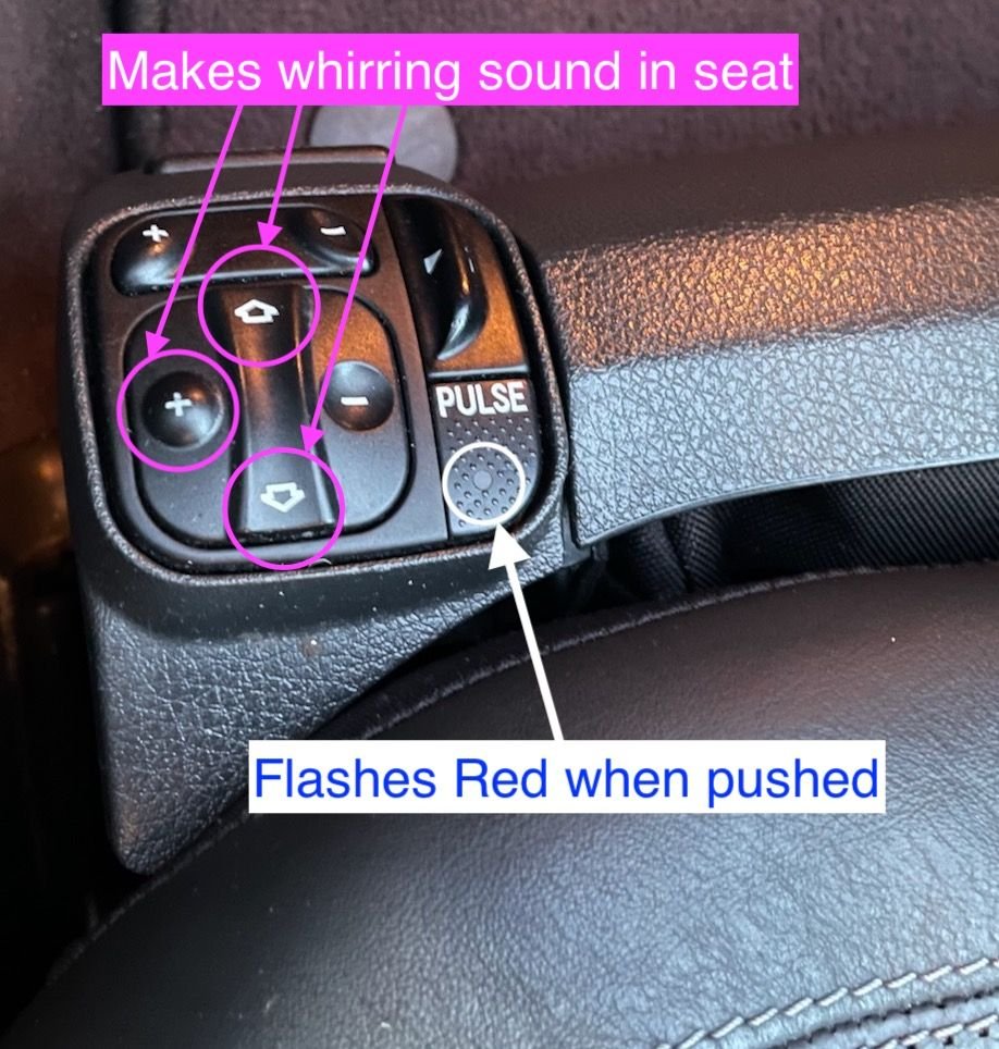

Update:
  • The whirring sounds comes on soon after starting the car and at random times during a drive.
  • The whirring occurs when the HVAC is off.
  • The sound seems to be coming from either under the passenger seat or low in the back of it.
  • The sound is not coming from the glove box area.
  • I am able to make the same (or very similar) sound when I manipulate the Up, Down, and "+" buttons indicated in the photo below. The "-" has no sound, nor do the other buttons.
  • When I press "PULSE", the red light flashes a few times then stops.
  • Once when driving, the sound came on again. It usually lasts maybe 2 minutes, but when it started, I immediately pressed the "+" button and the sound stopped.
My guess is that it's related to whatever motor or fan those buttons activate.
Does this help with the diagnosis?

The buttons on the seat activate the air pump (located in the truck left side) to fill the various air bladders in the seat or deflate the bladders. The Pulse function simply fills and empties bladders in a rotation pattern to create a massage type of effect. There is is no fan as part of that system. The only fan with the seat is for the ventilation function. The fan only moves air through the seat for evaportive cooling. I would suggest remove the back cover on the seat and see if that will help you locate the source of the sound. To help to locate the sound it may help to use a section of heater hose with one end at your ear and the other end moved slowly around ithe are the sound is comong from. The hose will help pinpoint the source of the noise.
Maybe it's a servomotor and not a fan? Could there be a motor in there trying to adjust the bolsters or move the lumbar support up/down?
I'll see if I can remove the seat back tomorrow and see what's up.
OK. I get what you are saying now.
I just tested a few things.
  1. The dynamic seat button won't activate if someone isn't sitting in the passenger seat.
  2. I did hear and feel the driver seat lumbar support inflate and then nothing more. Maybe the pump detected an issue and quit?
  3. When the driver's seat was inflating, it made the whirring sound. So, it was air that I was hearing, not a motor.
  4. It all makes sense now.
With that being said, I wouldn't be surprised if my seat bladders and hoses needed a complete overhaul. Whelp...I'll add it to the list of stuff I gotta do...
