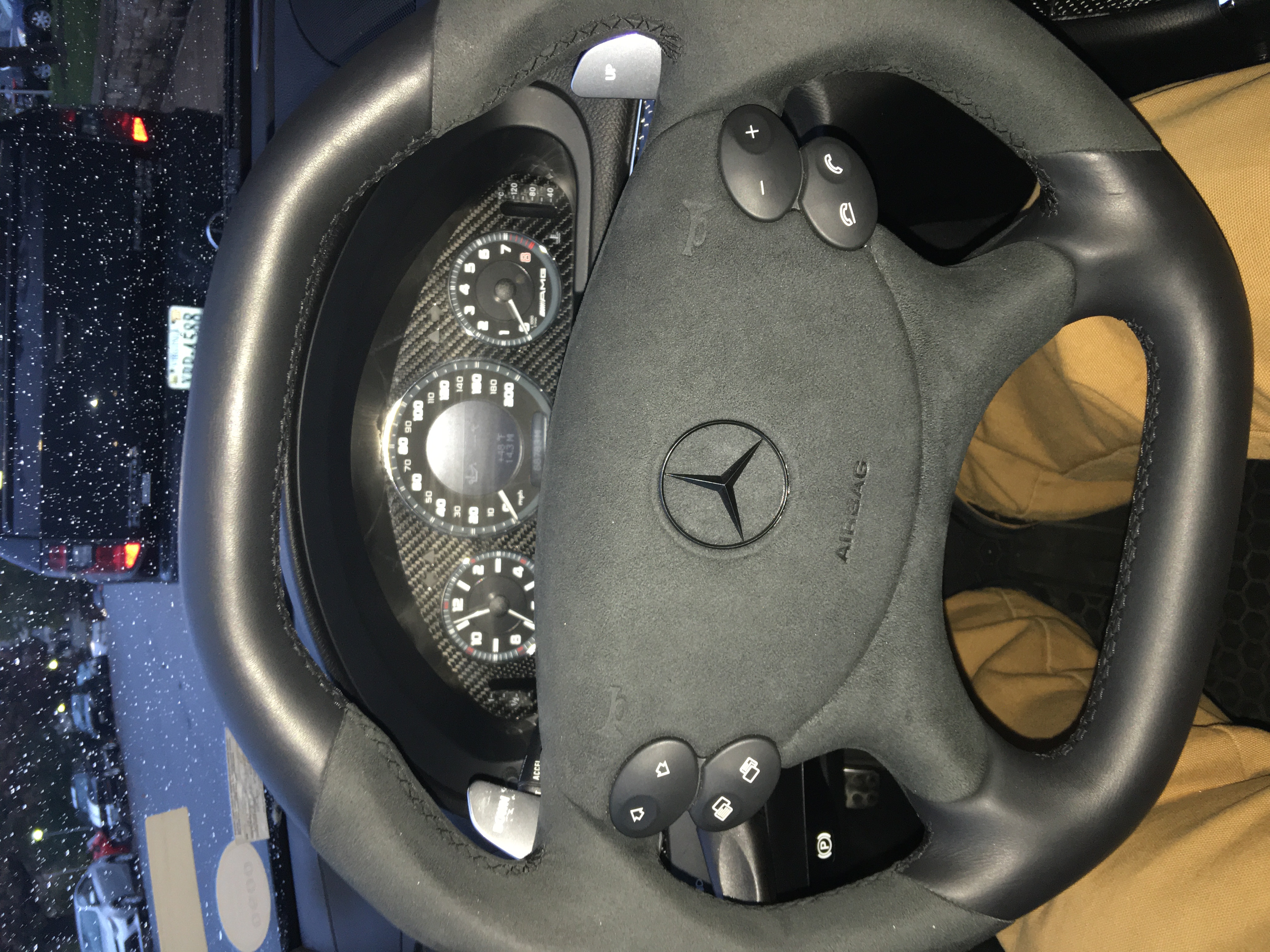

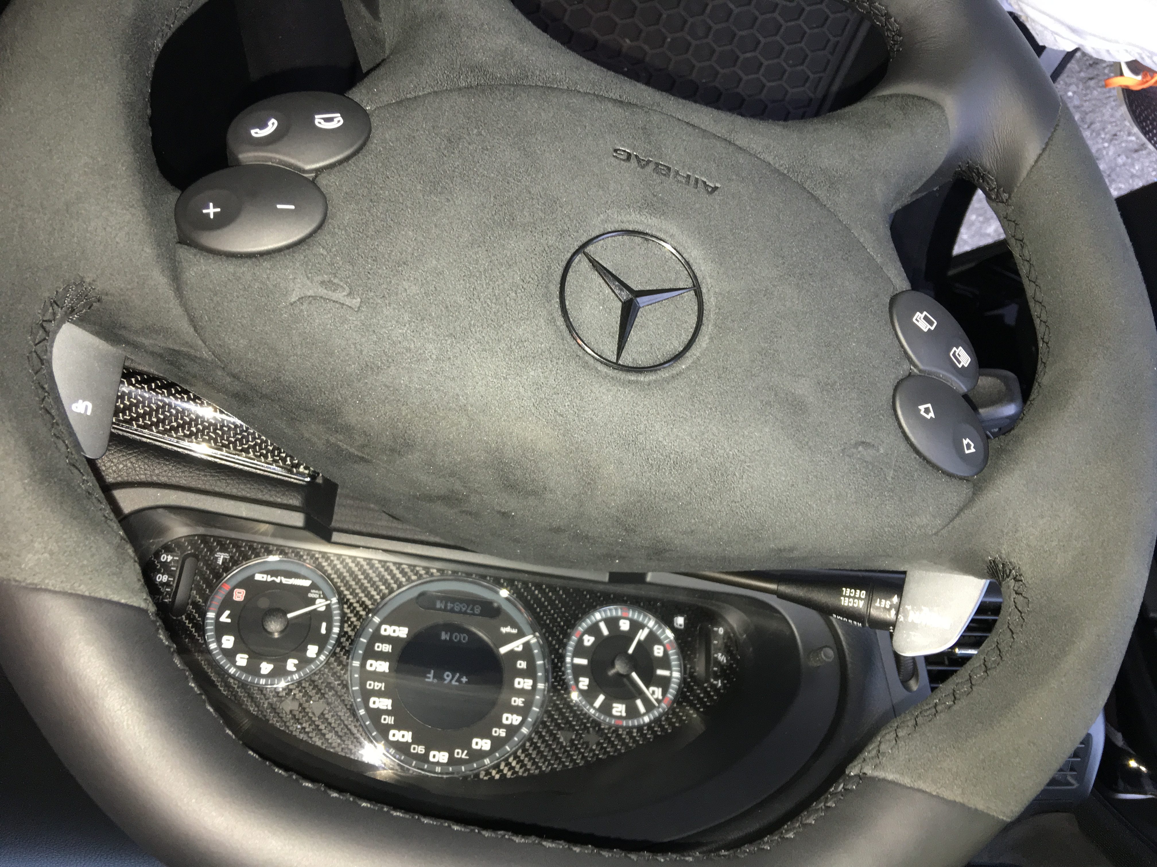

There is a possibility that, I might still have my old air bag at the shop from my E63. I replaced my old steering wheel a few years ago, for an Alcantara covered flat top and bottom steering wheel.
And I believe that the shop still has it sitting on their shelf, collecting dust. I will visit the shop in the morning, if they have it, I will sell it to you for a decent price. Fingers crossed.
