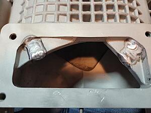

May 31, 2023 | 05:11 PM
I recently did this. It is a marginal increase in noise. Worth it? Yes! Night and day difference? Absolutely not.
p.s.- I also just picked up an E55 specifically to be a daily beater.
M113K Supercharger silencer delete too obnoxious for daily use?-20230214_141829_-resized-.jpg
Reply 2
