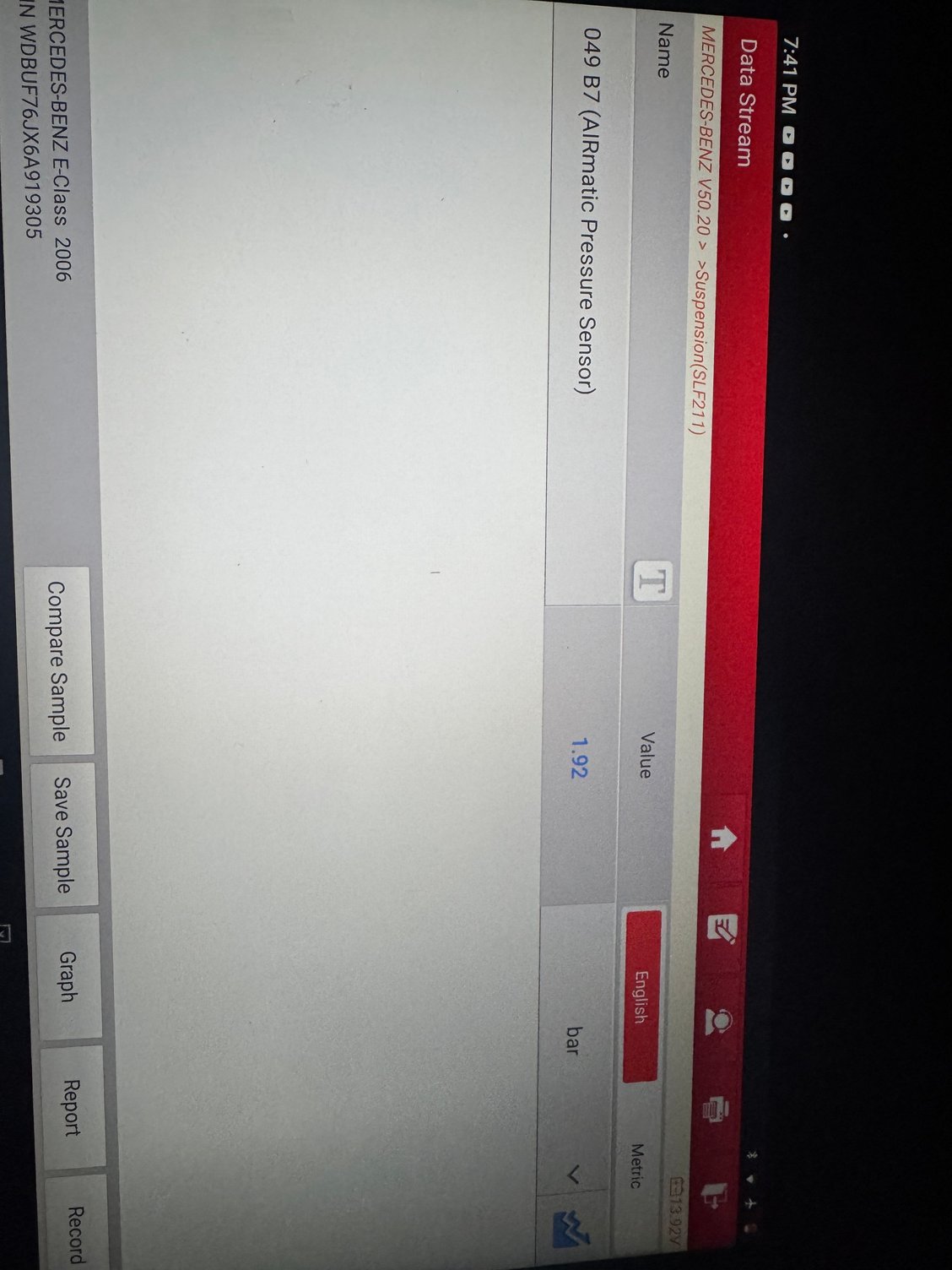

I’ve had this issue on my 06 E55 where my suspension feels super stiff. My 049 B7 Airmatic pressure sensor is only showing about 2 bar, I know it should be higher so
I scanned my friends 07 E63 to confirm and his pressure is at around 10 bar. What’s the remedy here? Replace the sensor? I believe it’s part of the valve block by the compressor so not sure if the sensor can be changed on its own. Or is this a compressor issue? Car raises up fine and gives no other indication of a weak compressor or low pressure anywhere which makes me think the sensor is reading the pressure wrong, and maybe pumping more air to compensate, resulting in the stiff suspension. I just changed the airmatic filter since it’s cheap and at 120k miles it was overdue, but as I expected, nothing improved. Thoughts?

You are reading the live data, not fault codes. Is the sensor faulty or not? If no sensor fault code, live data indicates first candidate is the air compressor, second is pressure relief valve, third is air leak that closes off at just under two Bar.
Suspension feels stiff because you are riding on the bump stops and destroying your air springs. If ride height is under 26" fender roll to ground, you are out of spec. 1.92 Bar is less than what WIS calls for to initially inflate air springs on installation.
Xentry ride level test calls for +/- 3mm optimum. Check that out.

I was going based off of live data because there are no fault codes, even after months of driving. Ride height is at normal level and stays at normal level, never sags. That’s the odd part, the only anomaly in the live data, including voltages, acc sensors, level sensors, etc., is the 2 bar on the pressure sensor. The compressor works just fine when I raise the car either with the lift button inside or with my scanner (also seems to relieve pressure and lower fine), however the compressor output being weak but not obviously noticeable is possible I suppose.

What are the pressures in the reservoir and the individual air springs? Can your diagnostic tool read those pressure sensors? If they are all right around 2Bar, I would say bad compressor but then run in Xentry a compressor test that measures how fast the pressure rises within a specified period of time. A failing compressor will not throw a code; all you can do is measure the output pressure rise versus time.

Now when I check, all 4 sides show exactly 5.76 bar, not sure if it’s normal for them to be the same. I couldn’t find the pressure for the reservoir unless that’s the 049 B7 sensor. My scanner does have the compressor test function and it passed without issue, rose up to 14 bar within a few seconds. I have noticed lately that the car will lower an inch or so below my calibrated level evenly on all sides after driving. No obvious leaks anywhere.

FWIW, all of my air springs show 5.7 - 5.8 Bar. Minor variations in pressure. Perhaps it is a bad sensor. Check the electronic parts catalog to see if it is available separately or only as part of the valve block assembly.

UPDATE, SOLVED:
I figured it out and it’s embarrassing to say the least. I had some ESP codes stored from when I had disconnected some things a few weeks ago that were forcing the car into the super stiff suspension “safe mode”. Cleared the codes and it’s good again. I was 100% positive I had cleared the codes prior to all of this but evidently not, caused myself a ton of stress for nothing!
