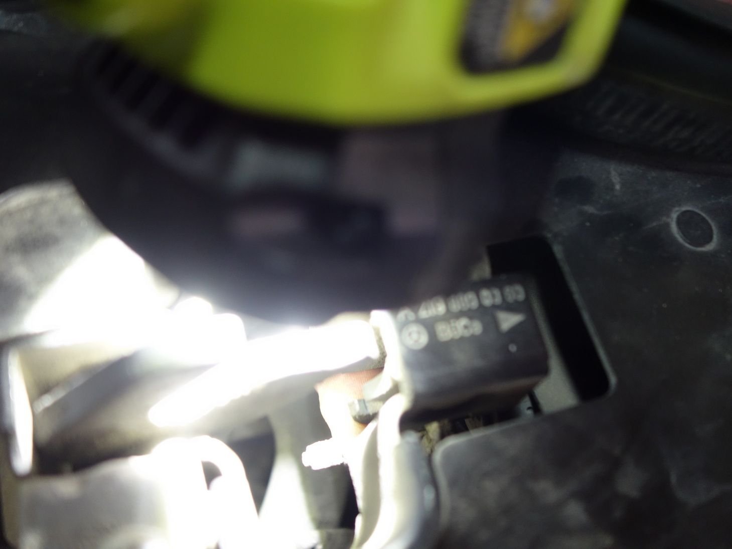

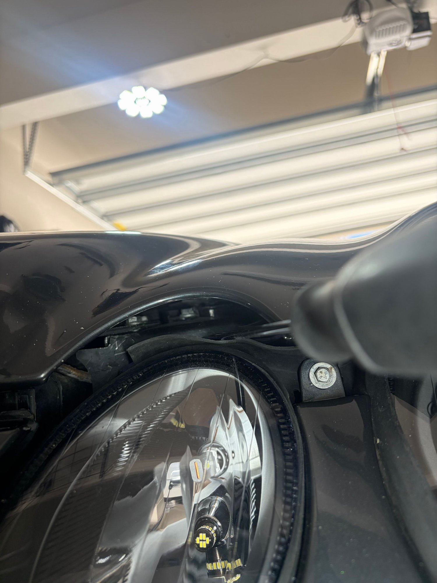

Possible but gonna be interesting. I just took a look at mine and took some (bad) photos for reference. Appears possible to release the latch from underneath by going around the fanfare horn. You will need to remove the undertray from the bumper (which means detaching the middle undertray). The fanfare horn is mounted forward and outboard of the hood latch and is mounted in a rectangular cutout in the bodywork. The latch releases by being pulled/pushed outboard and to the rear of the car at a ~45* angle.
Apologies in advance for the poor quality photos...
Hood latch in lock position. Cable ferrule seen next to the latch.
Latch pulled into the unlocked position using my finger tip. Doesn't take much.
Fanfare horn mounted below the headlight and latch. I'm standing in front of the car and leaning way over into the engine compartment. This looks like the best access point to me.
Looking down through the latch towards the fanfare horn (it's the over-exposed blob in the photo).
Photos to give you an idea of the angle from the fanfare horn opening to the latch.
Hope this helps. Let us know if it works.

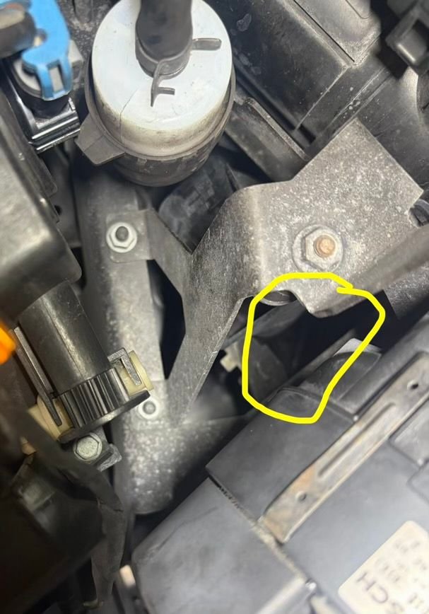

I can see the cable but I can’t get a tool on it to release it. Tried my grabber tool but doesn’t have enough force.

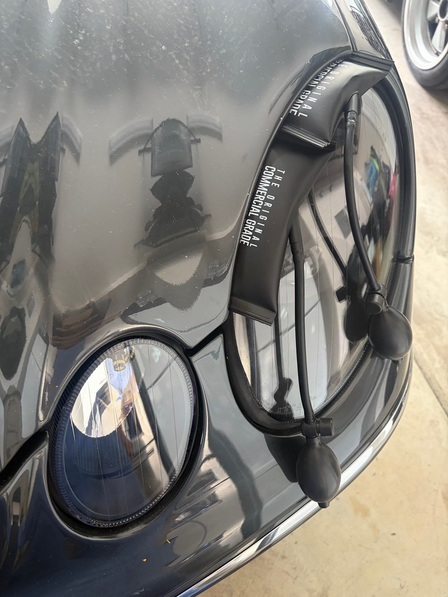

I started using a prybar too. Used these airbags to make enough room to get it in. Basically destroyed the latch mechanism but I’ll gladly replace that instead of the whole hood at this point. Can’t get it to release. Did you see where other folks leveraged a pry bar against? Wish I could fit a bolt cutter in there.
