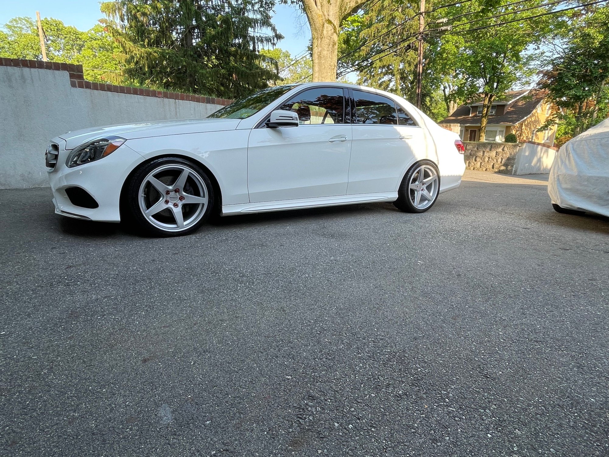

Originally Posted by T_Cob
ZITO ZF01 Satin Gunmetal
5x112
Front 20x9 ET25 265/30/20
Rear 20x10 ET45 295/30/20
Michelin Pilot Sport 4S
This pic I'm lowered with H&R springs up front and links in the rear. But now its back at factory height which I prefer since the ride quality is much better.
Sharp!
I'm looking at a set of C63 rims for my 2015 S212, 19x9 ET25 front/19x10.5 ET57 in the rear. I'm not terribly concerned about rubbing in the rear with those, even with a 4mm spacer. However, of all the setups shown here, yours is about the closest to the spec of those C63 rims, and I have to ask:
Now that you're back to stock height, do you have any rubbing up front?

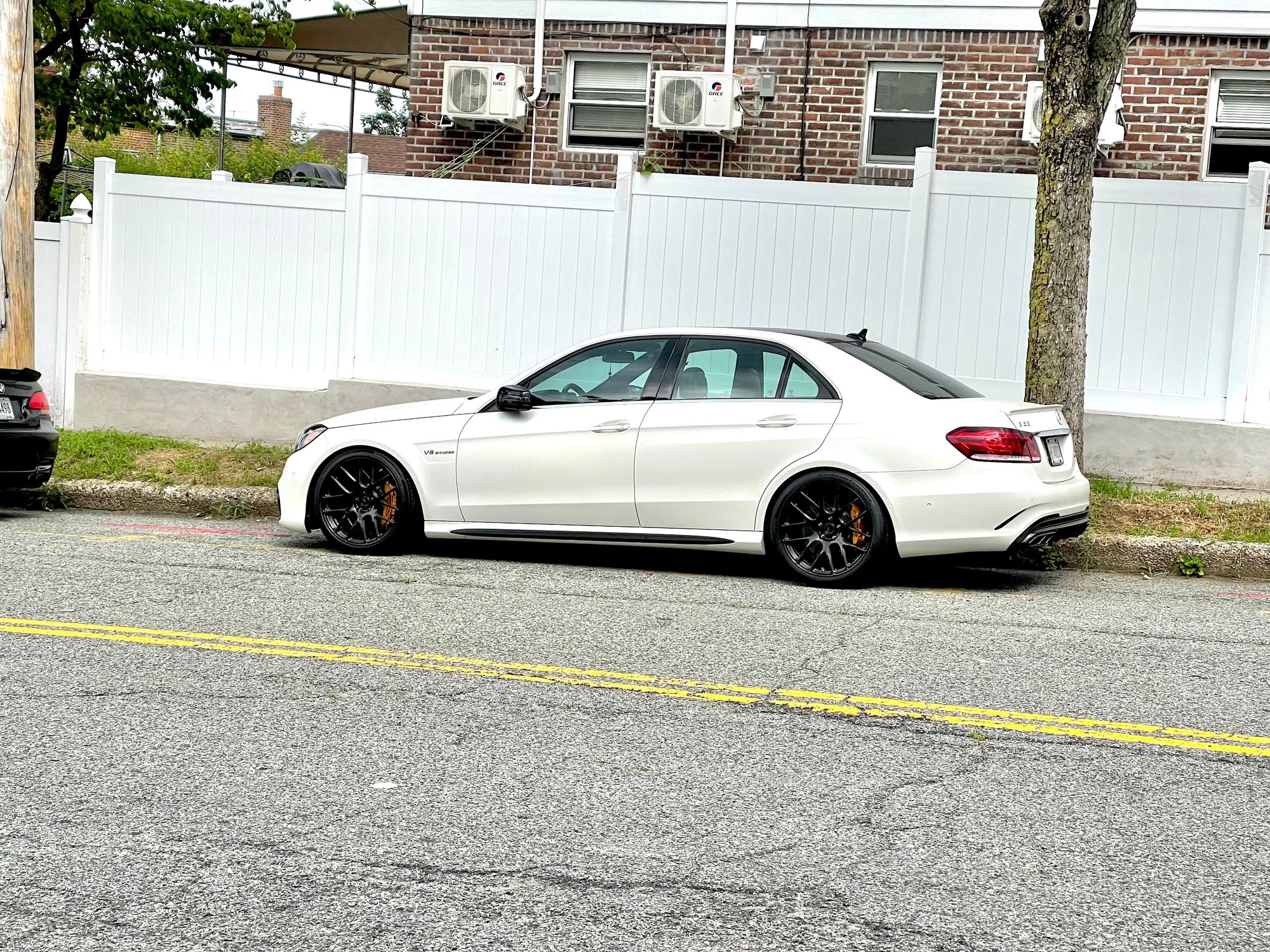

After almost 7months wait...well worth it!!! Just want to share one picture for now until I take some better ones.

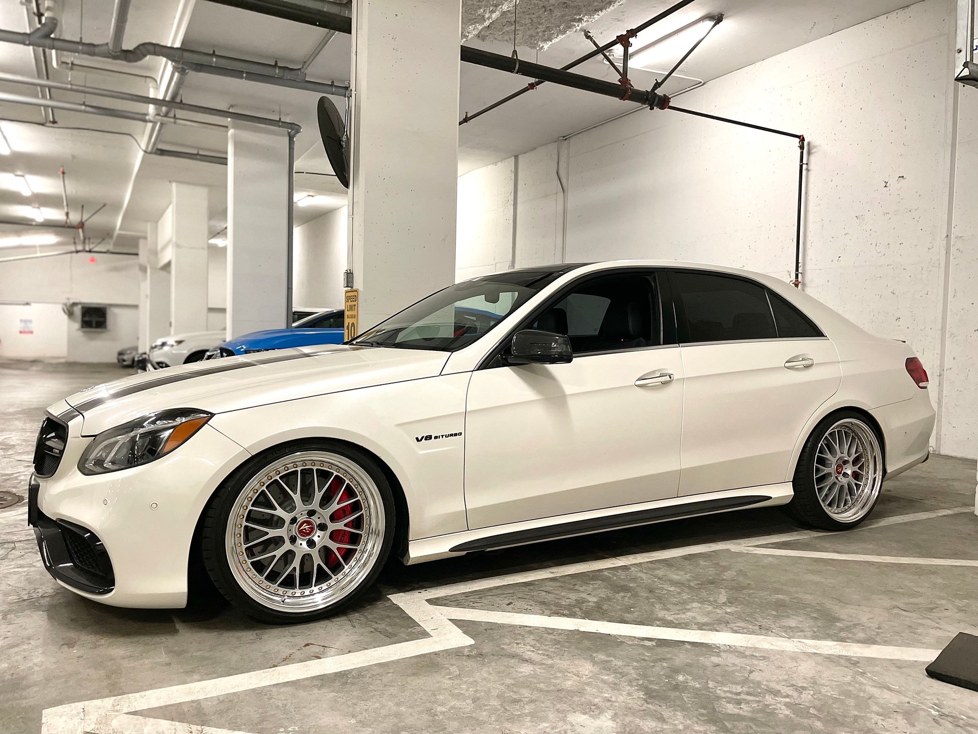

I am running 20x9.5 28et and 10.5 45et 3pc Steplips VSXX Work Wheels. Fits perfectly with no rubbing and I am lowered on KW HAS kit.
Been super busy with work and stuff so hope to get better pics soon!! Not sure why my rear looks so jacked up in this pic lol...might be just the angle!!
