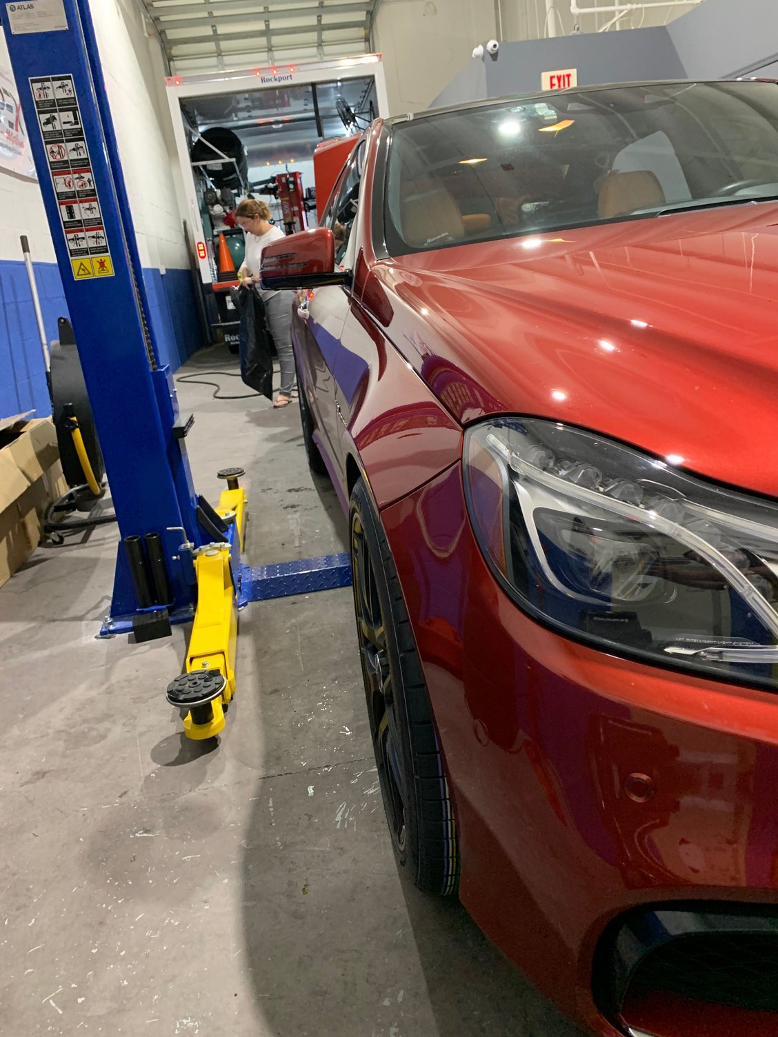

Originally Posted by Rehabguy
What sizes tires are you running?
Thanks.
255/30/20 MICHELIN PILOTSPORT 4S
295/25/20 MICHELIN PILOTSPORT 4S

Originally Posted by Ncbimma
5X112 20X9.0 +35
5X112 20X10.5 +45
PS4S
Thanks for your response. I asked cuz your front tire looks a bit on the stretched side from this angle. A 255 on a 9" wide wheel should really not be stretched. Just sayin'
None at all. Full lock and major hwy bridge dips at speed see no rubbing. I wanted the most concave look without rubbing.
I'm stock suspension, fyi
Thanks!!
Max width on a 9in rim shoud be 265. 245-255 is the erogenous zone.

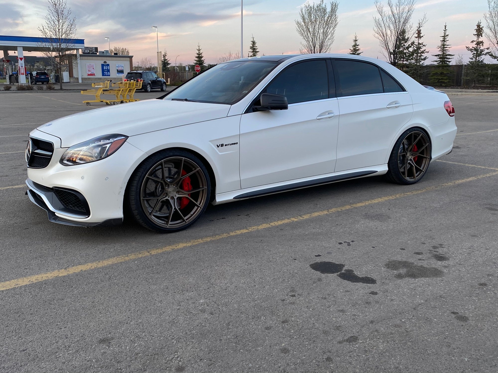

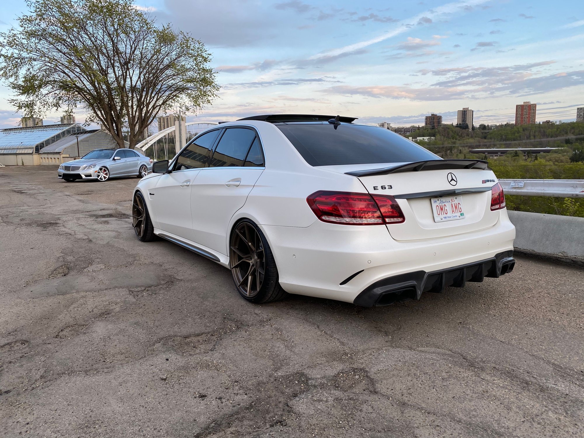

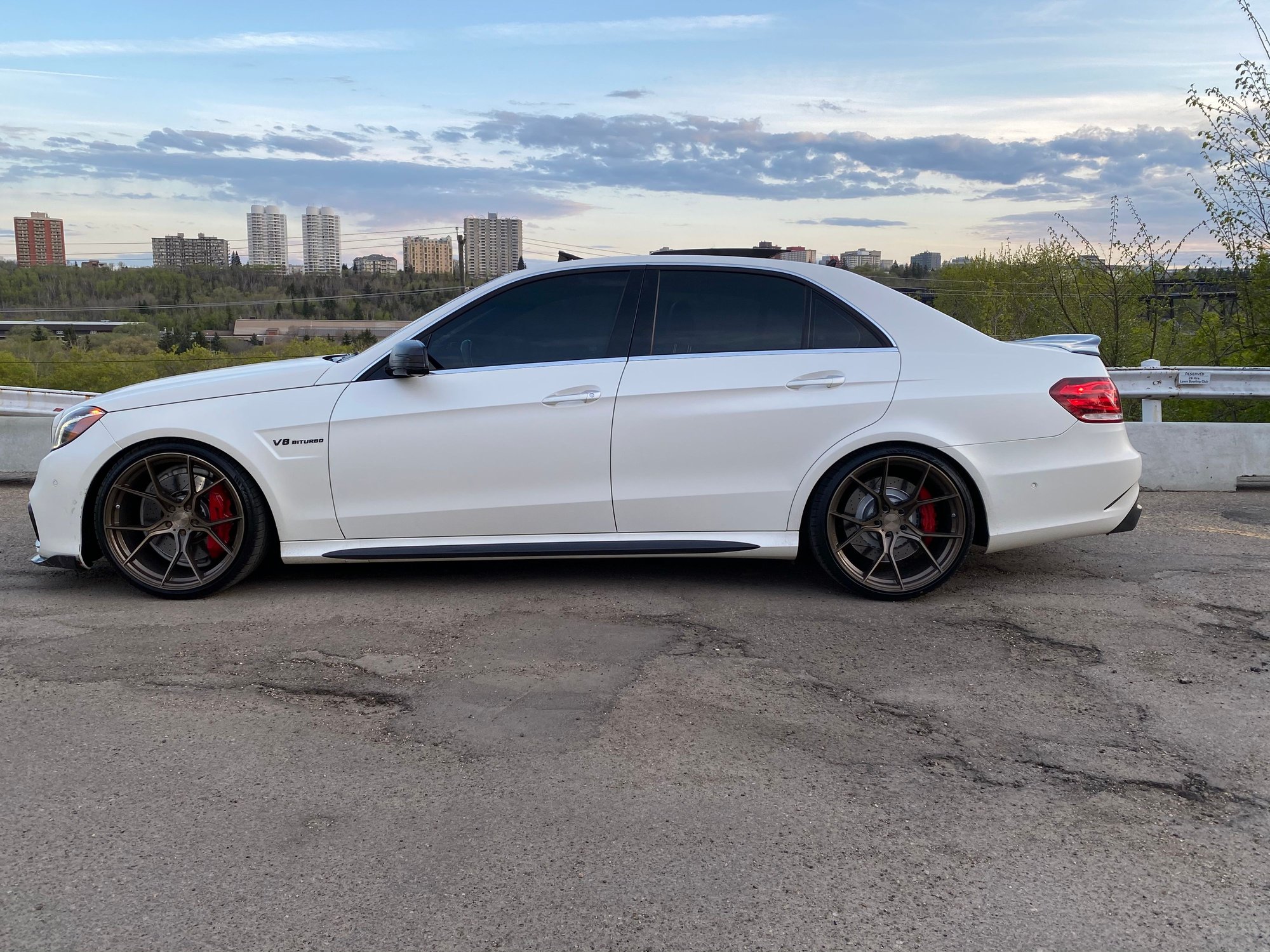

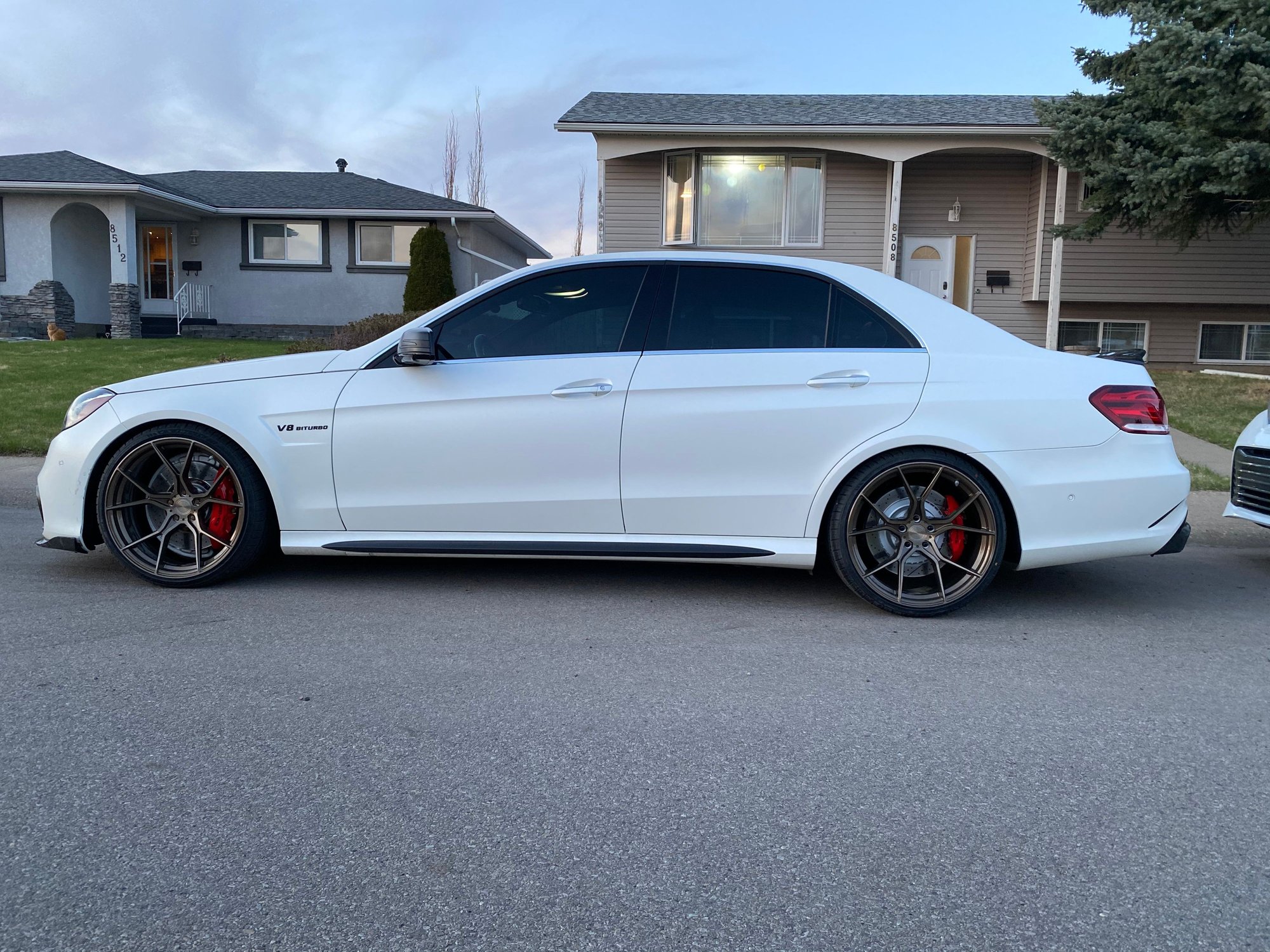

KW HAS.
20x10.0 +35 265/30/20
20x10.5 +47 295/25/20
need to lower the front a bit more, but supper happy with fitment.

Originally Posted by SAMzE63s
KW HAS.
Looks great! I agree, just a tad lower up front. I'd have gone with Bronze wheels as well if I had red calipers. I am surprised you can run a +35 10" wheel up front. I run a 9.5 +32 (3mm spacers) cuz I felt +35 was a bit close to the strut for comfort. Again. It looks awesome.
Thank you! The 35 upfront is VERY close to the strut, but 1mm or 1 inch, clear is clear lol

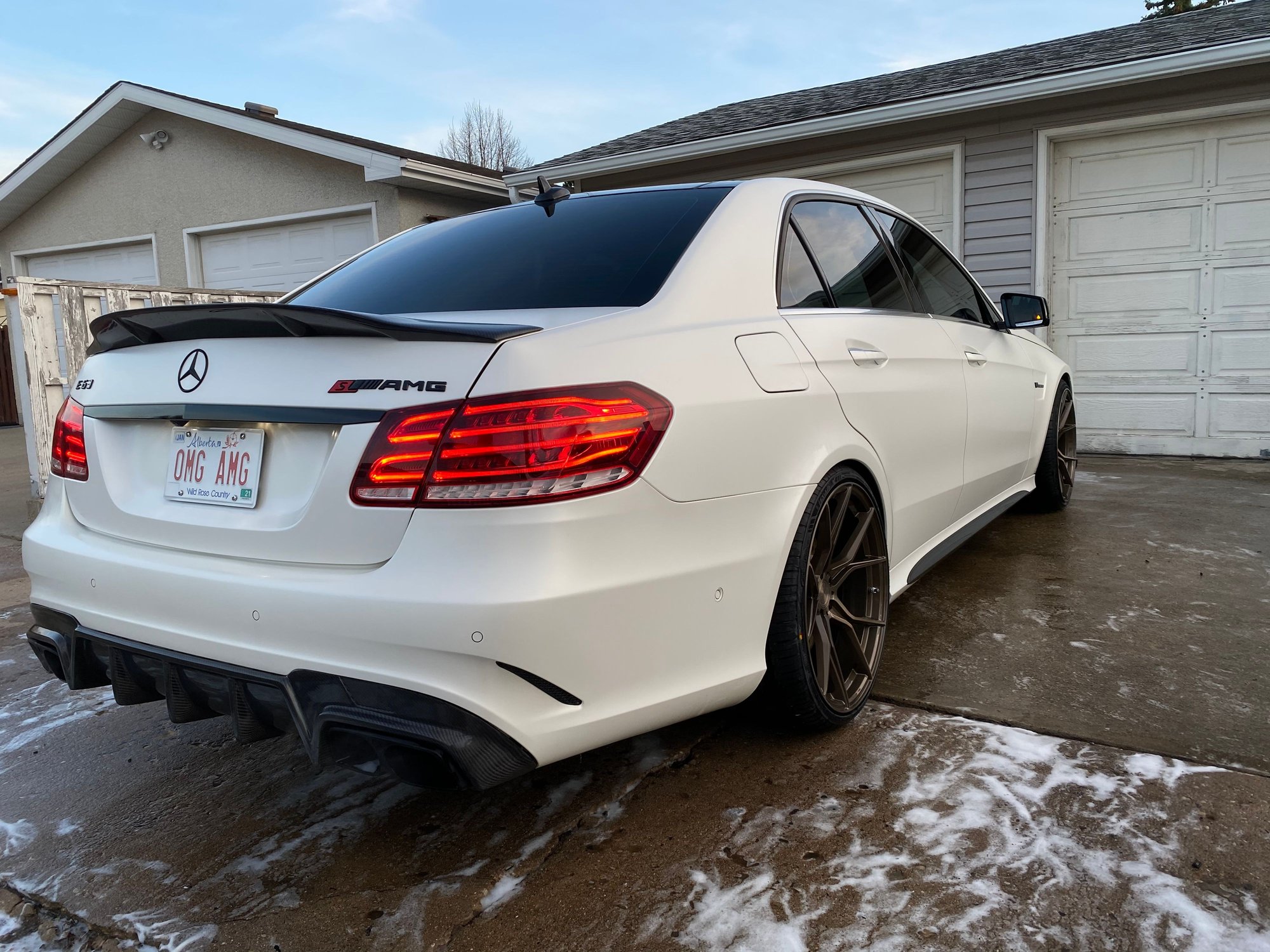

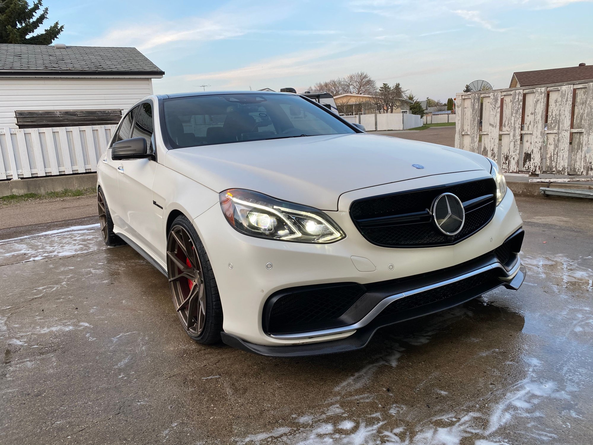

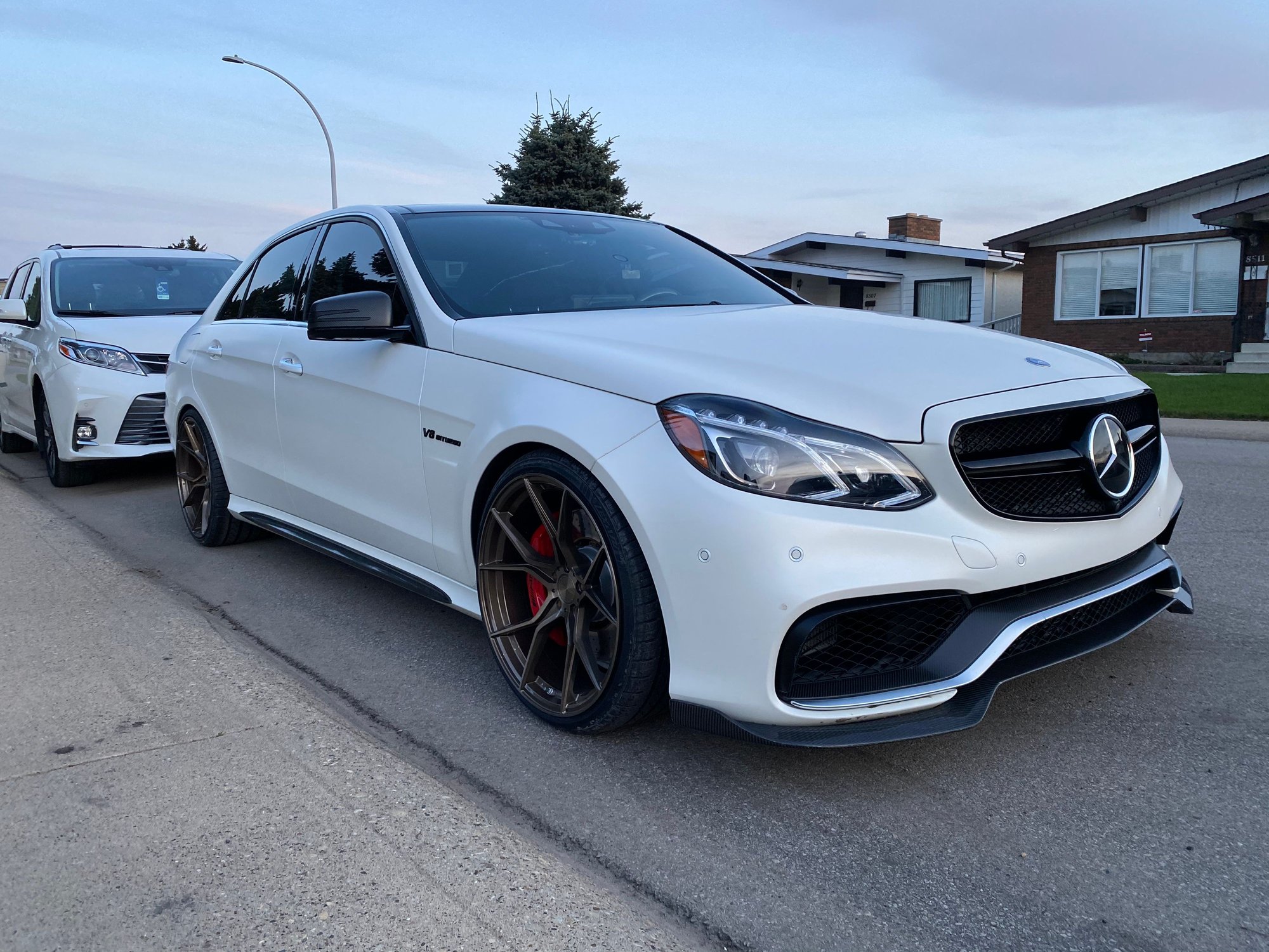

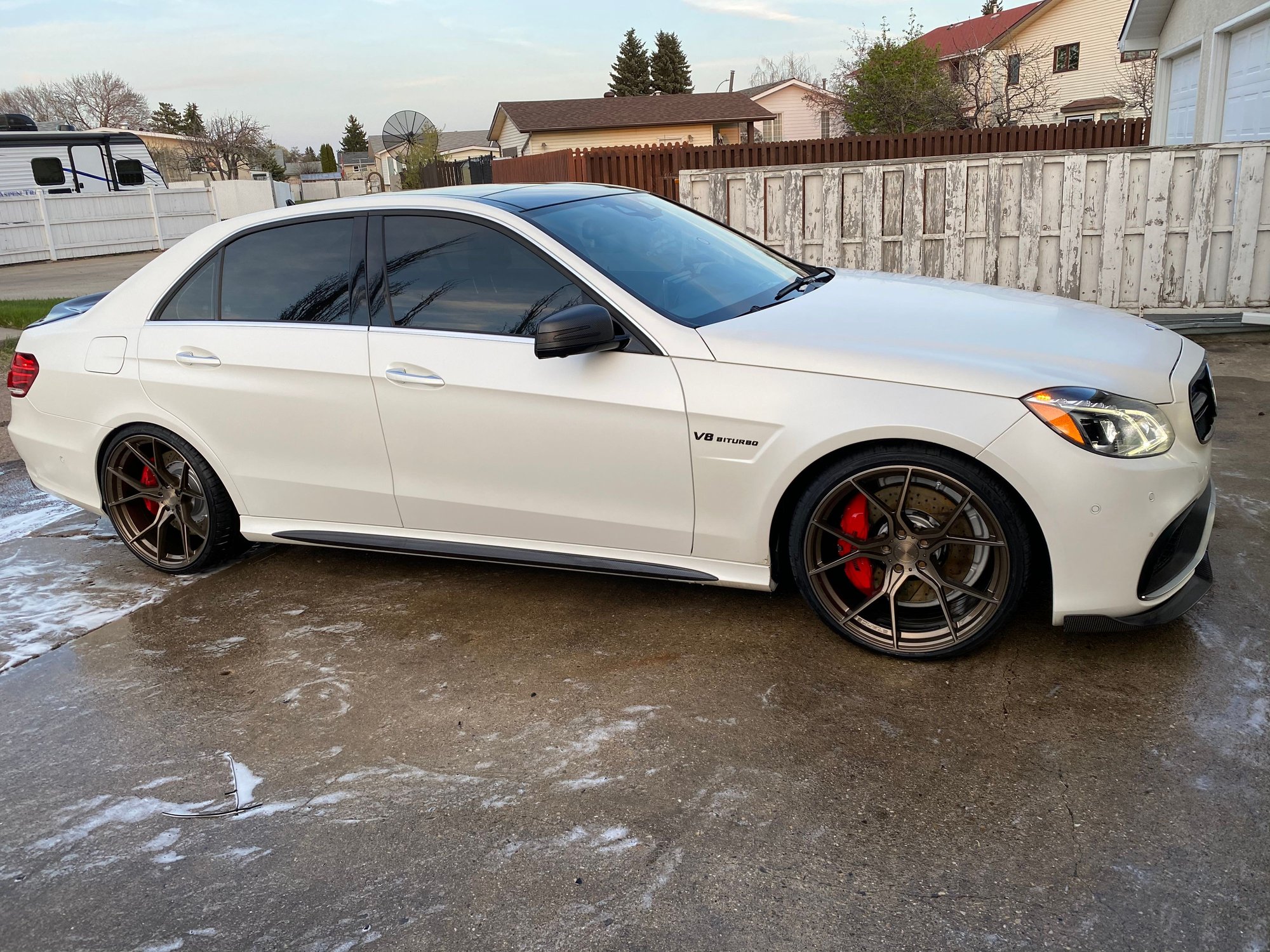

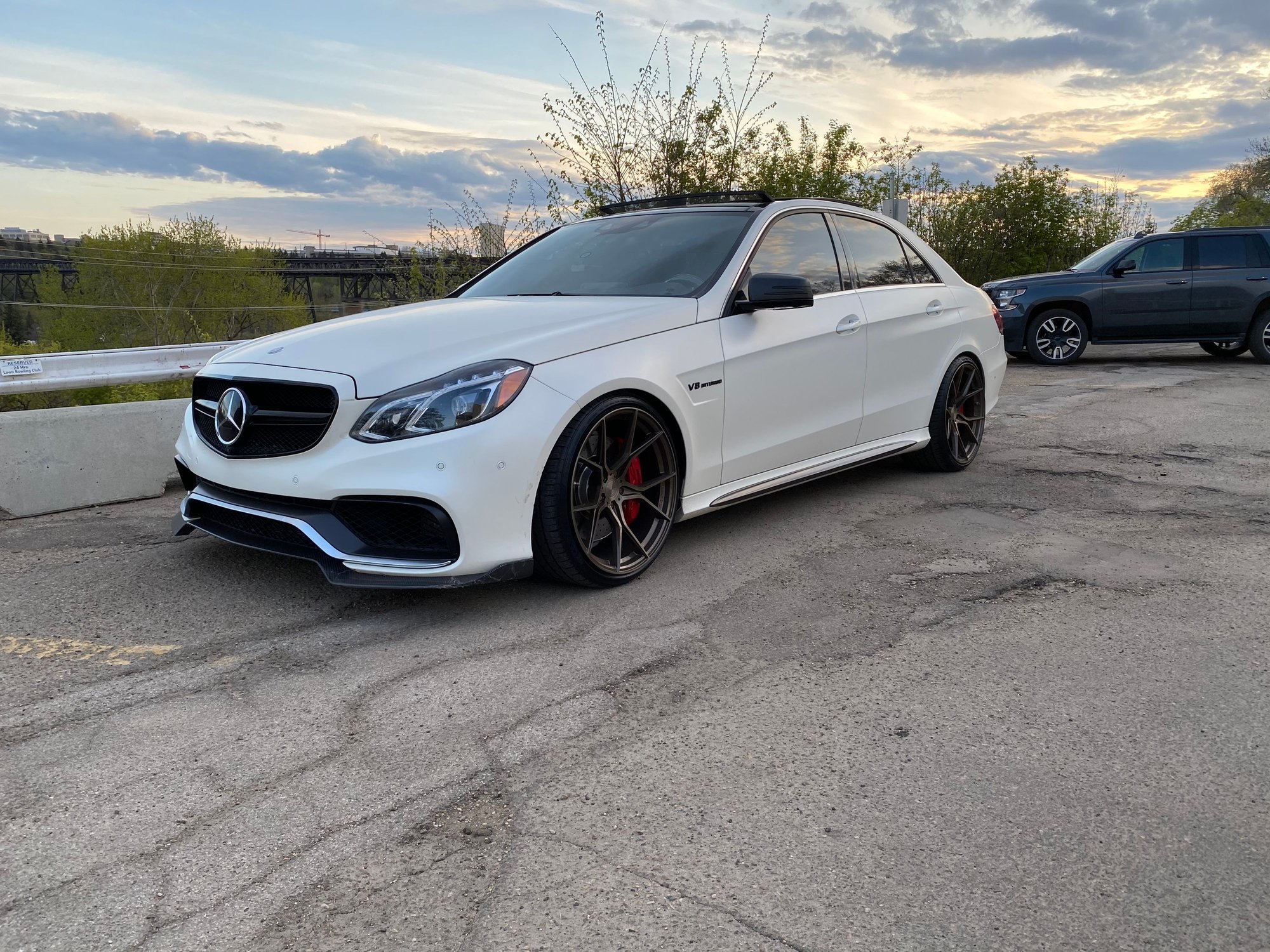

Lowered the front a bit more. Almost tempted to lower it all more lol this low life is addictive

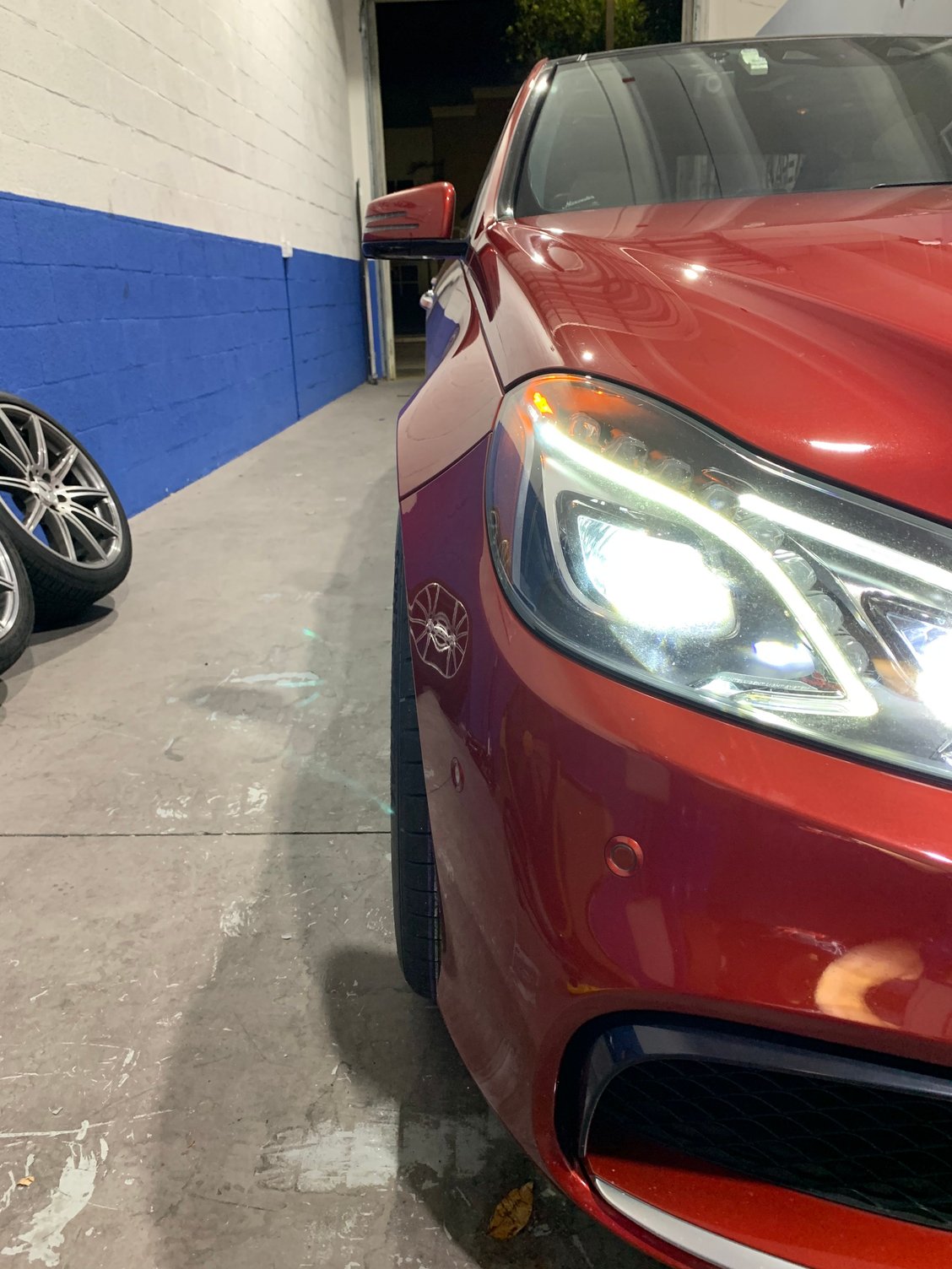

Hey, looks great....
I have your near twin, right down to the front splitter, just different wheels.
I see that you have the KW springs....would you give me some insight on the ride quality? I have the latest Renntech springs, not sure who's making them, but am really unhappy with the ride quality. I know it's not gonna ride like an old 126 on Michelins, but it is pounding. It rides harder than the 21' setup on my W213. How do you feel about yours? ( I think that these cars are just way over damped for the USA, just too
hard).
Did you get them from someone on this board?

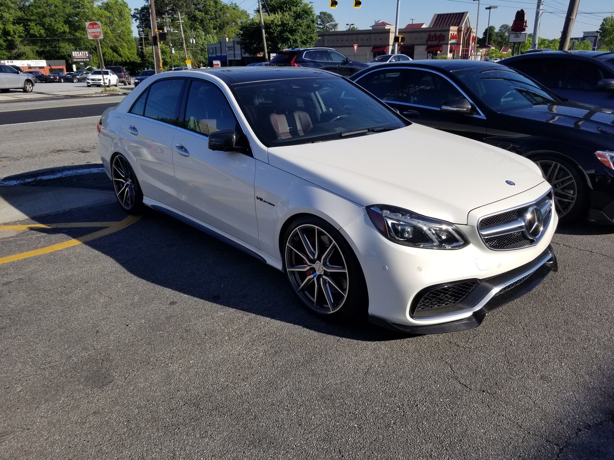

Thanks for the info, picture of mine for height reference...

Didn't get the second pic..
sorry, easier to judge...

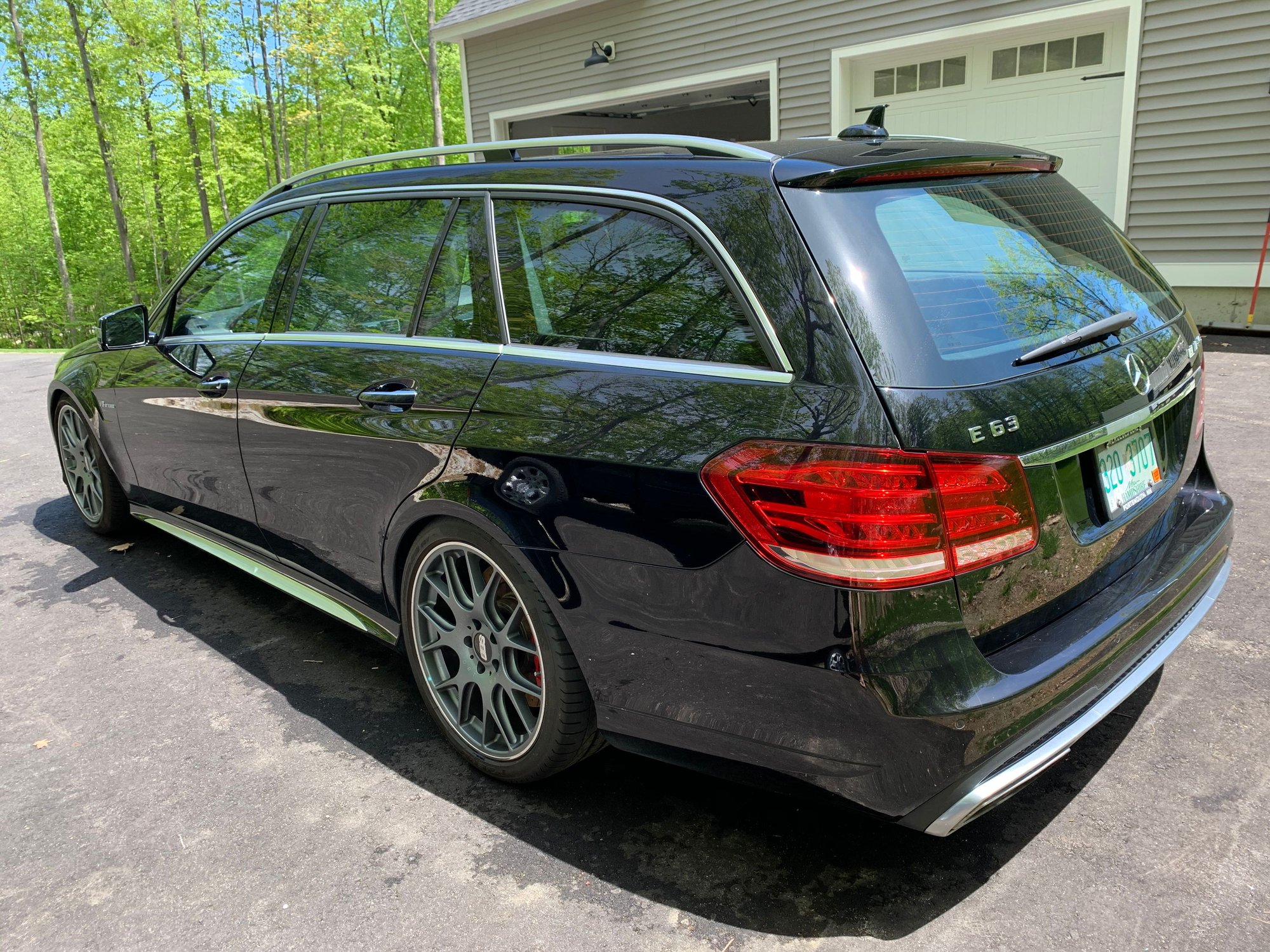

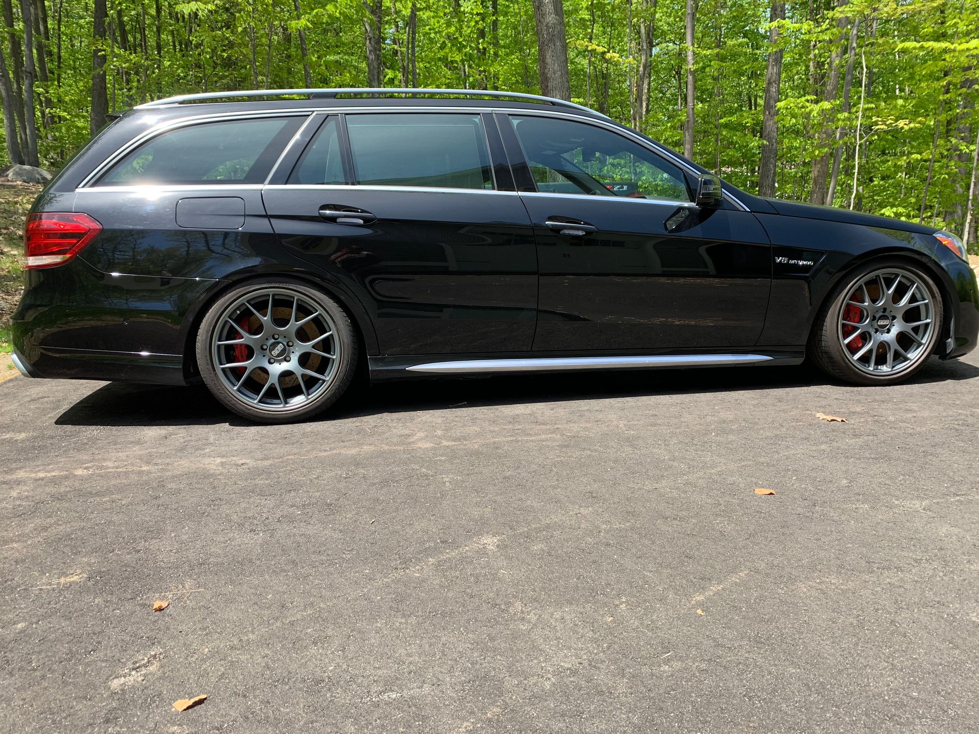

19 inch BBS CHR f8.5 and r9.5
Nice! What are your tire and offset specs? Did you have to run spacers to get these BBSs to fit?

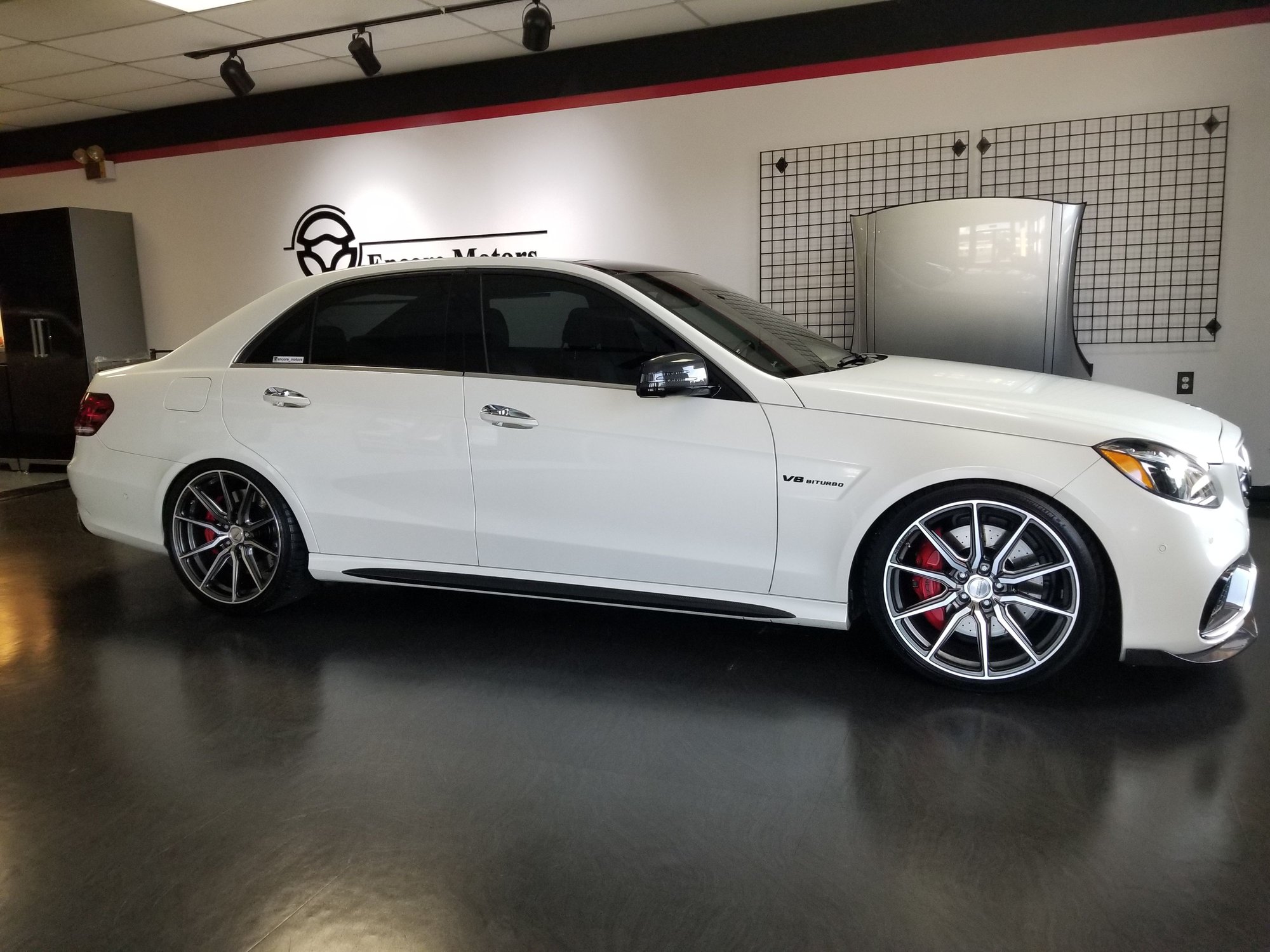

ZITO ZF01 Satin Gunmetal
5x112
Front 20x9 ET25 265/30/20
Rear 20x10 ET45 295/30/20
Michelin Pilot Sport 4S
This pic I'm lowered with H&R springs up front and links in the rear. But now its back at factory height which I prefer since the ride quality is much better.
et40 front and et45 rear. No spacers but might add a 5mm to the front. Stock tire sizes.

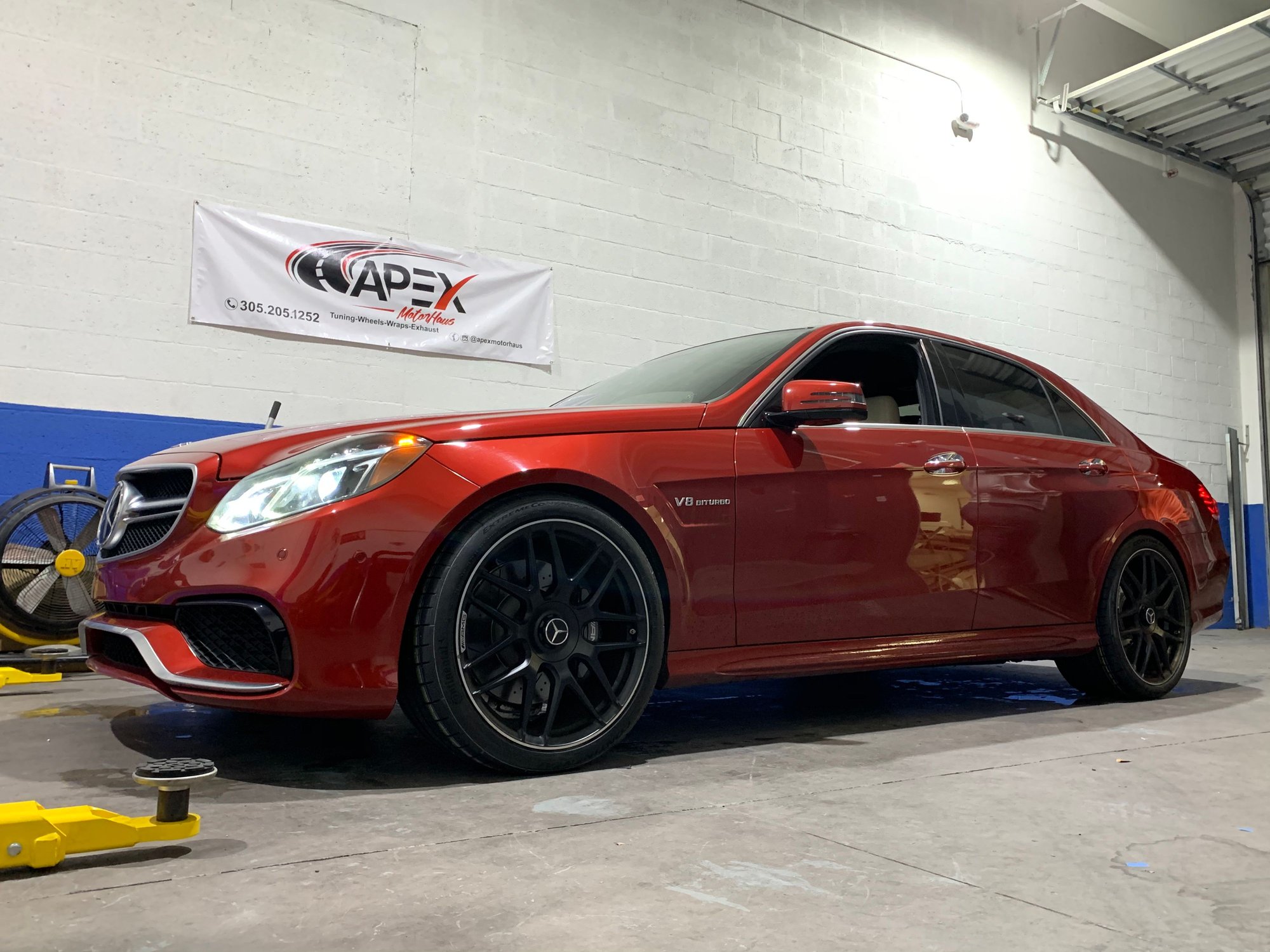

I just did a W213 E63s OEM setup on my friends W212 E63 4-matic
265 front and 295 rear
