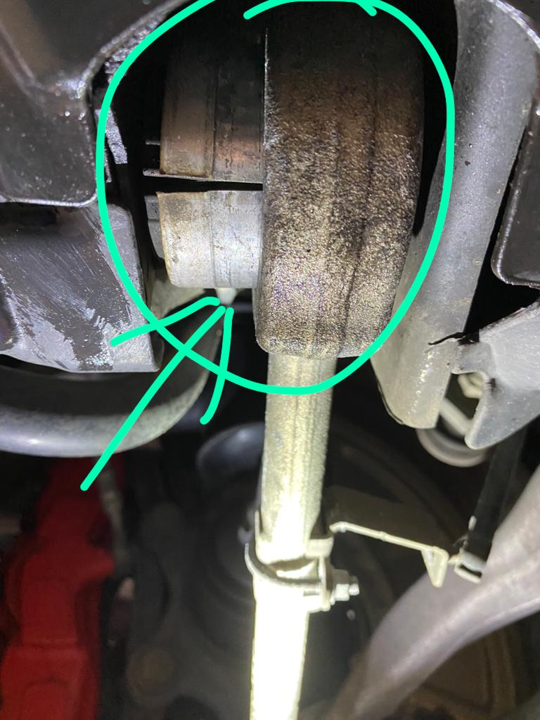

That’s the picture the mechanic sent me, is that The lower control arm? It was the most irritating sound driving slow and hearing it over every bump. I would hear it getting in and out of the car.

Hey so if anyone has this issue like I displayed in the youtube video(also in cylinder heads picture), it is the result of a bad driver side lower (rearward) control arm had it changed and its all good now!
