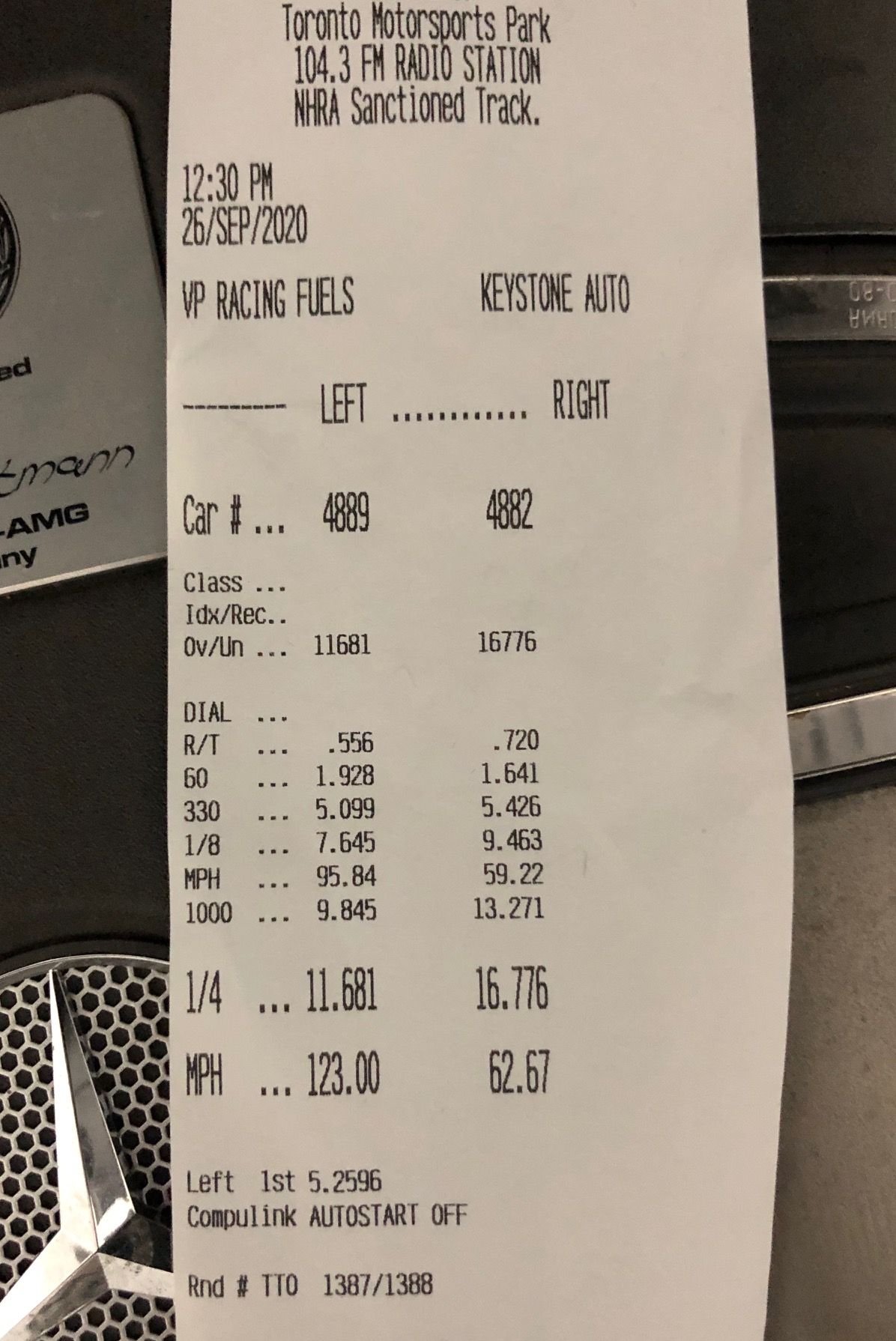

Something is wrong. Stage 2 plus TCU? I hope you find the gremlin. IMHO you should be waaaaaaaay faster.
Here is mine bone stock on bald tires:

10.8-11.1 with that DA is where you should be at
