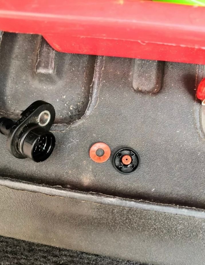

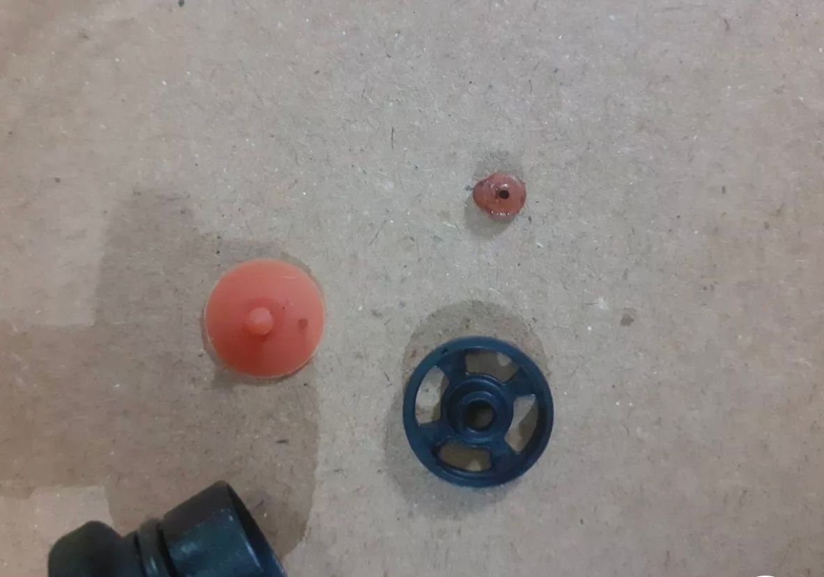

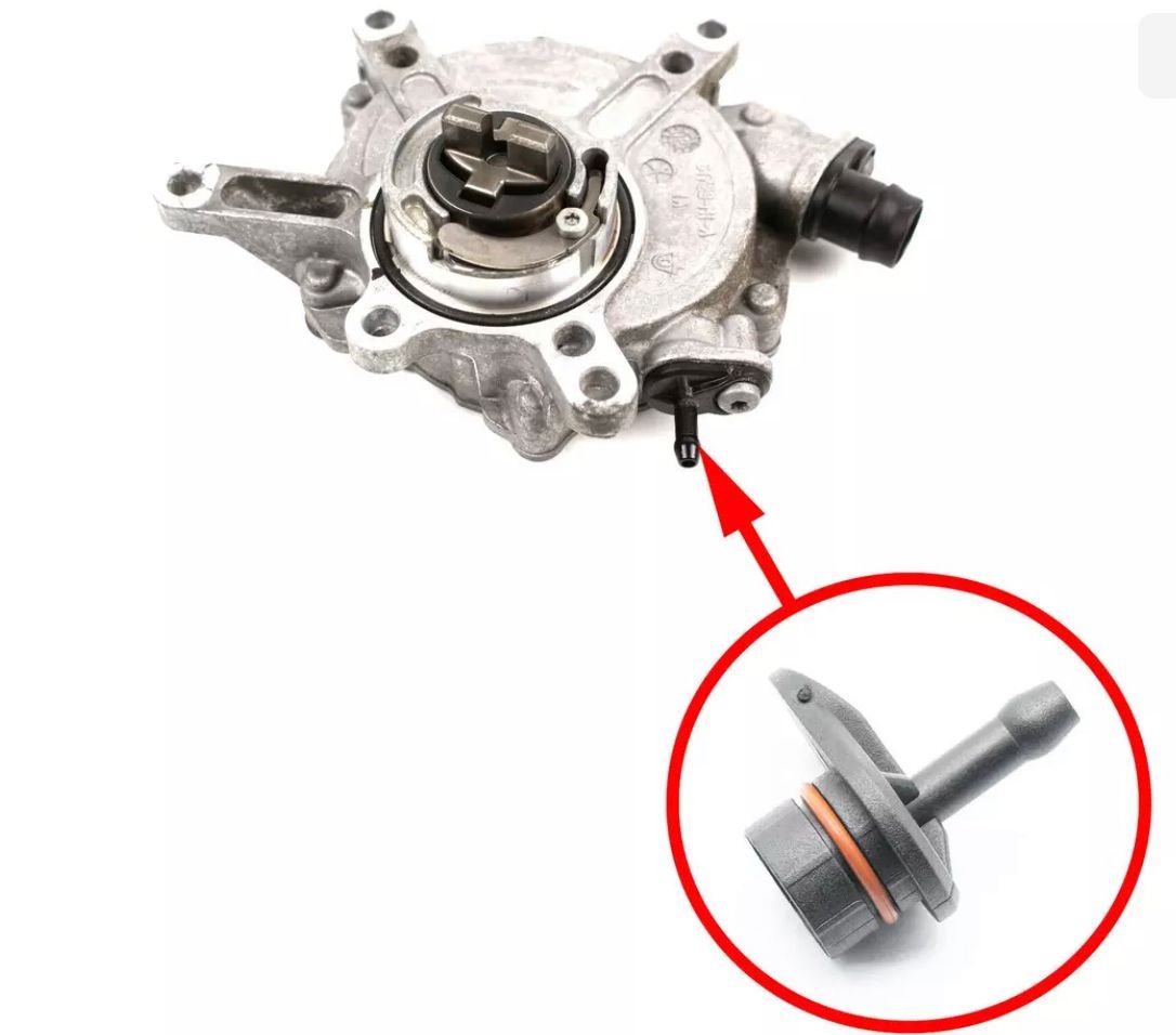

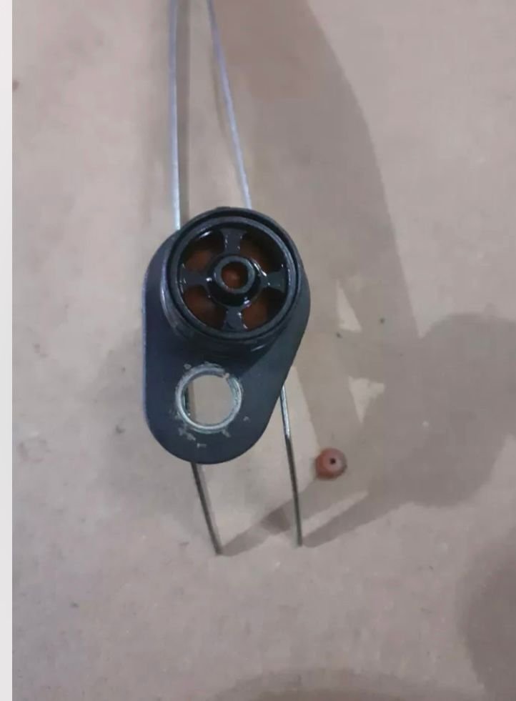

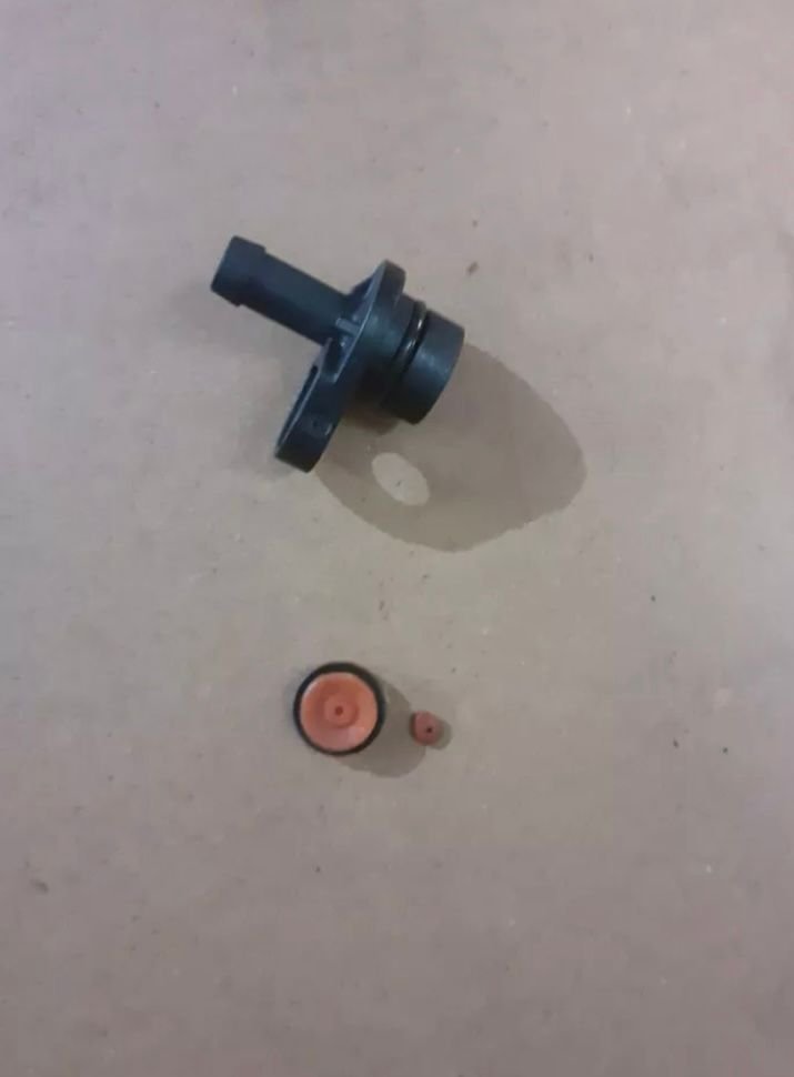

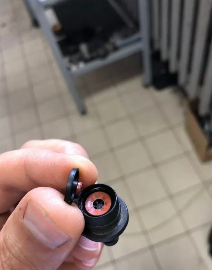

Hi
The problem is in the Vacuum pump check valve in the Vacuum pump there is 2 check valve 1 big valve for brake booster and the another one for the Turbo solenoid this solenoid control the Wastgate of the turbo. I’m sure 100% this is your problem. Mercedes dealer they didn’t sell this Valve separately they sell all Vacuum pump but you can find this Valve online. Try to remove by your self and see the valve it’s one-way-valve. make sure when you remove you don’t leave broken pieces inside the vacuum pump hole. The problem not in the check valve but the problem inside the check valve there is small diaphragm orange color 80% you will not find it inside the check valve because it’s get damage from the heat and going inside the Vacuum pump. here is the picture for the check valve and the diaphragm inside the check valve
See the picture down below 👇
