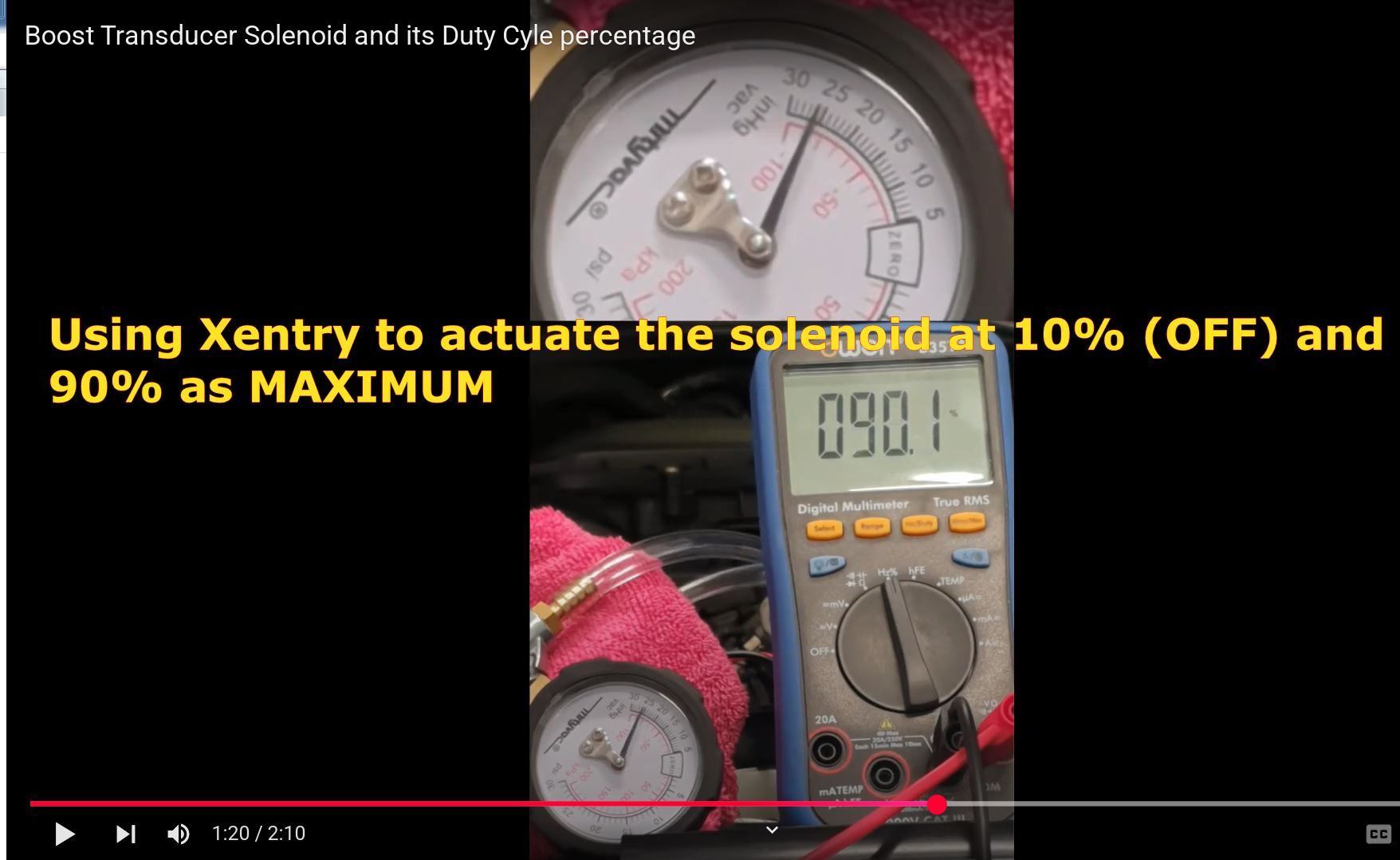

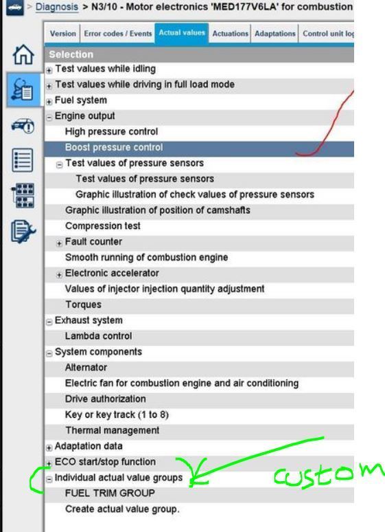

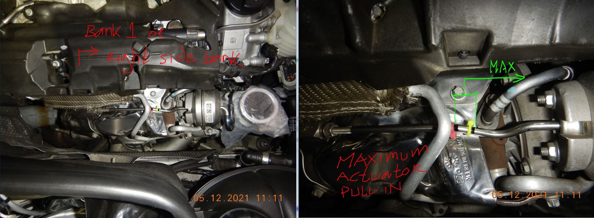

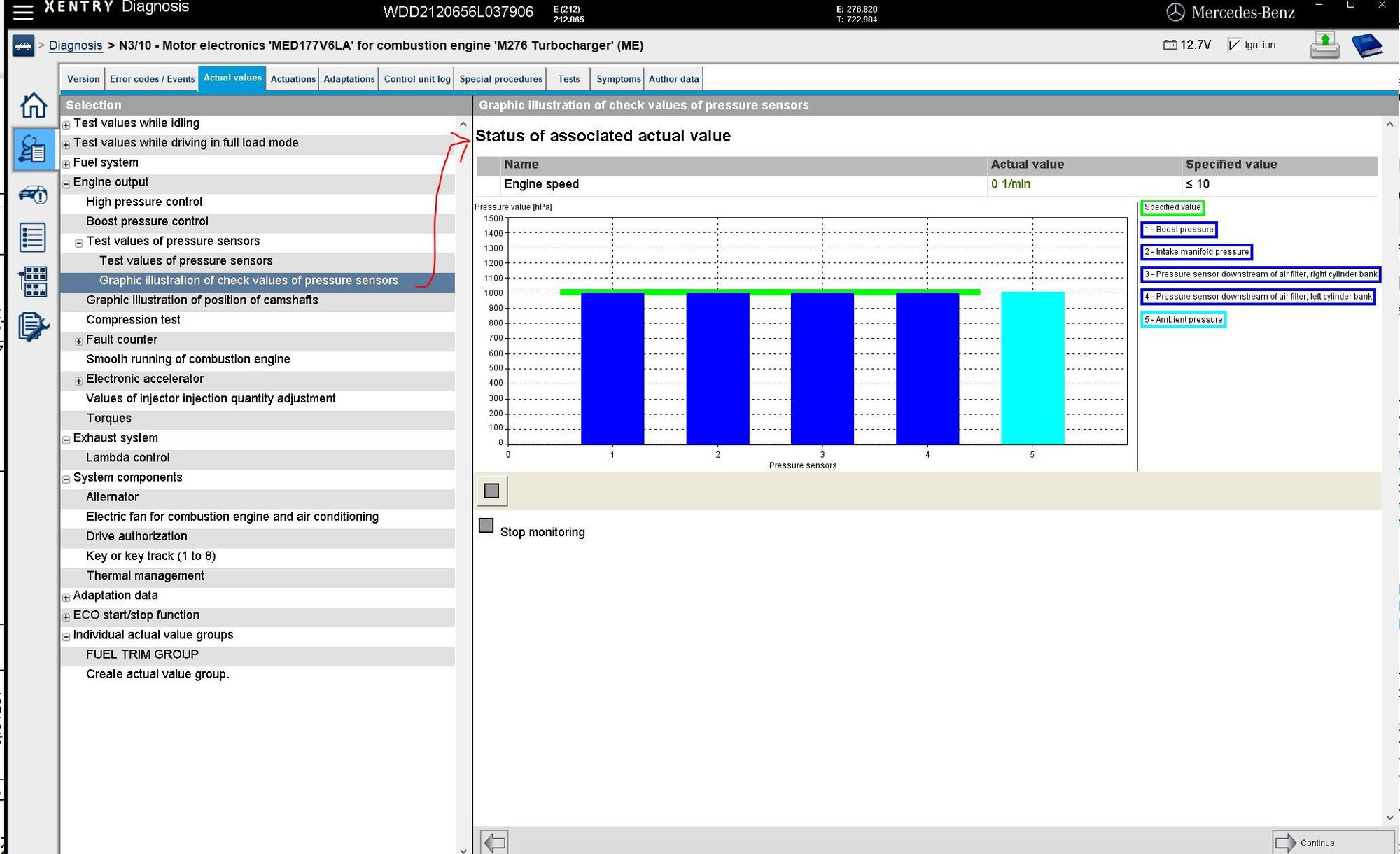

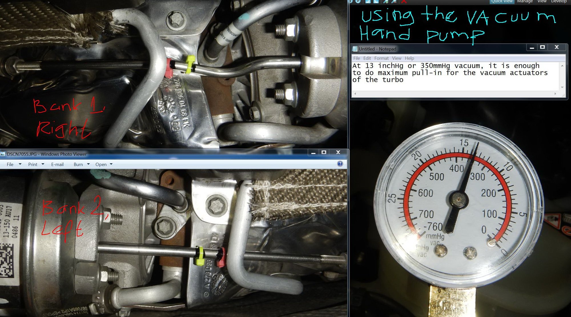

The boost controller can go bad without being dead, it fails its precise regulation or slow to respond.
That thing is PWM controlled. Its basically a shaker, minute shaking of valve seat we can't see by eye.... as suction pressure regulation method.
I have replaced mine in 2021 ( 7 years old , approx 30,000KM ), because it was kinda noisy when tested , I created a leak on purpose.
The problem with failed check valve at vacuum pump is, if left long enough, oil will travel to the turbocharger vacuum control system and may end up at the
vacuum actuator of turbo wastegate. Tasos video has shown how much oil that round thingy can hold under its membrane.
Since oil is liquid and not compressible, the vacuum actuator can not do it maximum pull inwards and you loose boost.
M276, M278, M157 wastegate controller is SUCK ( vacuum ) to maintain pressure.

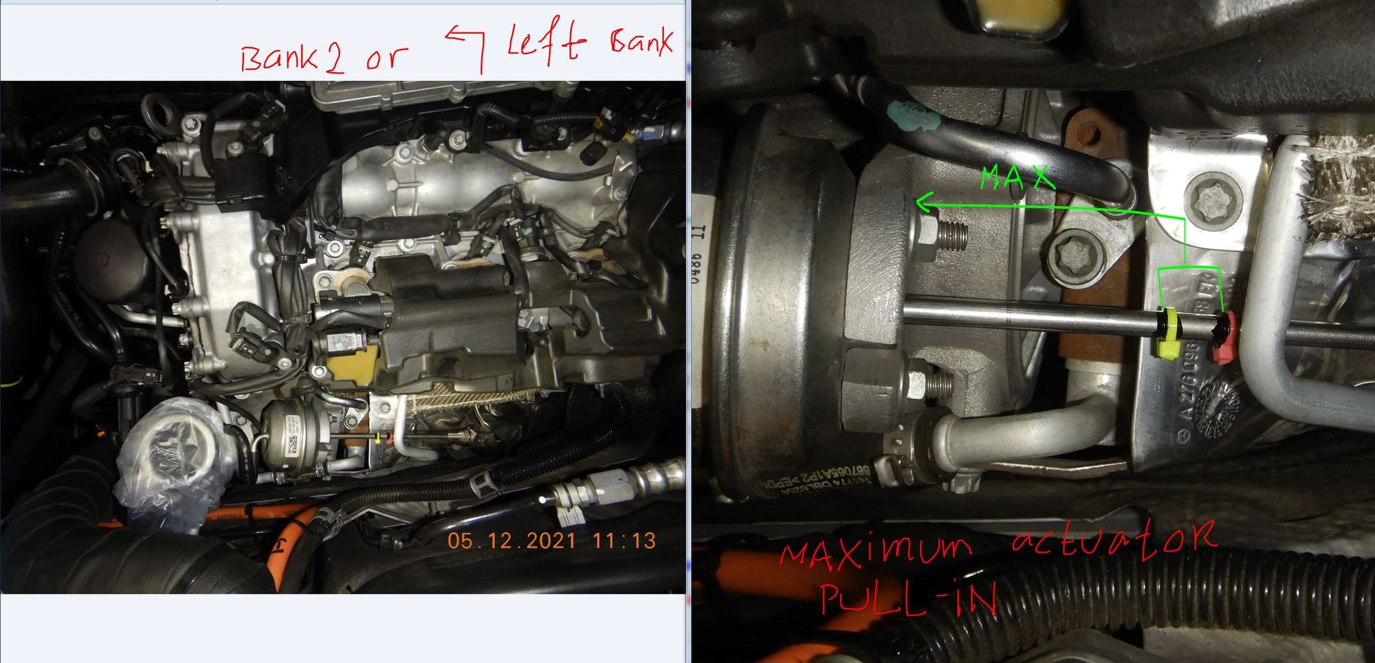

This is the vacuum actuator :
Vacuum pump is oil bath design, hence it can create the vacuum.
In common vacuum pump we use to vacuum our HVAC, it has reed valve like 2 stroke engine, open and close that reed valve.
In our car, the reed valve is replaced by the thin silicone membrane inside the fittings , the one often torn off or lost, the one for turbocharger boost control.
The big port which is for the brake booster, also have check valve, same duty like a reed valve.
Go and test your vacuum pump, at the small check valve for the turbo, if only 24 inch mercury negative, it is not good enough.
Below is the vacuum at the boost solenoid port itself the one towards the vacuum actuator for wastegate, still 27 inch Hg. Vacuum losses due to small long hose and any tee or is normal.
The vacuum pump itself , at the vacuum pump, or at the brake booster.....when healthy must deliver near 29.xx inch hg vacuum.

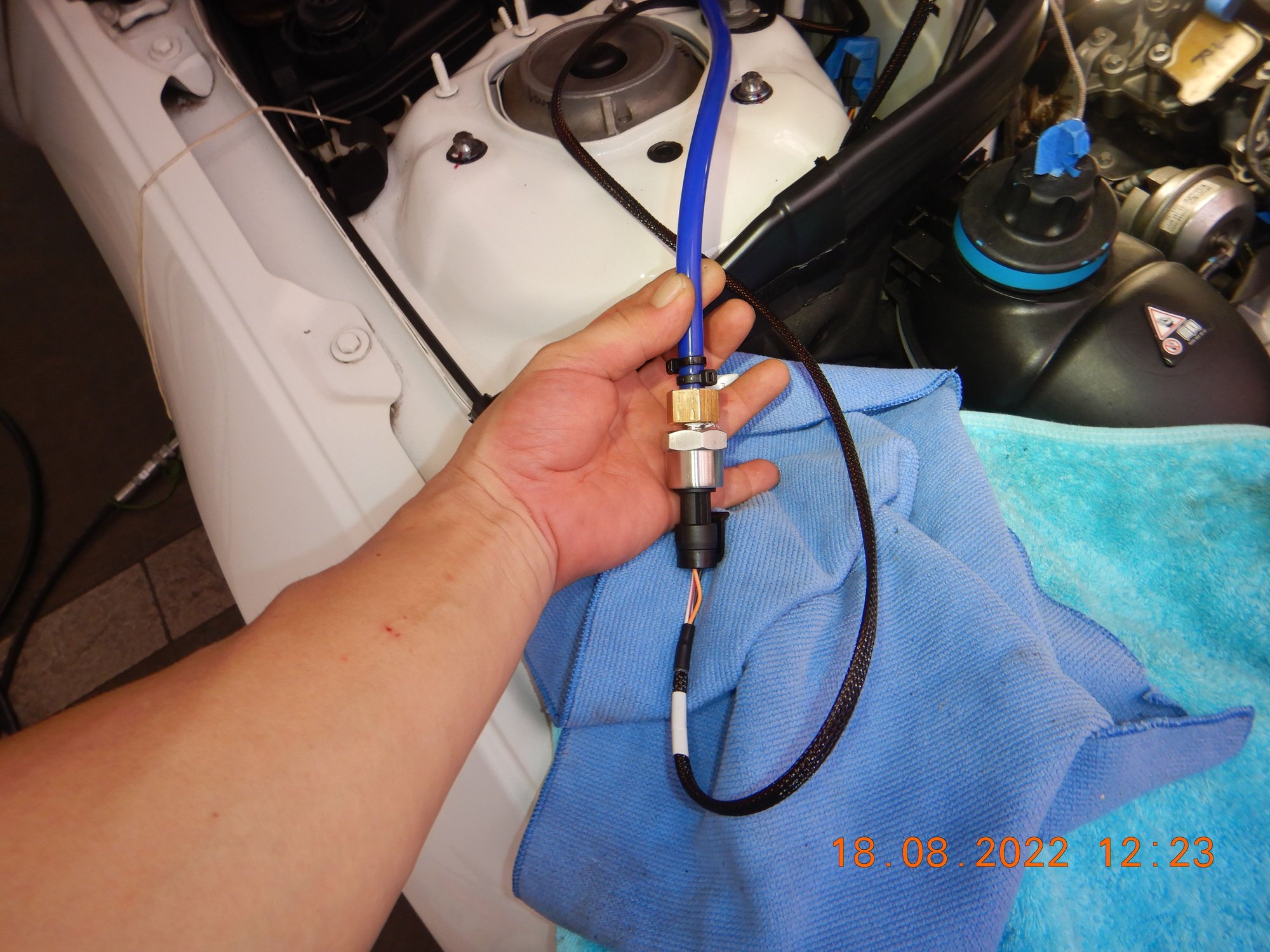

I have an absolute sensor installed at brake booster sensing port. It read the brake booster vacuum aka vacuum pump vacuum value.
Since it is an absolute sensor PSI-A, when at sea level 1 atmosphere, it will read 14.7 PSI positive.
When vacuum reaches 29.xx inch Hg vacuum, it will be zero PSI-A,

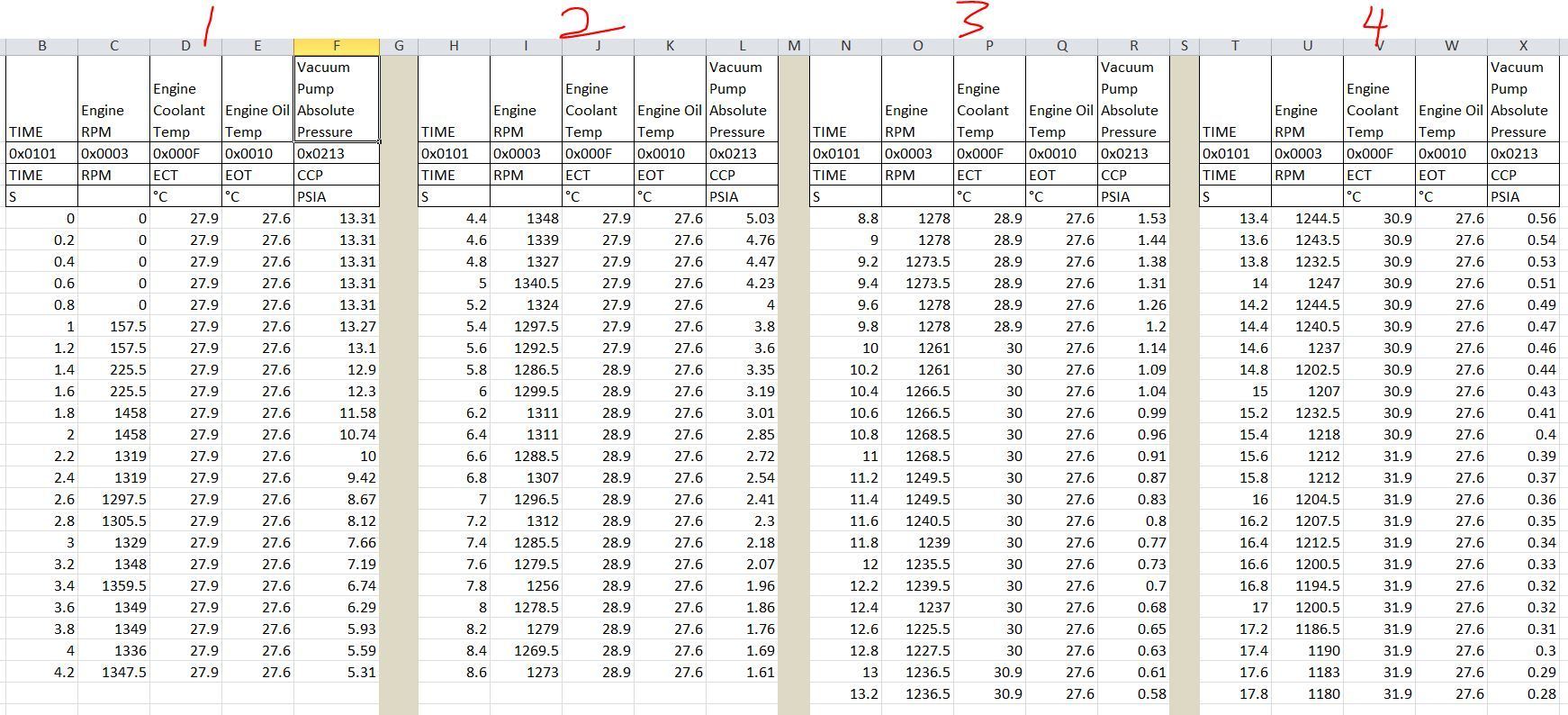

Cold engine start. Near sea level location. Some left over suction before engine kill the day before, hence pressure did not start at 14.7 PSI-A, but 13.31 PSI-A.
Log is at 5Hz, 5 data points per second.
Below is about first 90 data points only , for above graph of 130ish data points. But It easy easier read on how fast the vacuum pump is creating vacuum.

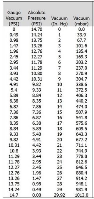

For those more comfortable using Vacuum Inch Hg unit, conversion is below.
My sensor is the 2nd row, Absolute Pressure PSI.
The sensor I use. I mount it under the black steel cross member.
This shows how much brake booster is using the vacuum reserve. All vacuum pump has Liter Per Minute rating.
The PID Banks Gauge has is CCP ( Crankcase Pressure ), thus I use that as there is no PID for Vacuum Pump

To me my brake booster vacuum is of prime importance hence I place a sensor there, not the turbo boost solenoid....but monitoring vacuum pump performance indirectly also monitor the vacuum avialability for boost controller.
The boost controller does not need super high vacuum to actualy create maximum boost or more accurately to fight pressure of the wastegate flap, I mean no need 29 inch Hg that is for sure.
For the text in blue : I plan to grab a new MightyVac today so that I can test my waste gate actuators. What do they need to hold? 5-inches?
Here is my 2021 archive :
ENGINE IS OFF - 13 inch Hg only, but even at idle there is no boost to fight.
Actually for the sake of fun and knowledge, I can do a live while under boost test, I can re-route my vacuum sensor hose if I get a suitable Tee and extra hose and see
my Right Bank wastegate vacuum actuator at WOT or any high boost of the turbo, does boost controller add more vacuum ?
2nd gear pull to WOT is good enough, in fact M276.820 comfort turbo maximum boost is not at WOT, but at approx 4,500 ish RPM .
Sometime in a week or two I will do the test, now still raining often every other day and I do not want to wash my car

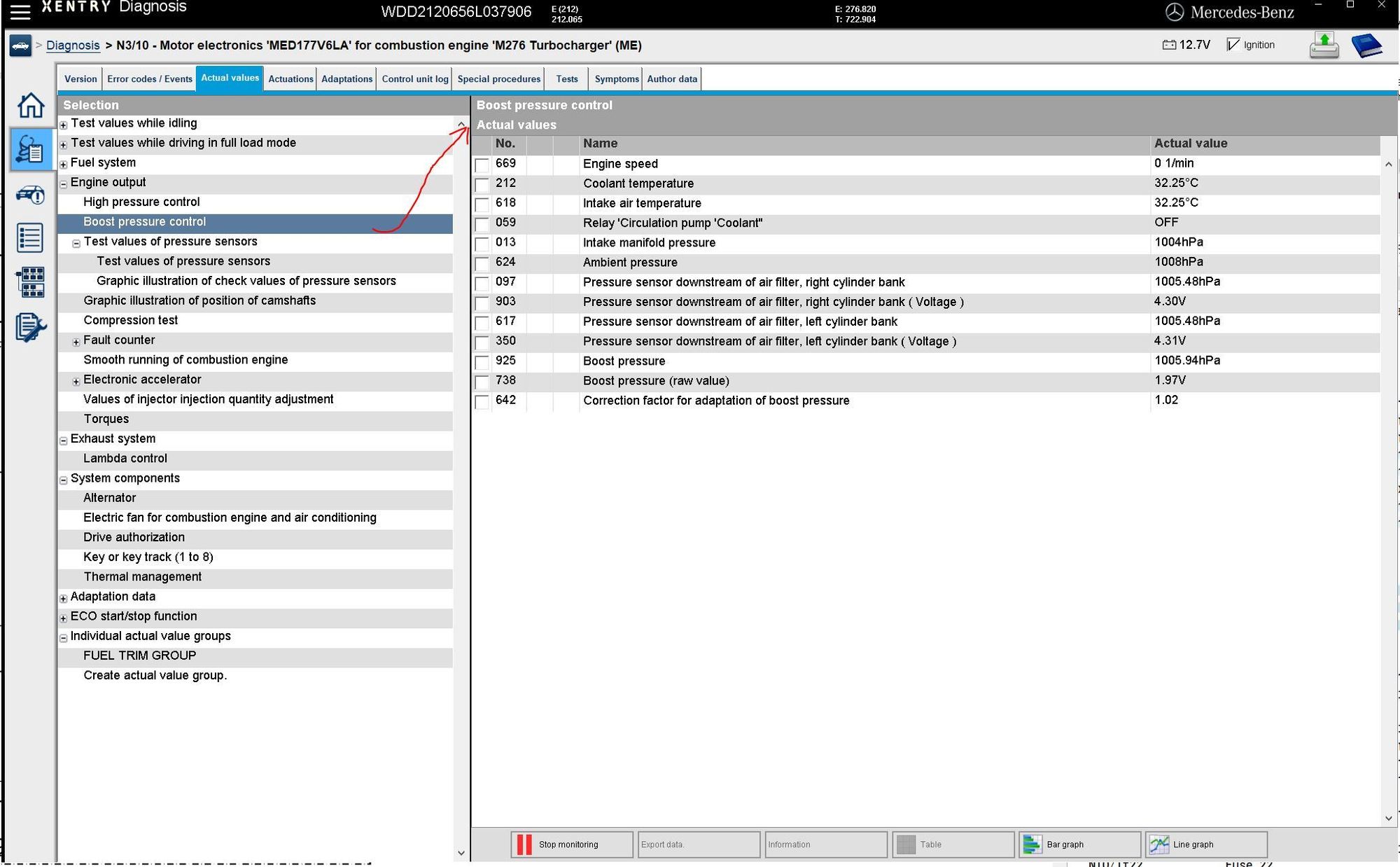

Will Xentry record boost?
Old Jun 12, 2025 | 10:11 PM
  #90
S-Prihadi's Avatar
Joined: May 2018
Posts: 6,637
Likes: 6,583
From: Jakarta-Indonesia
Sure, but Xentry logging wise into CSV file I only get to use it for VVT test, 120 seconds.
I never tried logging ( CSV) on Xentry for other parameters, only seeing it live...yes.
Driving and watching Xentry screen is not safe. I have HDMI video out recorder to do that. Thus I can log for as long as my laptop battery can last.
Or install screen recorder on the laptop where your Xentry is .

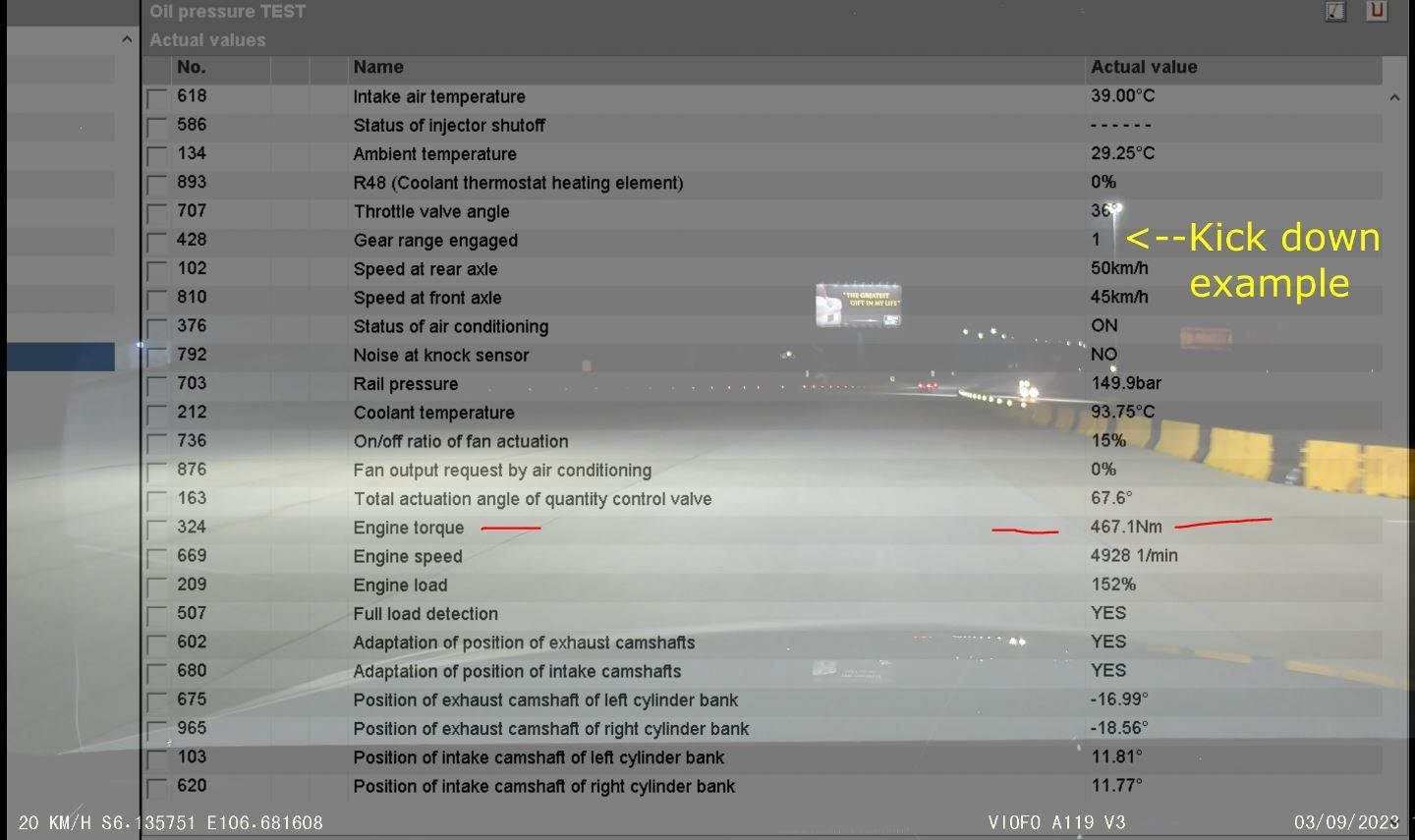

Most likely your ECM will use torque as final decision maker and not turbo boost.
This is what is done by ECM for M276.8 MED177.3.1 Stock, no modification
My engine torque is supposedly 480Nm max.
Here 1st gear, ECM will not allow above 480Nm to happen.
You can create you own custom list like above.
The most bottom one. INDIVIDUAL ACTUAL VALUE GROUPS.
Depending on your Xentry type. If you are using OpenPort PassThru, that thing is too slow to log this many parameters and is no faster than 1 data per second.
If you use benzninja.com Xentry and his reccomended C4, it is very fast and can do 4-7 data points per second, so I don't miss a glitch, if any.

Well, now I know something is up between the boost solenoid and the actuators. There was no oil found in the solenoid connections so I think I caught the check valve issue early - thankfully!
I setup my vacuum tester and found zero vacuum on the line coming out of the solenoid. Moving on I unplugged the actuators and tested the diaphragms on each one - both hold vacuum fine. So somewhere in the dual-branched line is where the problem lies.
I’m debating on replacing the line with factory parts or rigging up my own assembly. The dealership is right up the street and I would imagine it’s something they keep on hand - probably not cheap though! I can probably make up my own lines for a fraction of the cost, but I do like to keep things rather factory-like.
The car still seems to drive okay but the CEL is still on so I guess it knows. Can’t believe how power the car is without the turbochargers working properly - maybe I’ve just gotten used to it. But, she still got pretty nasty in the upper rpm’s - I guess it’s all in how the waste gate operation is setup on these engines.
