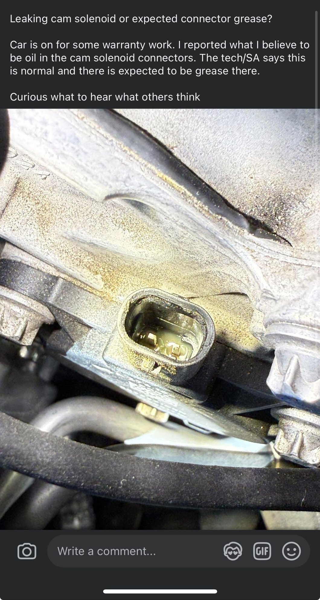

stealer says is fine.. mhm
i dont have what to say anymore for stealer /post taken from fb group/

VVT Connectors
The VVT gear solenoids are not the primary leakers like CPS. They have a cooler position on the upper timing covers.
epoxy sealed 2-pin VVT solenoids
when i reseal my cover i did not notice my cam sensors to have epoxy

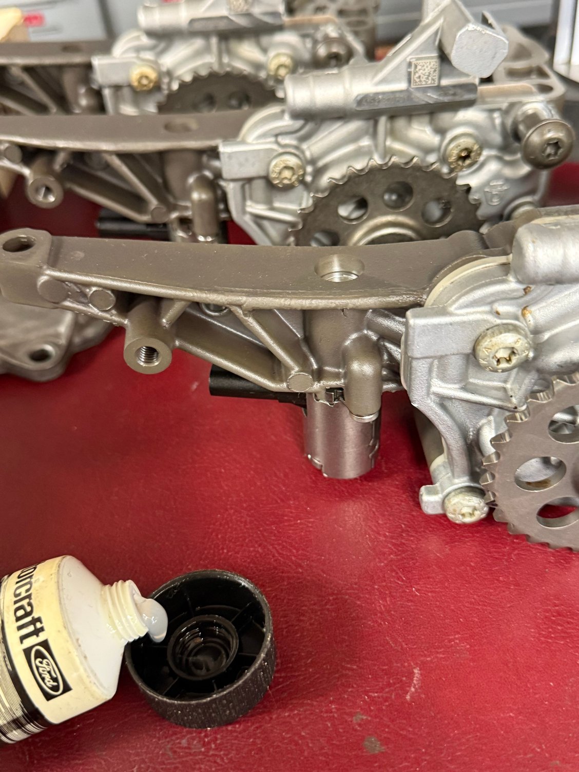

That’s probably Dielectric grease….
Mr. Goodwrench may have worked on the car.
Ford, GM and others use it in some of their connectors.
Amazon Amazon
Amazon Amazon
Mercedes has their version.
https://www.autohausaz.com/pn/MB-002...RoC-PcQAvD_BwE
Since tech and owner reported it as having “grease” consistency I.e soft. And visually, it looks like what that Dielectric Grease looks like once it has aged a bit. Consistency is similar to Vaseline, see pics below
Good Luck!

If you’re referring to my post, sorry if you misunderstood. I was identifying the type of grease most likely in the connector, since we had mentioned EPOXY. I probably should have elaborated more.
LOL! As far as using it in this application….
You may not have gotten my joke about Mr. Goodwrench (old term for factory trained GM mechanic) who probably had worked on the MB mentioned in the FB post.
Several years back GM and Ford (and others) used to use Dielectric grease on their exposed connectors such as parking and brake lights, etc... These connectors weren’t as sophisticated as what we see today, as far as sealing and would corrode over time. MB nowadays does a decent job of sealing their connectors. (Though that grease works well on spark plug boots). I believe that was probably the handiwork of an independent or DIY’er, who probably applied dielectric grease inside the connector.
Agree, It’s the wrong product for this application and we definitely need to keep Mr. Goodwrench away from our MB’s
Cheers!

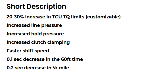

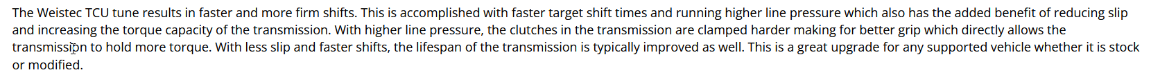

i am contemplating a TCU tune but am on the fence. Do I need it? Defintely not, but I have FOMO of having power that I can’t access in the lower gears. Opinions and experiences welcome!

Generally, I have not heard good things about a TCU tune. The good thing about adding Agility/Sport+ mode is that you are not "tuning" anything; just enabling a factory feature.
I really don't understand your FOMO comments about missing out on power.
