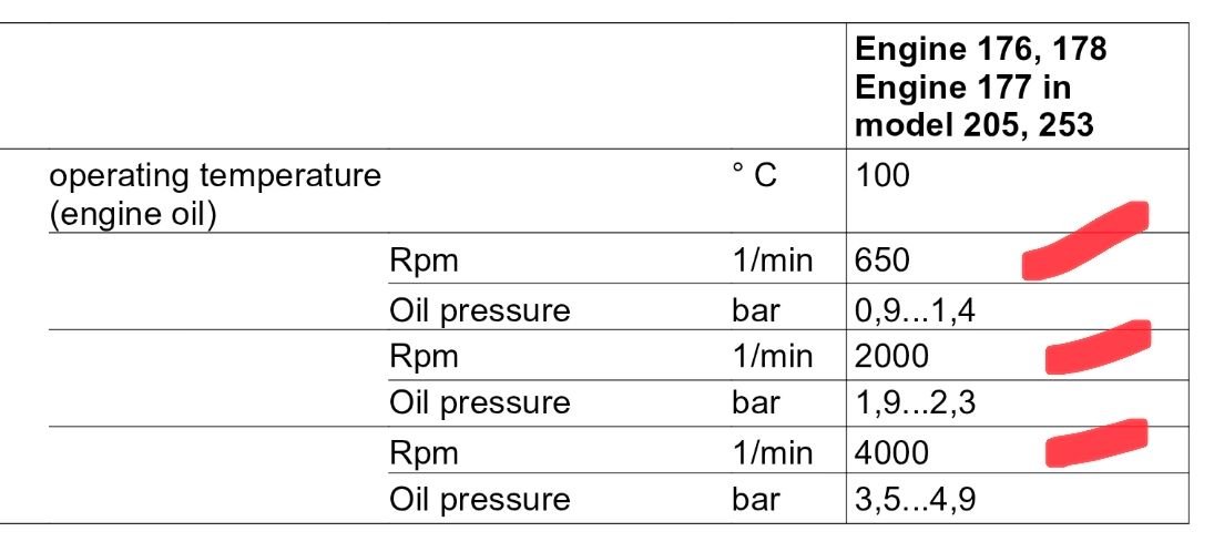

5W-50 Motul also recommended for the (C400) M276 Biturbo?. You guys are insanely informative and this is all highly interesting!.
Old Jul 10, 2025 | 05:26 PM
  #3805
KristiyanPetrov's Avatar
Joined: Nov 2022
Posts: 512
Likes: 86
From: Bulgaria
C43 AMG '17 / Stage II
I would not encourage you to jump to 5 50 straight away especially if you like to beat it on the streets, better option for you is to pick 5 40 Motul 8100 Xcess Gen II API SP / Motul Power 5w40 which is SP, im currently with Power before that i was with Xcess, so far i can say the Power keep its viscosity better (already 4k km old - 3months)
im sure Cali would give you more detailed answer to your question as he is more informative about this topic

yes, exactly !
I think it's SAFER to ramp-up your engine into more effective viscosity so it has a chance to cleanup.
Your engine may be "Mr.Clean" with homogenous compressions and you're in a hurry... then you could try 5W-50 PAO SP.
You will get improved output right away. Besides ECU/TCU mapped adaptations will be shell shocked goofy.
The key to getting reliable timings is a good seal. That means [sealed rings + oil] not [stuck-rings + oil]
Stock engine use modern low tension rings with polymeric synth oil.
That's drafty then becomes misfiry.
Leaky cylinders place too much load on neighboring cyl. that cause wear on high output load.
With sealed cyl. the stress forces are shared on all cyl. More predictable power is available at lower Rpm.
With the right setup, the stock lean misfires are transformed into pressure sensitive throttle.
Avoid pushing your engine if it's vibrating unbalanced. Help it seal.

No. You want the solenoid to be in the disabled state. If you've been changing your oil every 5000 miles, it is likely there is no problem. But, IF the solenoid is stuck, disconnecting or connecting the wiring will make no difference. If you want to be absolutely sure you are OK, manually measure the oil pressure using an external gauge. Post your VIN or at least the COMPLETE model number of your car (like 253.XXX) and I will look up the procedures. But just for awareness, this is how the oil pressure is measured on the M276 engine.
I have a 2020 GLC 63 SUV. I'd love to verify my oil pressure manually. Is it possible for you to post the directions?

TESTING OIL PRESSURE
Originally Posted by OMG 63
I have a 2020 GLC base SUV. I'd love to verify about oil pressure manually. Is it possible for you to post the directions?
MY:2020... Look at sourcing a cheap dummy-load to cancel CEL.
The pressure sensor port is located near the base of the oil filter: 12Psi Min straight up to 60Psi Max.
> Pump pressure Testing...
Sweep RPM from 650 to 2500.Rpm
MOD-0 Stock
MOD-1: 5W-40
MOD-X: 5W-50
Find the various Rpm that produce 25 or 30Psi.
here's from the WIS
File Type: pdf

Originally Posted by JettaRed
here's from the WIS
Wow, thanks for providing this! It's extremely helpful!

WIS OIL PRESSURE
Stock provides the following oil pressure:
Engine M176/177/178 oiling
> Stock oil pressure scale:
  • 650R : 15Psi is Min pump output
  • 1.75kR : 22Psi accumulates heat
  • 2kR : 30Psi is remotely effective spraying
  • 3.5kR : 50Psi solenoid switches to normal pressure
  • 4kR : 60Psi is Max. pressure relief
- The key is to hide the pressure drop of squirters opening low enough to still get effective spraying around 1750R driving
- Dry pistons accumulate heat that burn oil carbon into rings groves.
- Stuck rings detune GDI engines timings with lean misfires.
