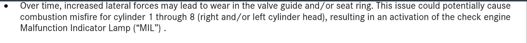

MB warranty speaks of valve guides wearing out... prematurely between 60k to 100k.Mi.
prematurely worned out guides
prematurely worned out guides cause valve wear to leak
CRC contribution :

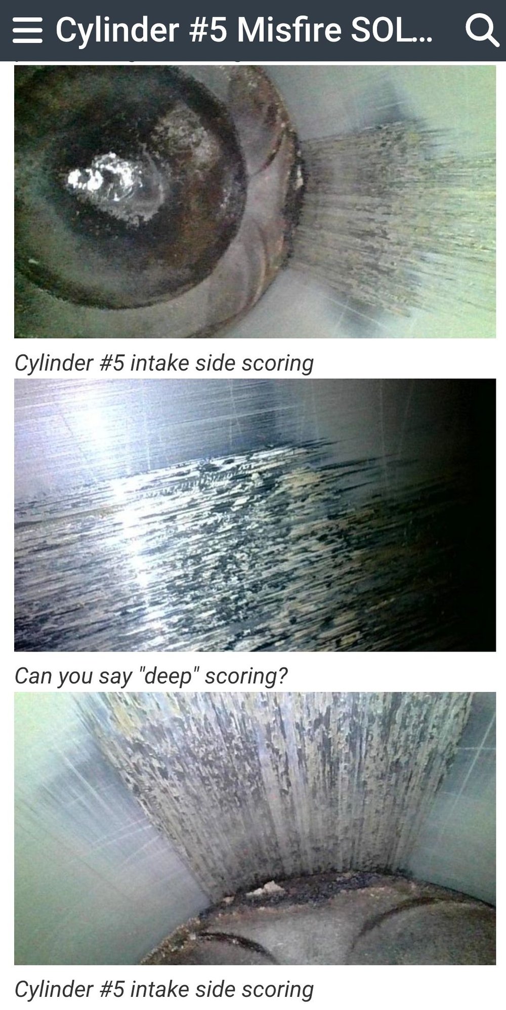

> TRUE CYL#5 THREAD:
The reality from techs/cts is exposed here... no need to rewrite it
wasted Cyl.5 bore
wasted Cyl.5 bore (144)
Reported repairs are from $15k to $35k USD.
Therefore drafty misfires out of warranty is most likely terminal coils & injectors useless.

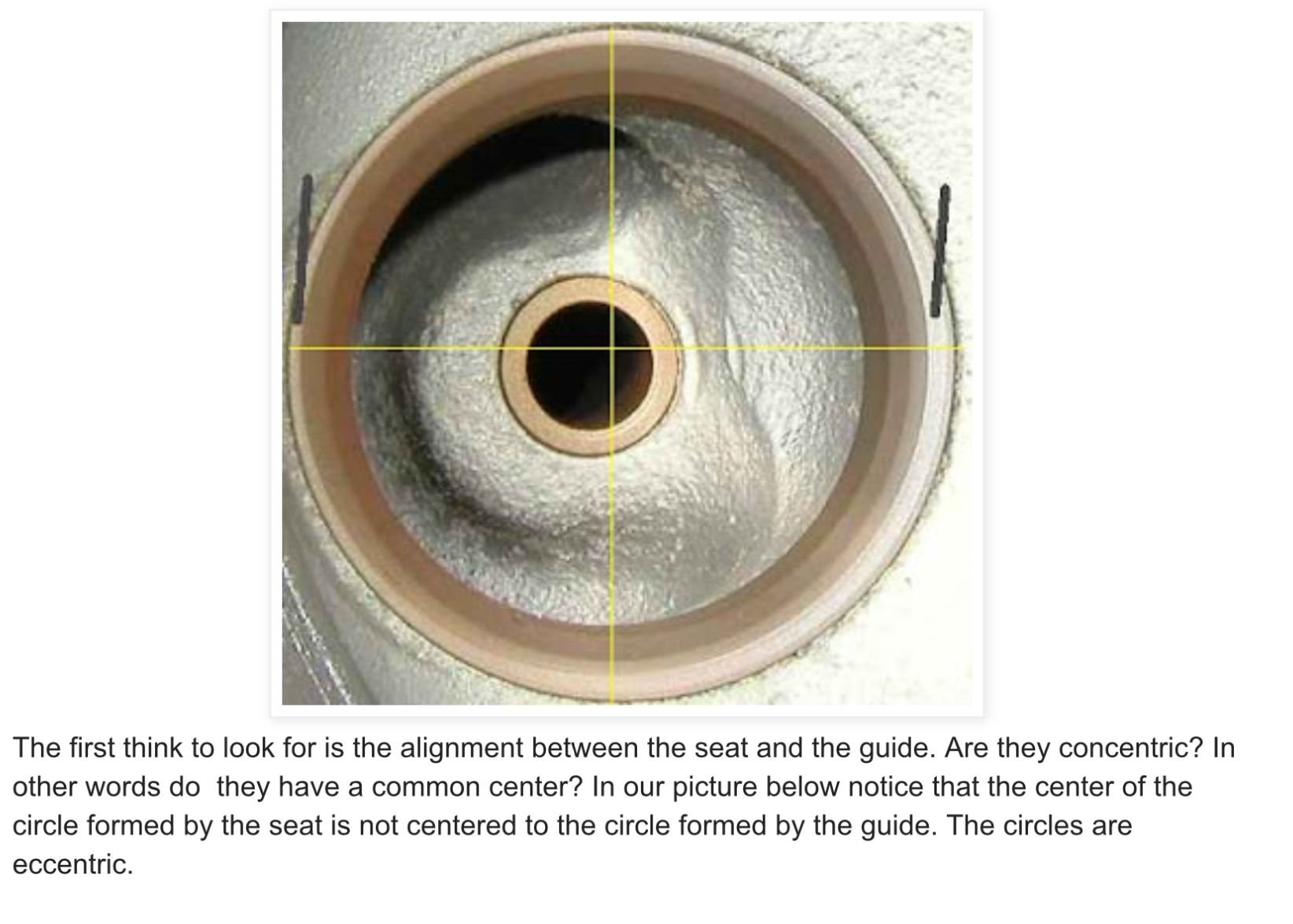

WRONG……
More oil in the valve guides would create more carbon on the backside of valves, if anything. You couldn't possibly deliver enough oil to get past the valve guides seals to make a difference in a normal operating environment. You realize there are valve guide seals right?

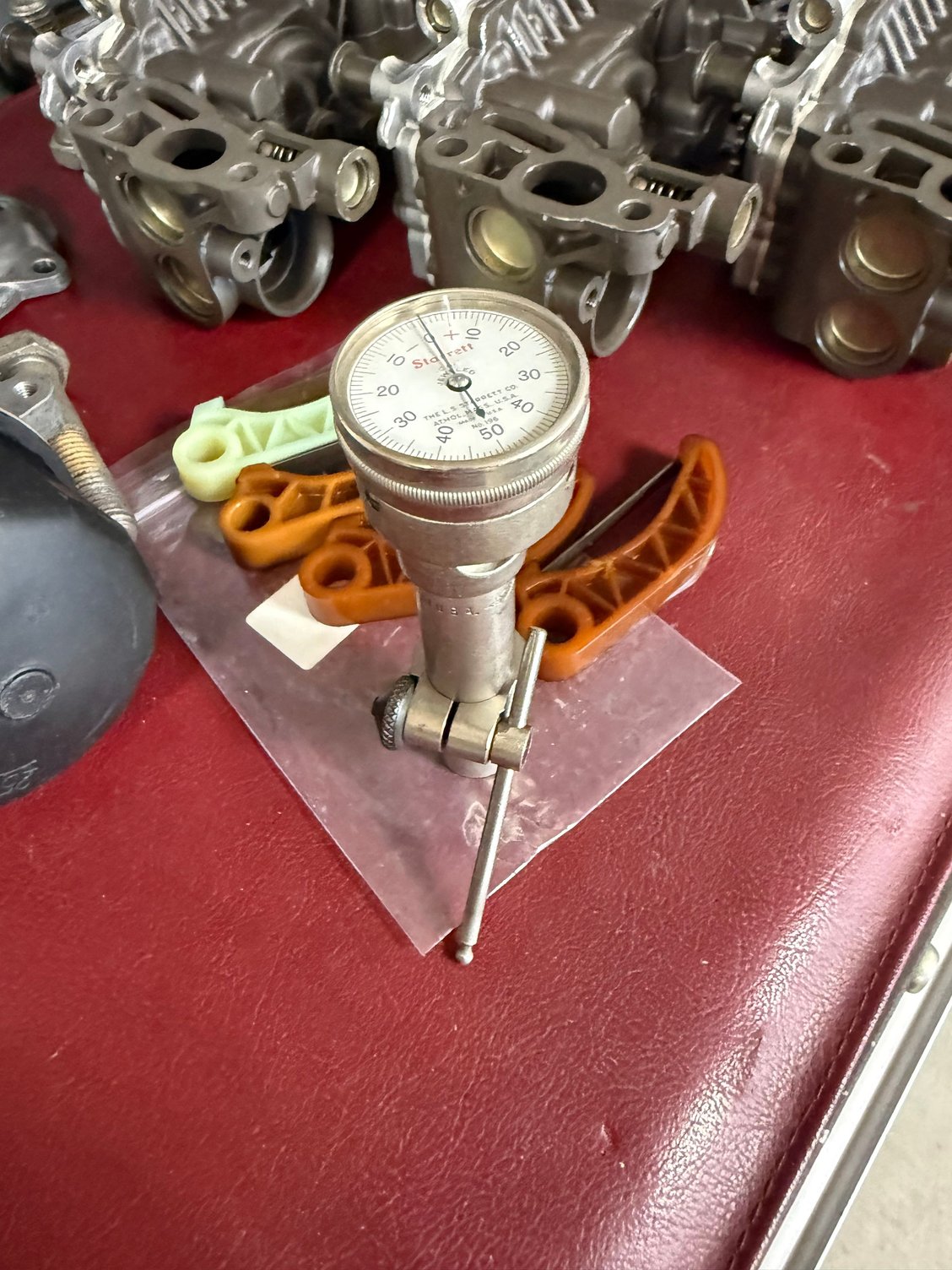

Hope you understand how the VALVE SEAT CONCENTRICITY ISSUES related to machining (or materials) of those seats LED TO VALVE GUIDE WEAR. This is what cased the misfire in the cylinder that destroyed it. See pic below, now imagine the side forces generated by this misalignment. Abnormal guide wear is a side effect of this misalignment.
NO INCREASE IN OIL PRESSURE WILL CHANGE THE CONDITION THAT LED TO THOSE FAILURES
Cali serious question. I know you’re a computer guy but,
Have you ever taken apart an engine?
(I think it’s a good idea for every DIY to take apart at least one engine to understand some basics)
M278/M276 valve guide seals,
This is a valve seat concentricity gauge manufactured by Sioux used to measure runout in the seat.
how does mb calculate the expiration date of extended warranty MY 2015 and 2016? e.g., is it year end?
