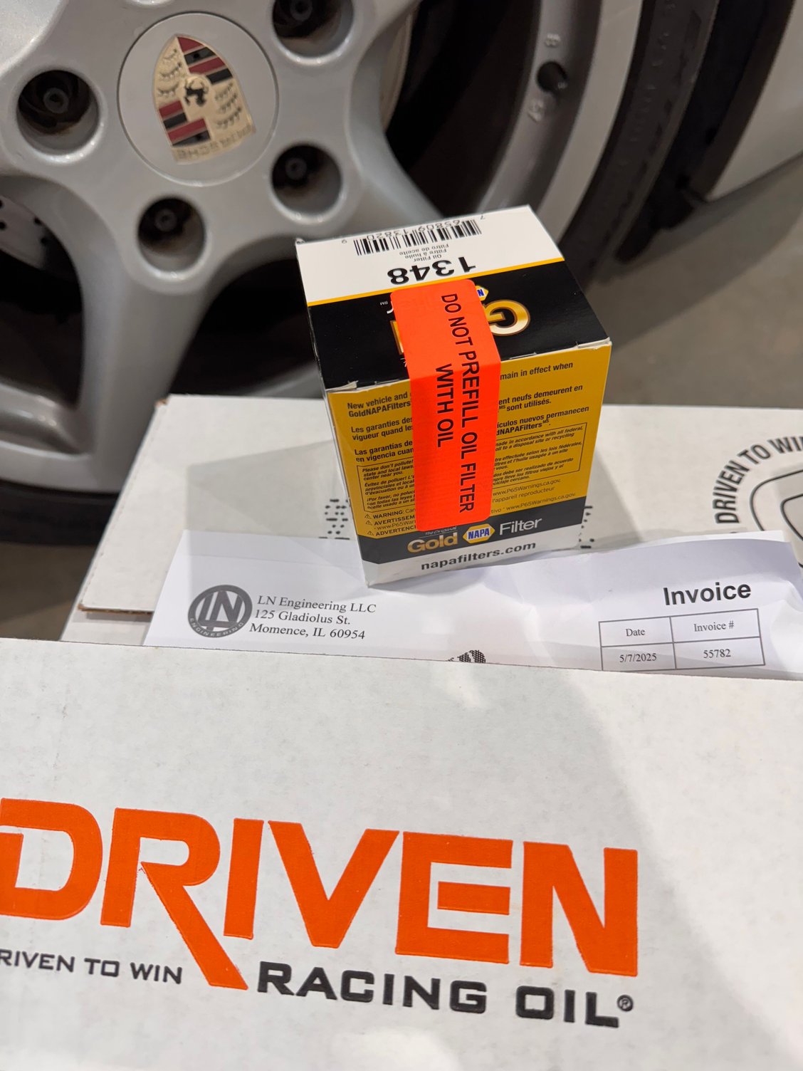

Oil change kit from LN engineering for my 911. Note the tag on the filter box.

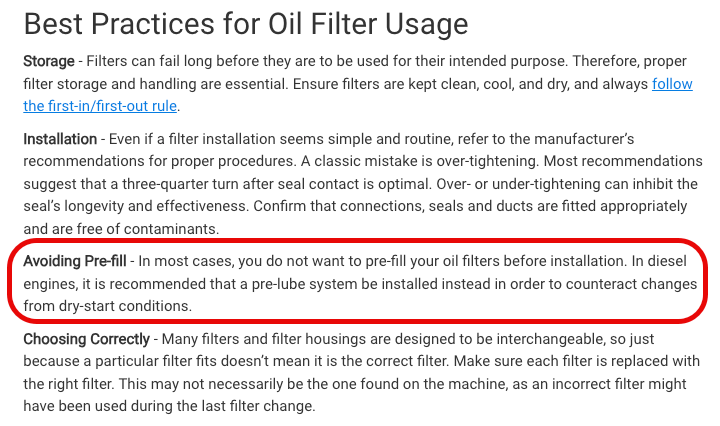

Something I found that supports the tag on the filter box. Curious, but is the filter inverted on your Porsche?
https://www.machinerylubrication.com...filter-anatomy
no, it's vertical and probably not relevant to our discussion but I found it interesting nonetheless.
