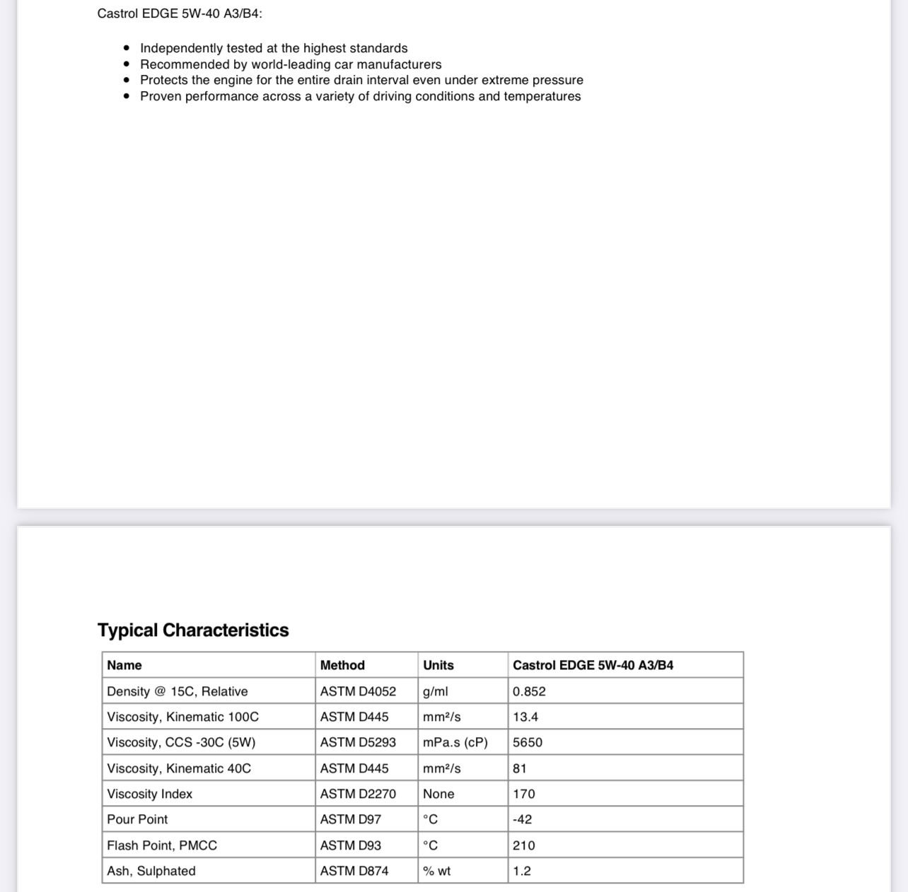

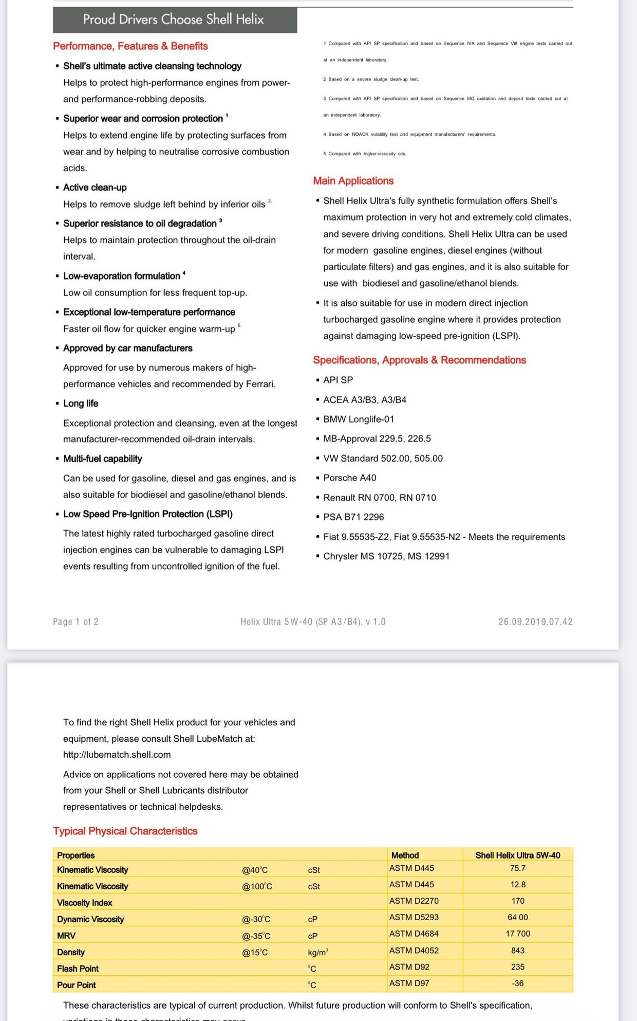

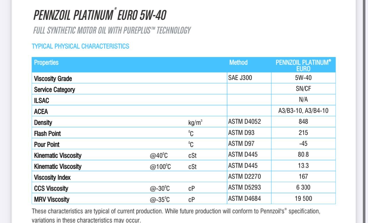

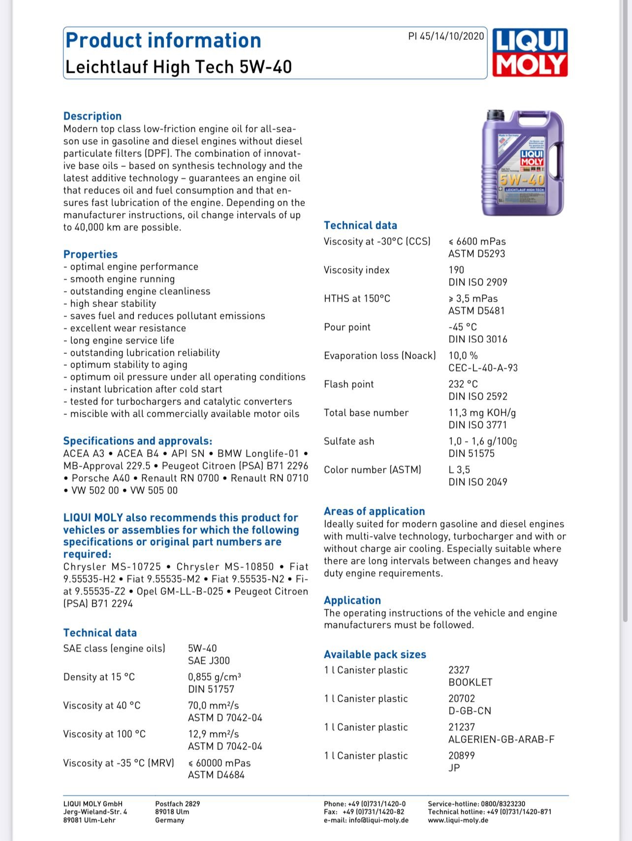

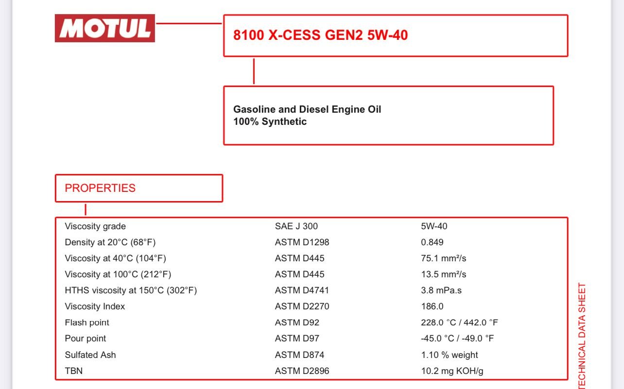

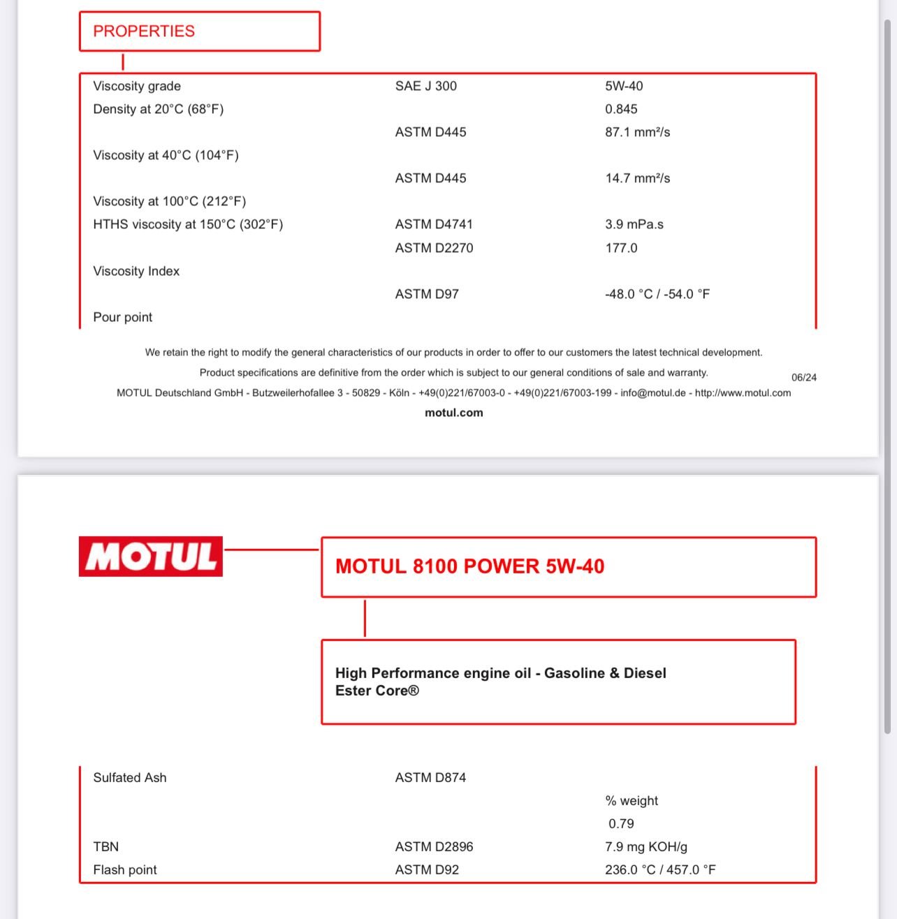

Good job gathering stock w40 viscosity specs....
Side by side we see LM flash temp is actually better than Helix...
Next step is test drive your favorite MOD-2: 05W40 oil.
You may notice improved results until enough viscosity is sheared.
This will be your invitation to slowly upgrade towards MOD-3 viscosity while leaky piston rings are still stuck...
viscosity and flash point I’d say is crucial factor in considering.
I’ve only shown the Liquimoly LHT due to Molygen and Synth is “lesser” quality from data standpoint IMO.

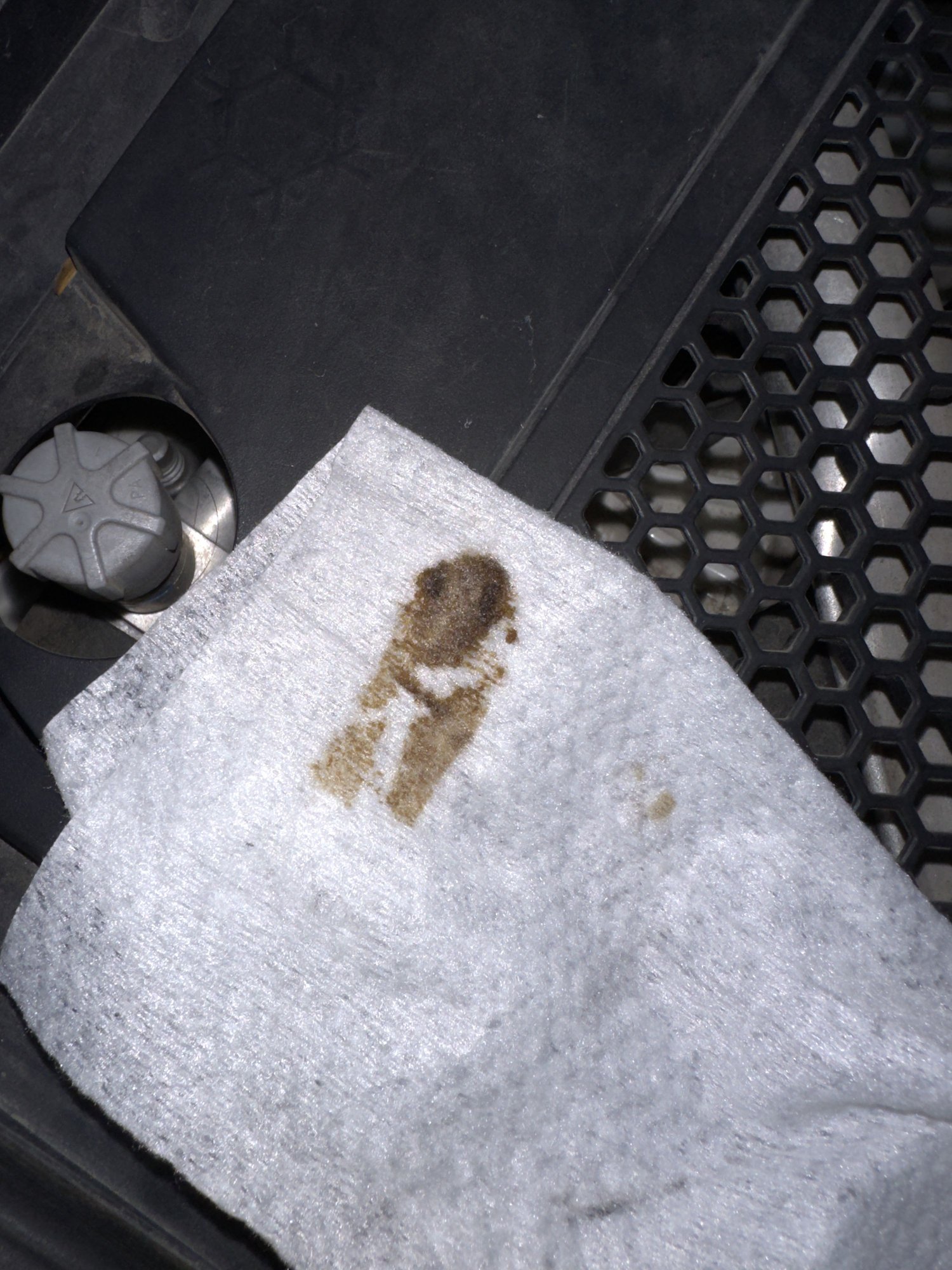

3700km since last oil change with Motul 5w40, i have to say that the oil looks pretty clean on the dipstick and on the bottom below the MIN is black even when the oil was changed was black not sure why so disregard the dark oil color on the top of the image
