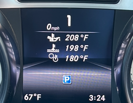

Originally Posted by mb1701
-6F here in NH yesterday. No noticeable difference in how my E550 (M278) started/warmed up unplugged, vs plugged (previously) under same conditions. I drive with heat off until coolant temp reaches 90 (indicated) so engine reaches operating temp more quickly.
That may seem logical, but is it noticeably faster?
Also, using the instrument gauge is imprecise. Or, do you use the AMG menu in the IC?
If using the AMG menu, you want all the temps, oil, coolant, and transmission, if you have it, to be in the white before driving the car hard. Not just the coolant temp, which is in the white at any temperature.
Understood the "indicated" temp is not really accurate, but representative of overall operating conditions.
Seems to have some benefit. When it's that cold, if the car isn't fully warmed up and heat is on while stopped or coasting the indicated temp will actually drop (same in other cars).
Sure, I’ve seen that before, even in the summer. The idea is that you drive mildly until fully warmed to operating temperature, and actually drive versus sitting idling or coasting.
Are you using the AMG menu or the temperature gauge? The temperature gauge is highly inaccurate. There’s discussions elsewhere where the true temperature doesn’t display until you approach overheating. If you use the AMG menu, you will see the coolant temperature fluctuate a lot. If the gauge did that, as well, you would have most drivers freaking out. Mercedes is not the only one to do this. I think virtually all car companies display coolant temperature the same way.
