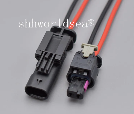

Old Jan 25, 2024 | 04:53 PM
JettaRed's Avatar
Veteran: Army
iTrader: (1)
Joined: Nov 2016
Posts: 7,847
Likes: 3,496
From: Maryland
or if you disconnect and want to protect the solenoid socket
To protect the socket AND wiring harness plug, get something like this for WAY LESS!!! Less than $4.00 shipped.
https://www.aliexpress.us/item/32568...Cquery_from%3A
