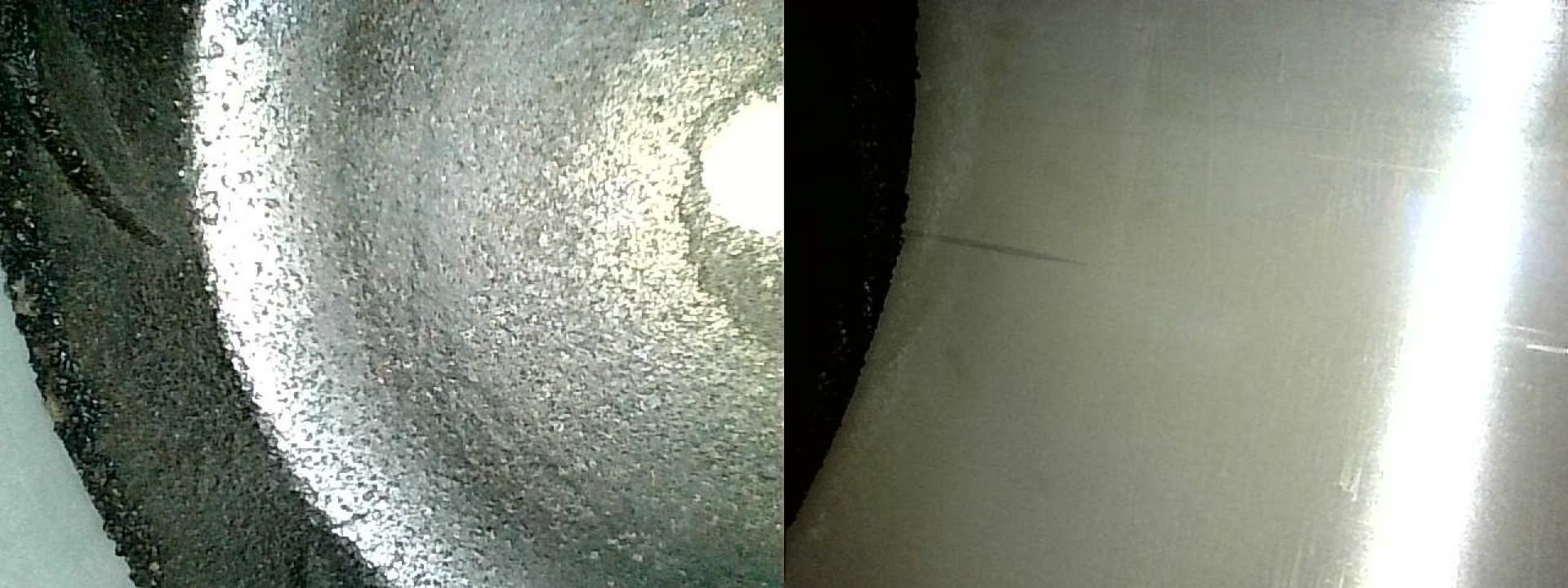

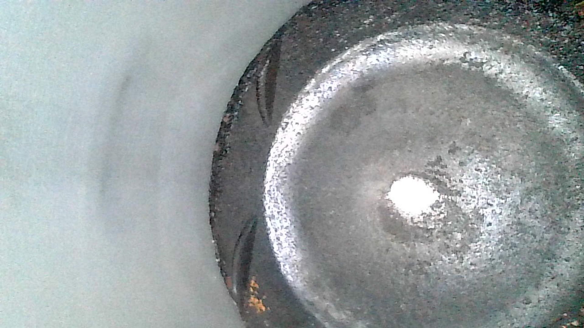

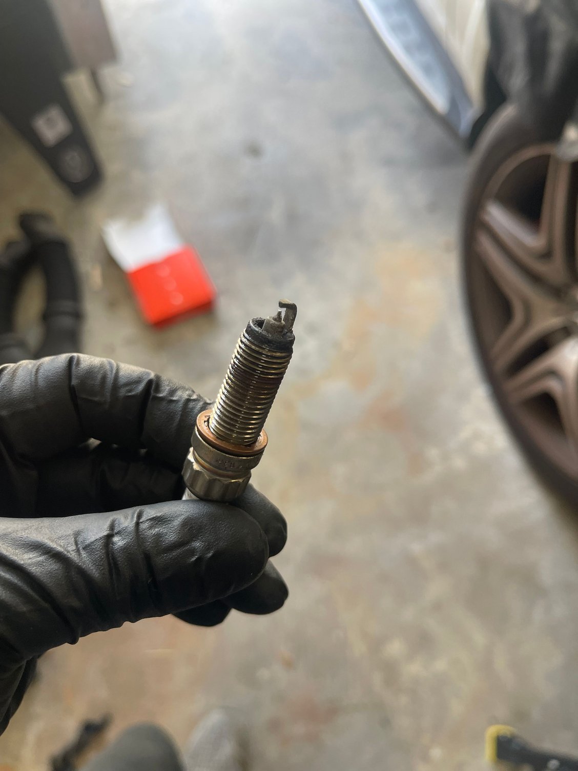

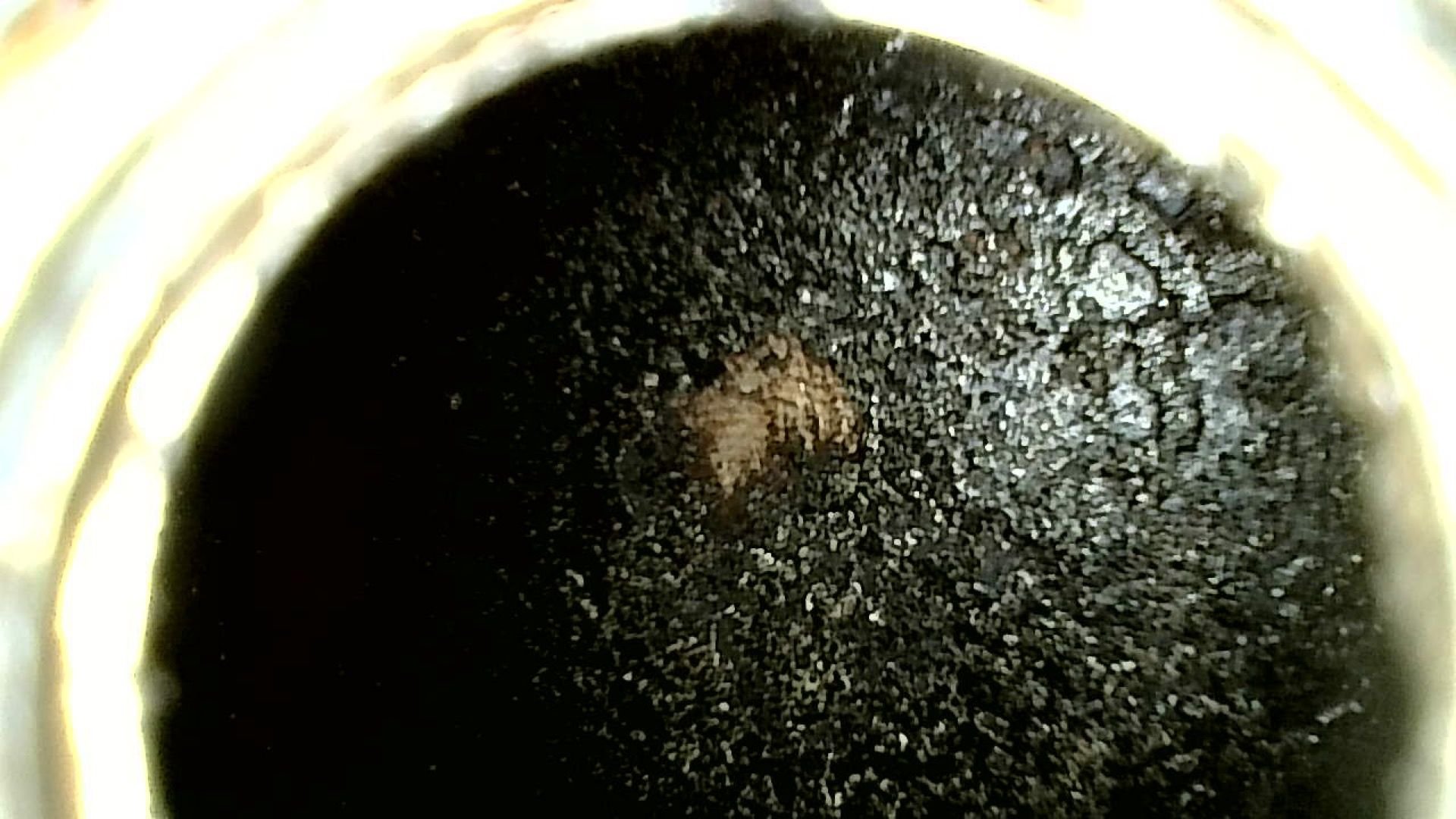

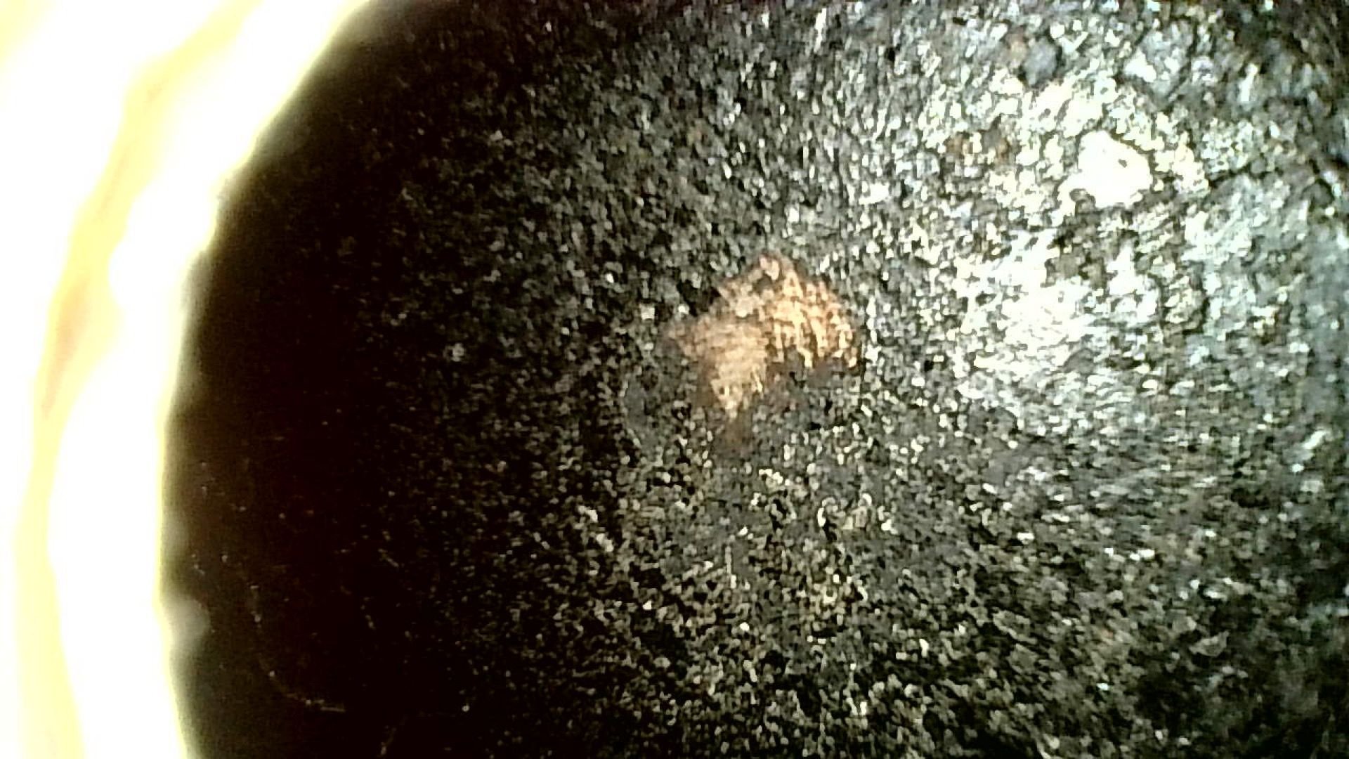

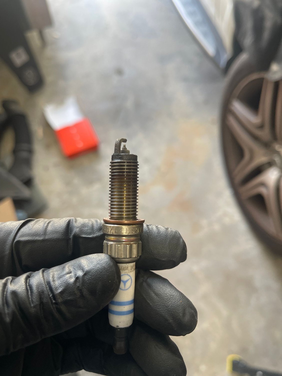

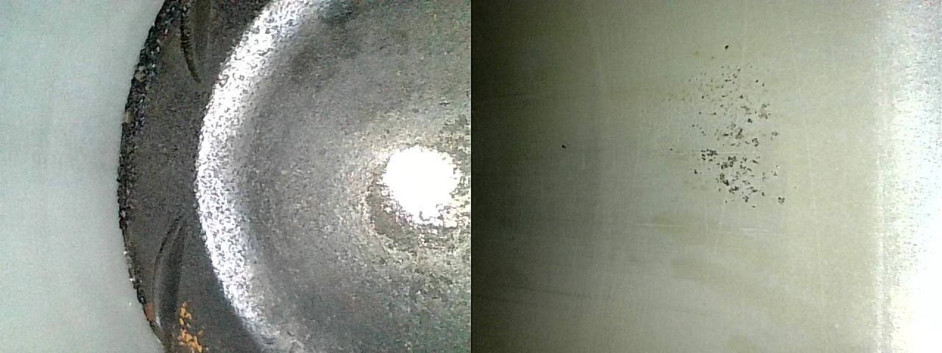

I have a 2015 GL63 (M157) with about 99k miles. I just did the spark plugs on them. I went ahead and stuck the camera inside all of 8 cylinders and noticed cylinder 4 and 8 with some oil. Even the spark plugs had some oil residue. All the other cylinders were dry with spark plugs. Can anyone help me to help reduce that and if there is something I need to look into?

-- What conditions are cylinder walls in:
slick/scored??

not sure how the oil is getting in. All other cylinders were bone dry as the spark plugs.
The cylinder walls were pretty good. No scoring like I’ve seen online at least.
It may use up to a quart or 2 every 5-6k miles. Depending how I’m driving it. This last time I did let it go a little longer on mileage.
I using Mobile 1 0W-40 oil.
The car drives good. Pulls and sounds good.
Replaced boots. The coils were all good. I did not measure gap on the old plugs. Just the new ones that I installed. Torqued to spec.
Thanks.

lucky... CPV
@GL M157
The difference between normal cylinders and 4/8 are so distinctly different... I think we have reason to suspect a known "oil provider".
The cylinders wall are not perfect but are rather good overall.
standard leaky rings... not huge
standard leaky rings... normal (not huge)
What do we know about your Crankcase Positive Ventilation status... replace CPV components!
I think it's feeding your lost 2Quarts through the INTAKE or something else is feeding Cyl.4/8 from the top, not from the walls.
Luckily, the failed CPV is actually helping keep crankcase pressure lower thus helping keep other cylinders cleaner the way they are.
While replacing CPV replace HPFP "ROLLERS* preventatively to preserve your Bank1 camshaft and chain.

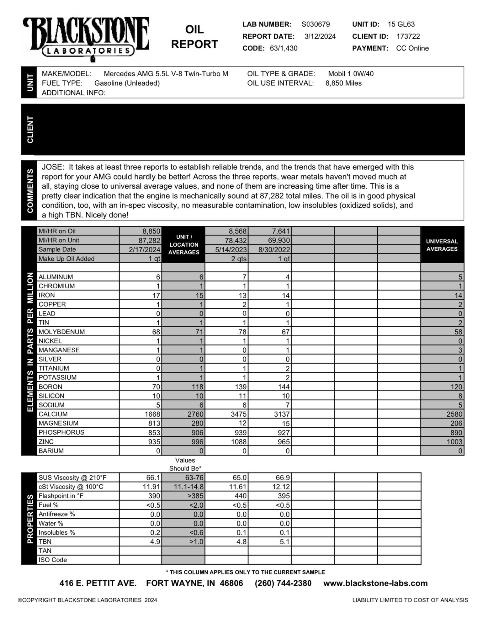

Jose, I've reviewed your oil lab test.
As lab noted numbers are in expected range (viscosity, aluminum, moly/boron/zinc/calcium) for stock 0w40.
Engine oil selection being a personal choice, the stock is working well.
You may want to... shorten 8.5kMi oil service to half that.
This would preserve the oil properties, preventing calcium sludge and viscosity shear.
​​​​​​Improving heat mgt will preserve components life including new CPV.

Oil in cyl 4 according to benz is a sign of the oil separator/ breather on the passenger side rear of the head needing replacement. A bad unit will put oil on the pass side of the intake manifold where the cyl that gets the oil is first in line, cyl 4, but enough i can see it spreading to the other side of the manifold being sucked into 8 aswell. Good place to start.
