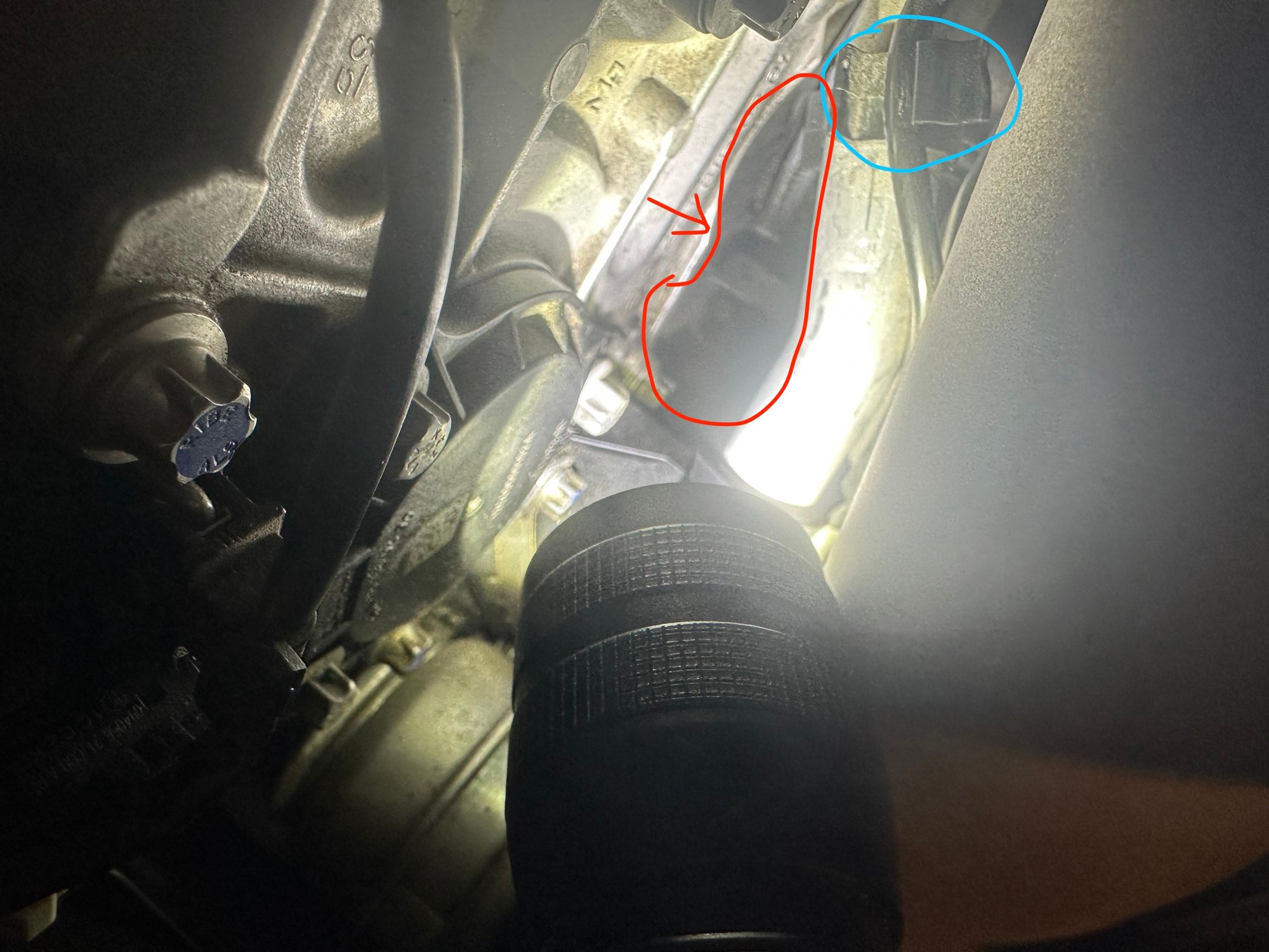

Thanks for the additional info, I wasn't aware the cover was pure magnesium... interesting choice by AMG/Mercedes there. Are more reliable upgraded replacements available for this part or do folks just lightly sand the bad seal like Tasos? That's actually my next job and maybe I should make a new thread for this, but while we're on the topic I believe that cover is leaking at the bottom on the passenger side.
A bit hard to get a picture of, but I don't know what else this could be, it's basically got a film of oil right below the cover. I circled it in red.
Also, circled in blue, does anyone know what this vacuum line is called or specifically that clip on what I believe is a coolant line? It looks like mine is broken.

The blue circle appears to be the EVAP purge line…? Does it travel to the circular cup-sized container by left headlight?

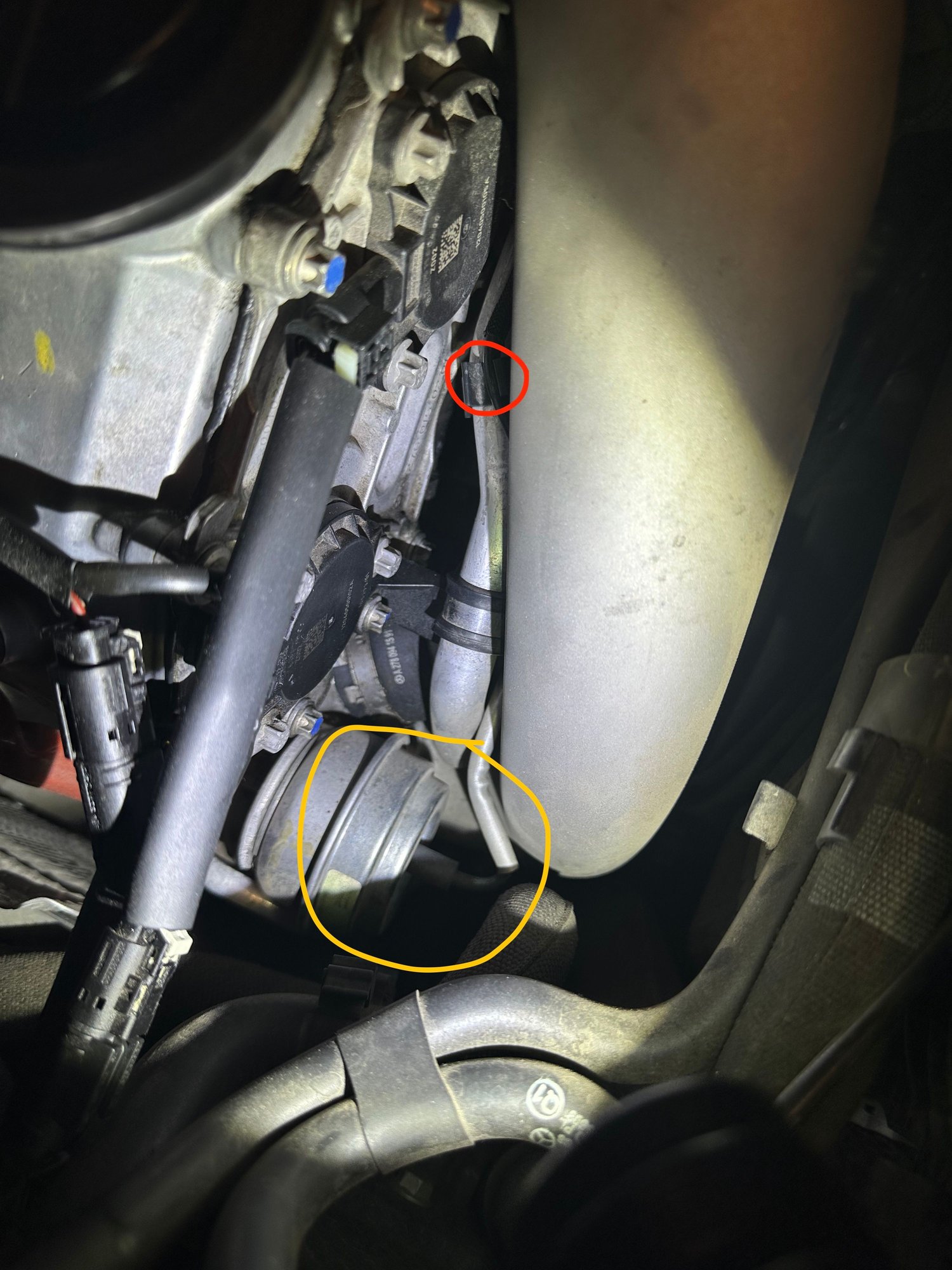

Thanks for the response, sorry for my delay it's been busy.
To answer your question, I believe so, if left = passenger.
Attached is a more zoomed out picture, the small line that attaches to that clip (circled in red) connects to what's circled in orange.
In the meantime I've been looking for the best way to find this information on my own as well as factory repair instructions, and it looks like I need to get Xentry + WIS. It seems like BenzNinja is the way to go with this?
After wiping down the seal on my passenger front timing cover, it seems like it's definitely got a slow seep. My next project is to figure out how to replace this DIY.
