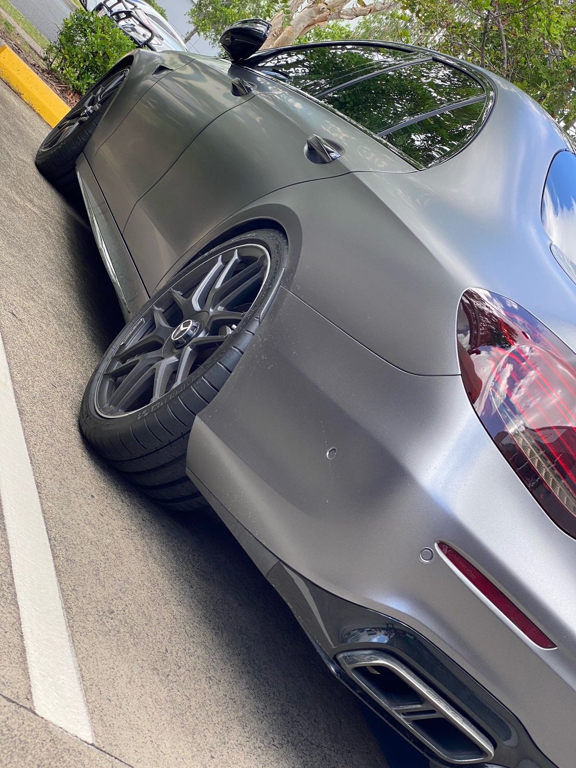

Got my suspension lowering module from @loweredbenz *IG and FB page
Great device, setup is easy and clear, despite the large instructions takes a few minutes. Received the package a week after shipping, shipped from Belarus. The seller answers quickly and clearly, thanks him for patiently answering all my questions.
