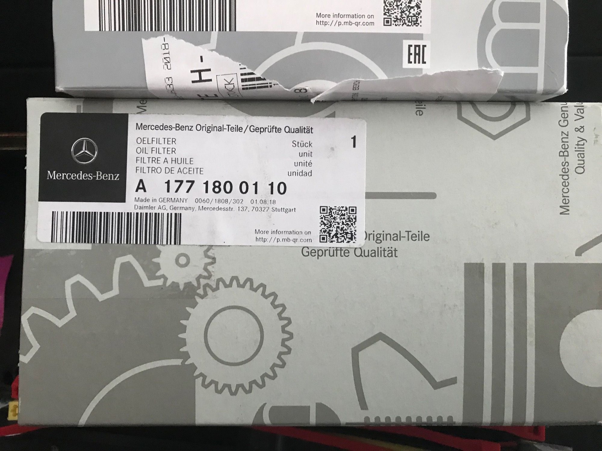

You should change the plugs and or Orings on all the plugs and filter cartridge cap. Here are the part #s including a complete filter cap and assembly.

2018 E63S
Good write up. One question, why two il filter part number? Did you need to buy one of each and see which version came out?
Old May 10, 2019 | 11:02 PM
Lucabratsi's Avatar
Joined: Jun 2009
Posts: 78
Likes: 38
2019 E63S Sedan 2014 GL450
Hello,
The first part number is for the filter and the cap Oring only. The second part number is for a complete filter, filter cap, and center stem. If you want to replace everything, use the second.
