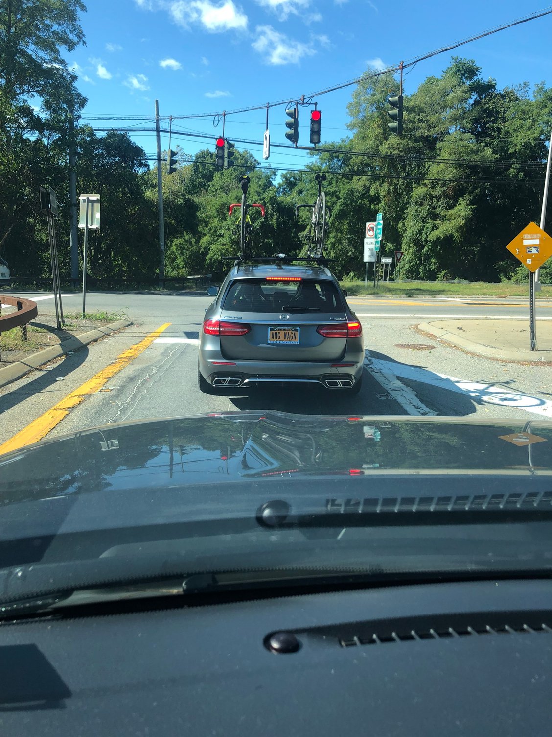

Pretty slick... but you gotta get the reflectors off that bike! I use flashing LED. I've always been a wagon guy for the sake of bikes, but still use the tried and true roof rack... A friend sent me this pic saying: "you should be friends with this guy." Yup.
