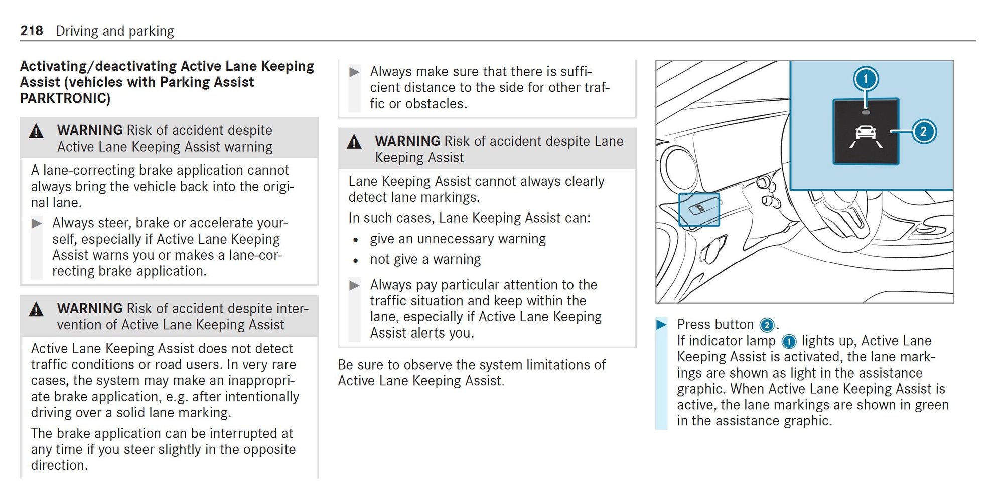

It's a simple binary ON/OFF
Pls see pages 216-218 in the manual...

Old May 26, 2020 | 06:31 PM

I wish you could turn off just the braking feature, I don’t mind the steering self correction but the xx braking function is way too intrusive and borderline scary at times!

The MB lane keep assist doesn't do steering corrections. It has two stages. If you start to come close to the lane markers it slightly jolts the steering wheel to alert the driver that they are about to cross the lane markers w/o indicating. If the driver ignores the warning, then the inner brakes get applied to steer the car back into the lane. The brake application is the means by which it steers the car away from the lane marker. At the same time it jolts the driver back into paying attention. It's actually quite effective. If you cross lane markers without first indicating, then you only have yourself to blame. If you are properly using the indicator it won't apply the brakes when crossing the lane markers. One small annoyance I have with the system is that occasionally it seems to slightly mistake cracks and other lines in the road as lane markers and I get the minor steering wheel vibration, but otherwise it works pretty well. I only get the brake application if I wasn't paying attention and the car is about to drift into the other lane.
