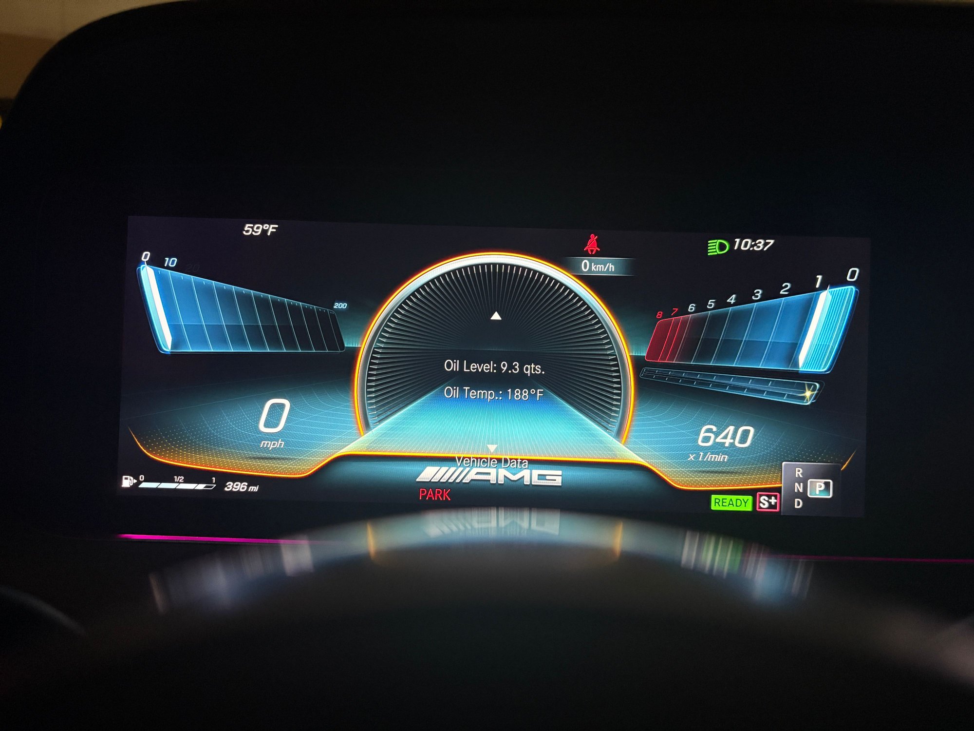

Use the level measurer in the Workshop Menu accessed by holding down the back and ok buttons for 10 seconds while the ignition is on

it's common for me to see 230-235 deg F oil temps just cruising in comfort at 70-80mph and 180 deg F gearbox temps. it sounded a little high to me, but seems common in the M256. in spirited driving it stays very stable and isn't any higher so seems that the oil cooler is working great.
i have also noticed when measuring through the service menu (regular bar, not the volume measurement) that it will show at the low and high end of the green range and is fairly random because i don't recall being on a hill or something. for me if it's in the green, it's good. i have ~5500 miles since my last oil change ~11 months ago by the dealer i bought from as a CPO (CPO service calls out MB 229.5 SAE 5) and will be doing the plugs and oil at the end of the year for the 5 year plug maintenance. i plan to send a sample to blackstone for peace of mind as it's very cheap.
i had the transfer case and both differentials serviced this year at ~33k miles and will do the gearbox next year at the six year mark.

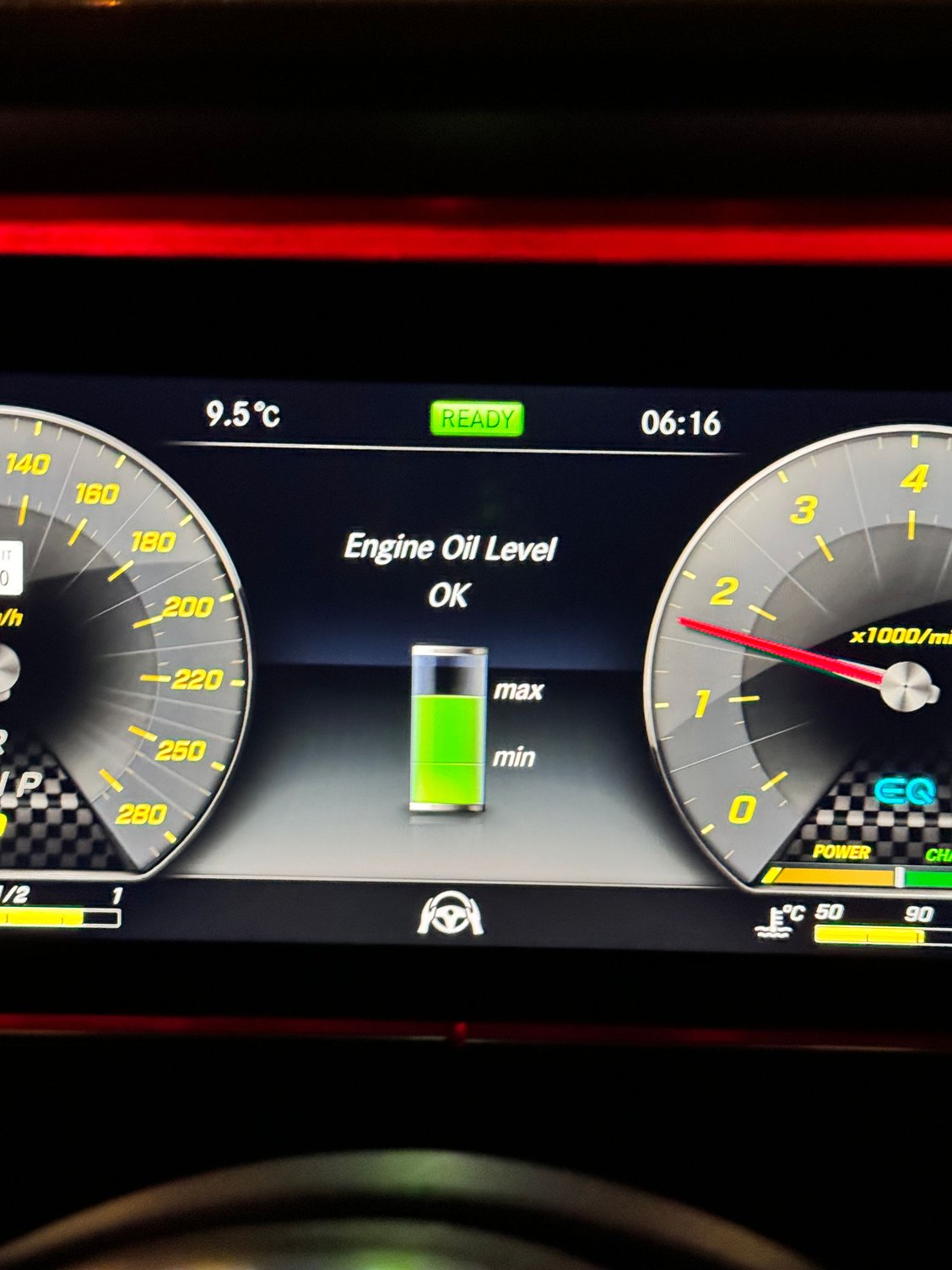

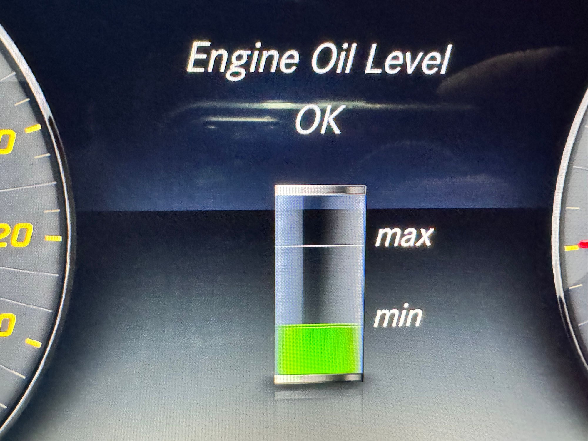

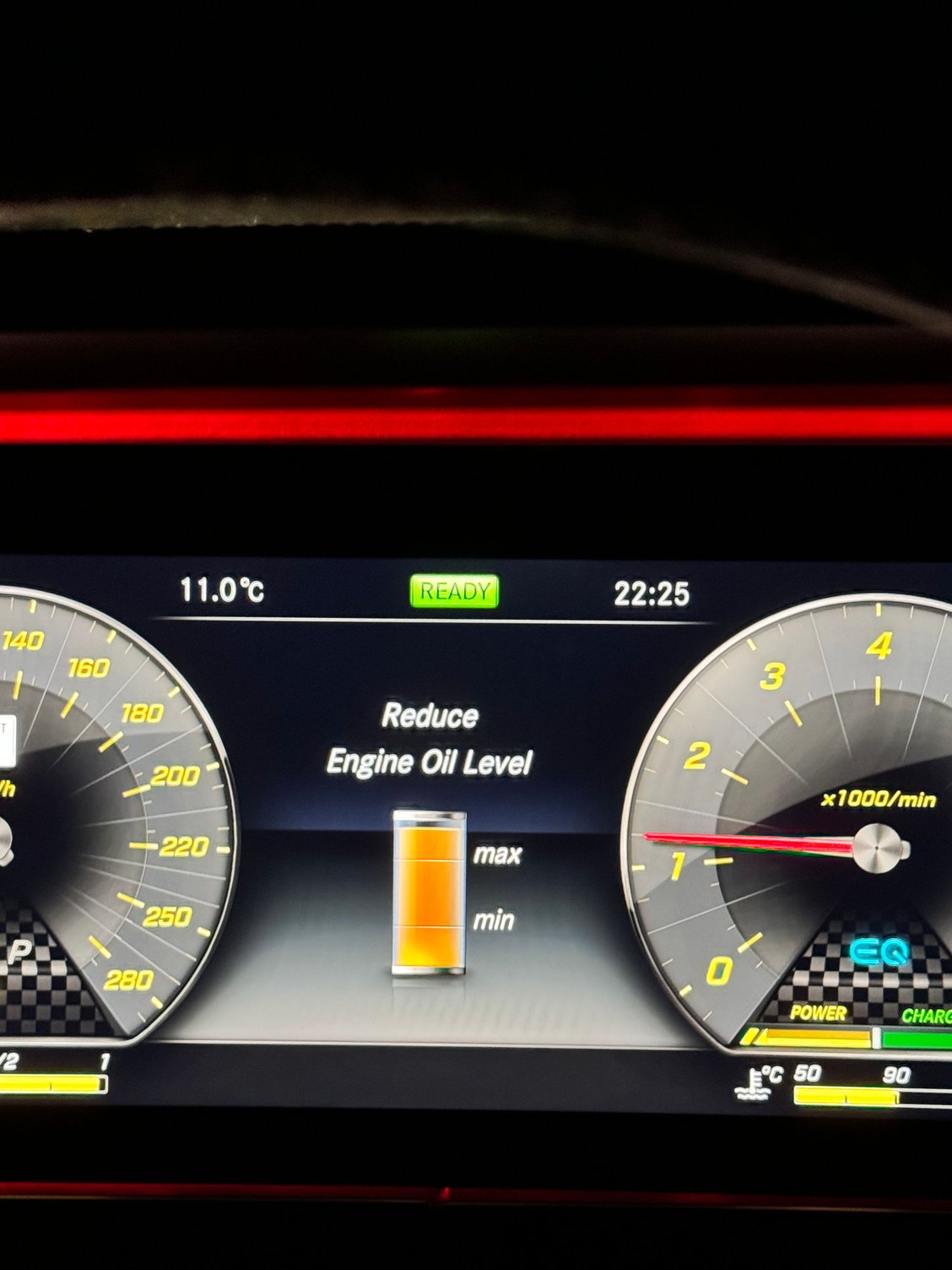

Update after Oil change
Thank for sharing your thoughts after doing and oil change and running Tests there was no sign of oil loss.
My Tech mentioned not to be worried about the digital gauge as it works under perfect conditions such as temperature slope and more.
I noticed the following after the oil change and I believe now conditions are very important.
Cold Engine
Cold Engine
After Driving for a while

After the Oil change couple of weeks ago after driving in highway for around 20 minutes got the following for the first time, I ignored it once I arrived turn the car off and back on the message disappeared. (NOW I HAVE NO TRUST ON THIS LOL)
