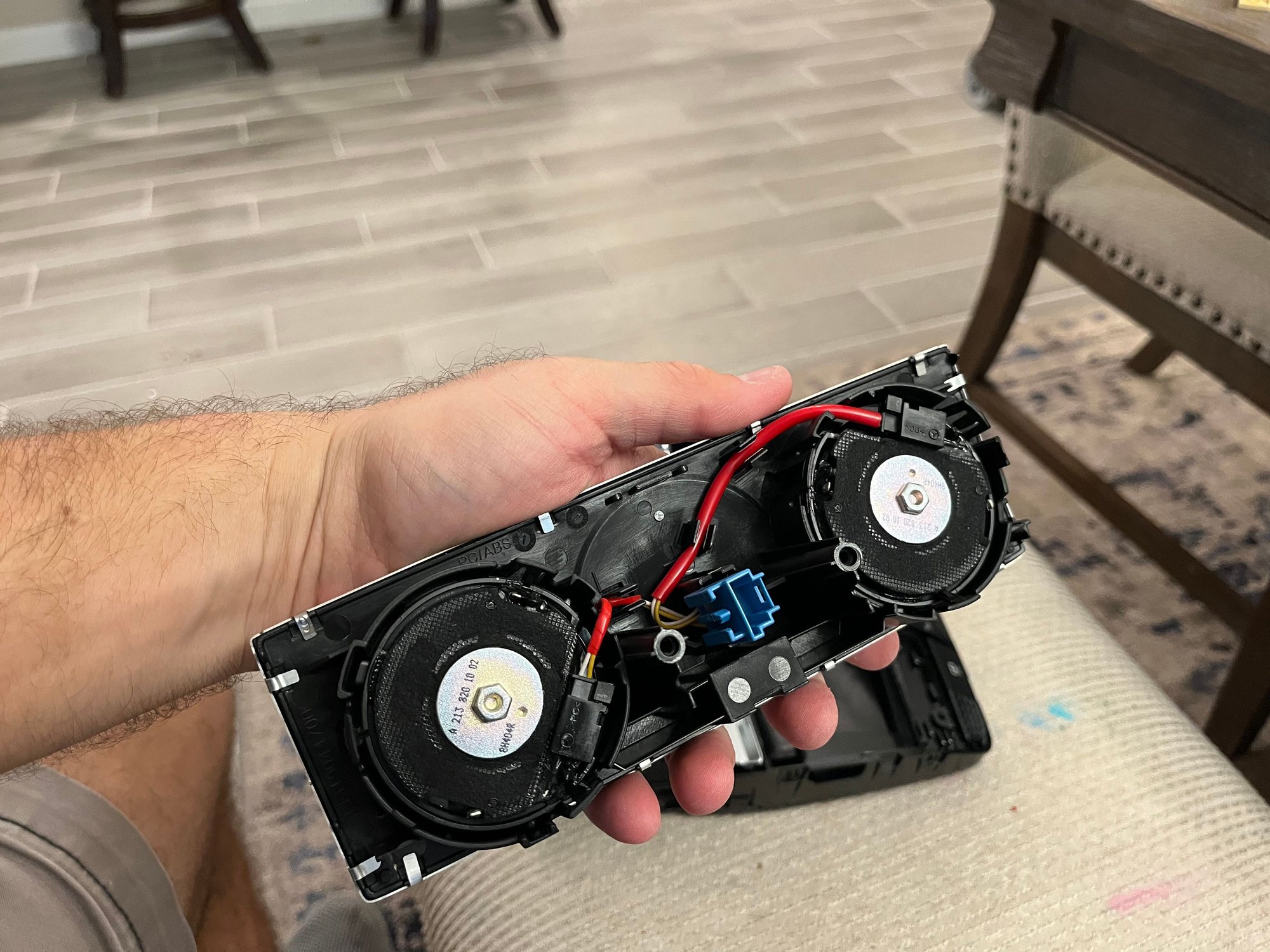

This may not be very helpful because my issue was with a 3D high end audio equipped vehicle, but I had a super annoying rattle in the overhead console. On the 3D cars they remove the sun glass holder and add two speakers and a metal grill. The corners of my speaker grill made a really annoying click/rattle noise over even small bumps. I removed the console, separated the speakers, and added a small strip of double sided tape to the perimeter and the problem was solved.
When the rattle is occurring just push and feel around and see what stops the noise. Then later remove the parts and either lubricate the plastic components, or insulate like I did if it’s just two parts next to each other that don’t move.
Hope this helps.

YOU SOLVED MY RATTLE PROBLEM! I also have a 3D sound car, and the rattle was driving me insane whenever I drove along with no music on. For the longest time the dealer kept telling me its the sun roof.... Thank you.

I had this rattle when I got my CPO.
i replaced the sunglass holder with aftermarket speaker system and no more rattle since latch is gone now 😂
