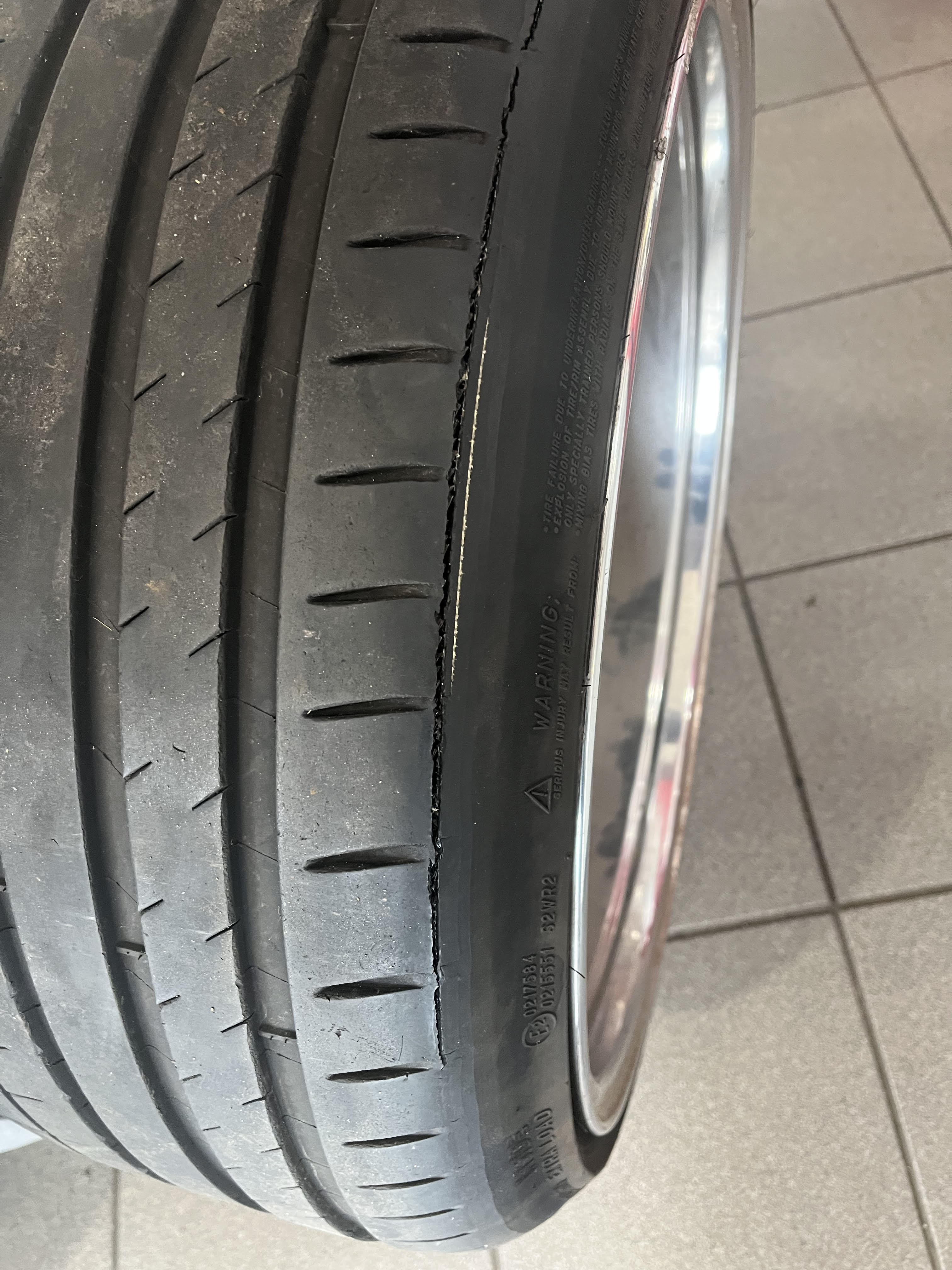

Also, be careful on the 265/30/21. I was running those before which are the improper load before I went with 285/30/21. The tire started splitting after only about 6 months of driving.

This is what happened after having the 265/30/21 on after 6 months. Improper load casualty. Now i am running 285/30/21 in the front with the proper load.
Attachment 439068
