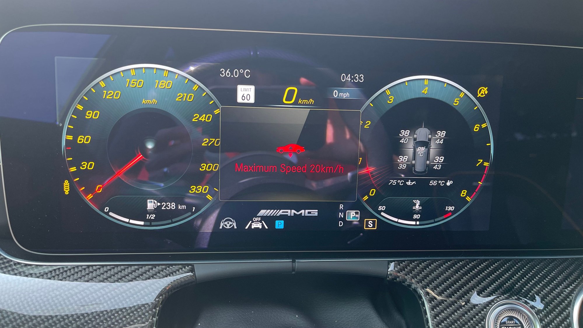

Today the right side decided to do 4x4 mode while the left side stayed normal. The common thing in all cases is after tight auto cross type turns/u-turns. Maybe a sensor is loose?
Pull in parking lot, turn car off, leave, wait 5 mins, go back all good. Made me late for an appointment though. Not happy about that.
Check out the height! Yes I looked and “lift” was not turned on in the menus. Imagine if I hit lift too lol.

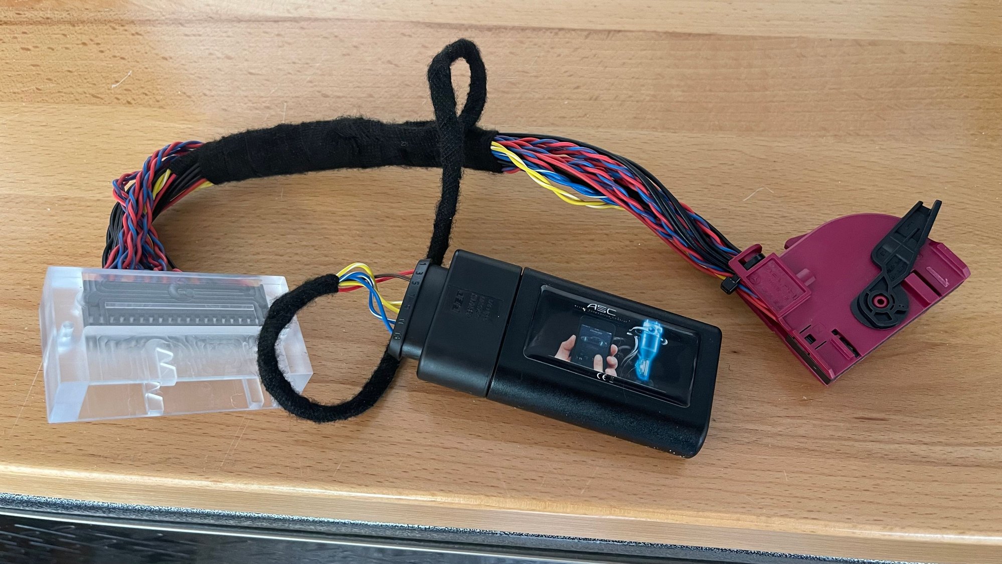

If I have time I'm pulling the Cete module completely out of the car this weekend and seeing what happens. Currently since the last error the Cete is set to 0-0-0 on all settings but still not sure if maybe it's wrecking things in the bus just enough to cause all these problems. With it unplugged if I don't ever get any issues again for a few months I'm selling it. If the issues come back with it removed it's dealer time.

I don't get how removing the CETE from the wiring the car would still have issues? As I understand it the Cete is a "man in the middle" attack between the computers and Airmatic tricking both sides. When removed, everything should just be "normal" and zero out again, no?

That umbrella is sick! And the control unit isn’t supposed to be plugged in until the “airmatic has cycled”, page 5 on the manual it looks like its a block box in their photo with a red locking clip at the harness. I of course do not have a photo.
Manual
I believe it has more to do with CETE being installed and it telling the car its already at zero BEFORE the airmatic is able to do its calculation and cycle itself to zero during start up. I guess skipping the airmatic cycle may put the levelling sensors off a bit. Lets say if someone was sitting in the car making one side lower and the car is told those heights are zero. Now because of this stock settings when the cete is removed it now thinks the zero is the correct settings. I will confirm next week I probably also got the info wrong 😑

Well it’s out.
Took 5 minutes.
Will start another thread when I have a sec.
So far so good!

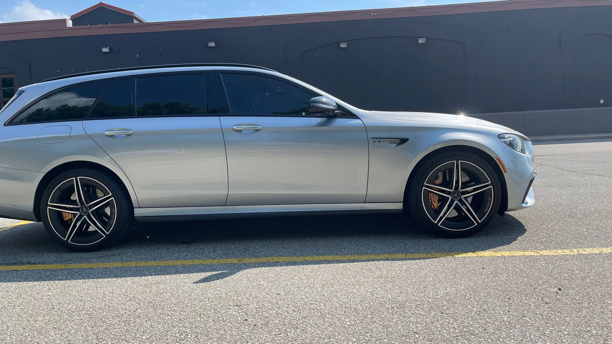

And, I think I am inclined to just leave the CETE out. I was doing the lowering for stance look while parked. Perhaps it is possible to get the same effect by putting the shocks on setting I or II for a minute before arriving at a destination and parking. I was never into the slammed look, so, I think this will do it moving forward as long as the wheel gap is manageable parked.
This is on Shock Setting I, it seems identical parked when I was using the module in Comfort Mode and 0 shocks setting and -25mm in the CETE.
I'll try setting II too a few times with a measuring tape and report back.

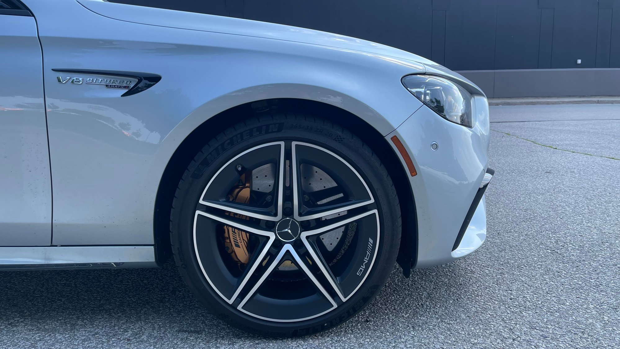

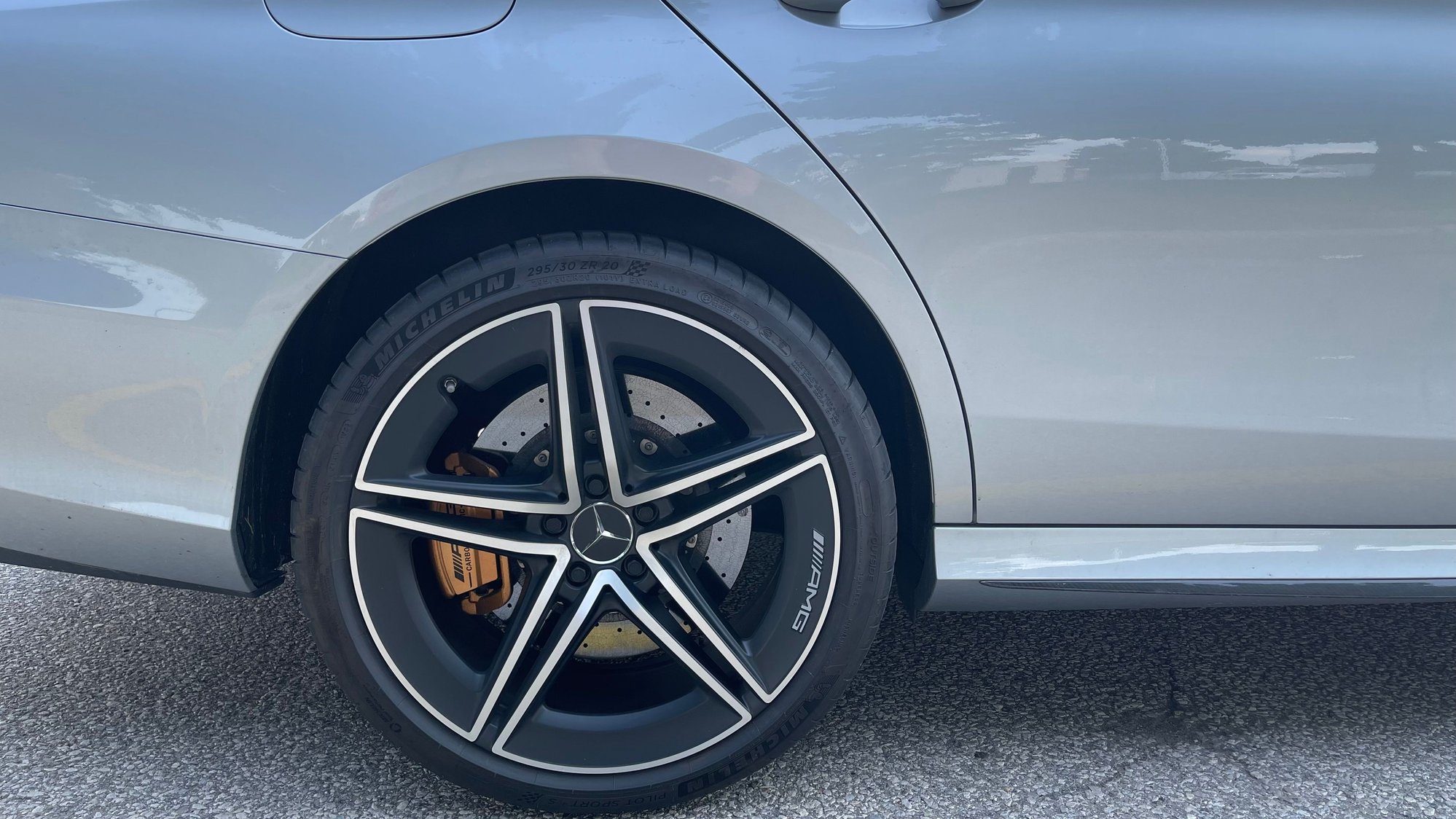

I plugged the CETE back in to make sure everything was set to 0 in every setting because to me it still seems “low”.
Can someone post a pic or measurements parking in S+ and suspension on II?
This is mine S+ no lowering module:

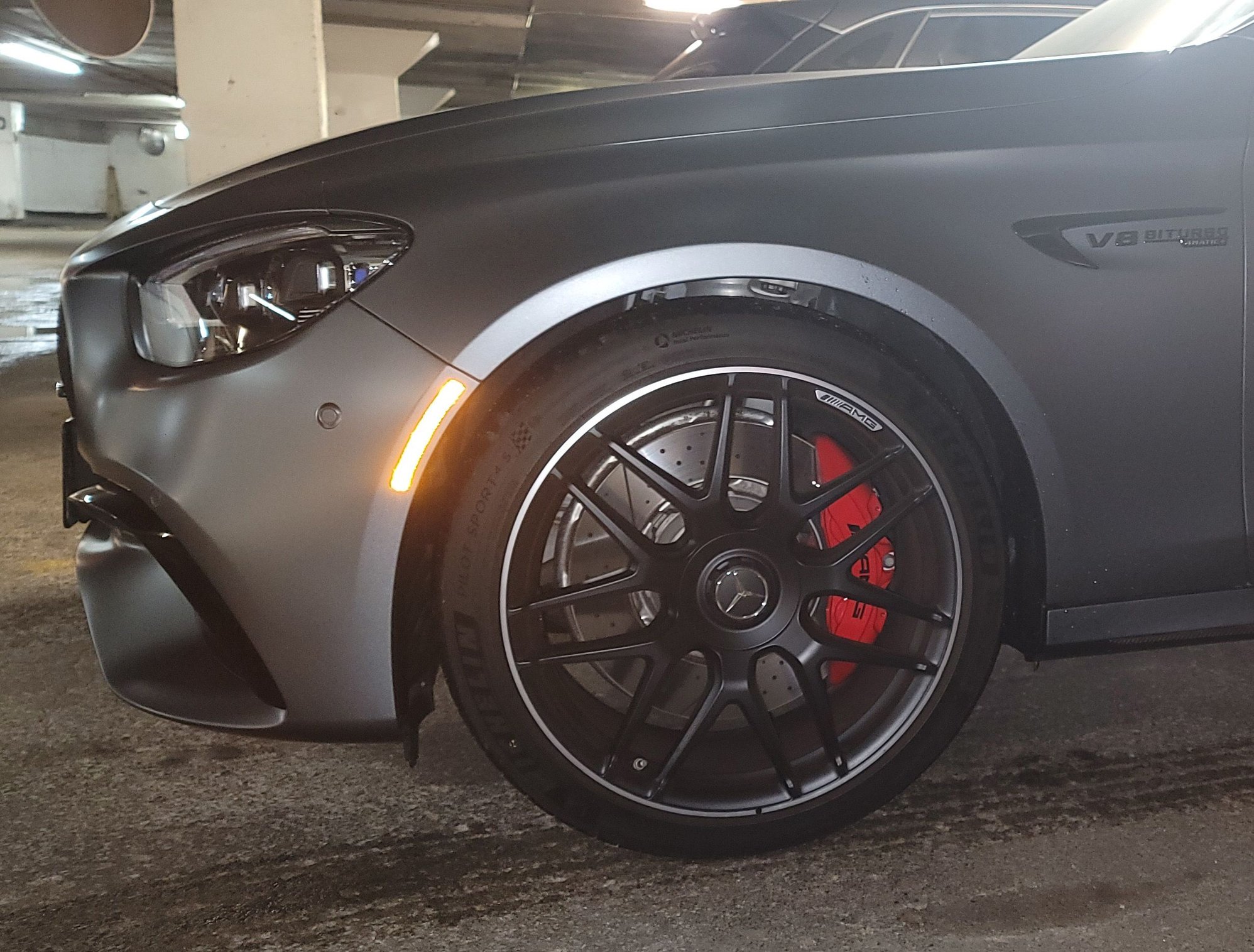

I tested this today in S+ and it's not even close to this when parked. I drove for at least 4 or 5 minutes before parking. Although my speed was only 60-90ish at peak (city traffic, never sustained 80+ for three minutes at a time as dictated per manual) so not entirely sure if my suspension truly dropped.
Here's a pic I forgot I had when car was on in S+ from a few months ago after summer tires were put on. The car was running. The pics I took this morning weren't this low (immediate after parking and 2+ min later once suspension settled.)
A few months ago idling in S+, please ignore the dirtiness, was detailed since then.
Here's one immediately after parking, I clearly didn't trigger the suspension even though I tried as explained earlier.
Today: S+, this was parked and turned off immediately after before suspension settles.
EDIT: Oops, pic when idling from a few months ago was with Alpin PA5, where the sidewall is 10mm taller. So not super helpful, my bad. I'll try this again this week.

Thank you @LMinn
Somethins is up with my car
It is still lowered
Even though all settings put to ZERO for days before CETE removal
It's still slammed
So now my concern is, are the tires going to get burned up? I had the CETE telling the car to go to normal height after 50kph
Anyone know if these lowering settings can be read by HPTuners or?
Time for a dealer visit/reset I guess. Seems like something "broke" or CETE is not removable/did not "unprogramd" my car when set to zero.
So weird.

Curious as one of my theories is after the dreaded 20kph message is that the computer resets/fixes itself AT THE CETE SETTING as the new zero, and your car maybe the same as mine now! Try putting your setting back to 0 in comfort drive around and park. Is it still low too?

It appears that the module flashes ROM which is why the car needs to be zeroed out to make sure the zero setting on the module matches the zero setting on the car for removal and returning the car back to stock.
If I had to guess there are a few suspension maps
1. parked height or
2. raised height (under settings)
and
1. comfort
2. sport
3. sport+
As an example one can be in sport+ raised then parked. CETE also adds in show mode somewhere but doesn’t account for all suspension maps completely.
Like let’s say:
Module Setting: Show Mode
Raised Setting: Active,
Parked: No,
Yaw/Balance Sensors Involvement (G-sensor): Active
Suspension Setting: Comfort
Then this is where the ride height sensors get confused. If I had to guess the g-sensor map is likely not attached to any suspension programming that CETE wrote into the suspension flash.
This also leads me to suspect the car should be at zero or stock ride height under the cete app (as if the module is removed) for all the maps to work in unison with the sensors on a race track.
Old Jun 27, 2024 | 02:40 PM
  #400
graphitegreyamg's Avatar
Joined: May 2023
Posts: 173
Likes: 175
2023 E63S Wagon
Just to add to the fire this seems to have happened previously in exact instances I had presumed earlier. Here is a post on what I assume is a stock car parked in uneven ground:
https://mbworld.org/forums/w213-amg/...lfunction.html
There’s also another factor of active suspension adjustments to counteract wind and uneven roads etc.
