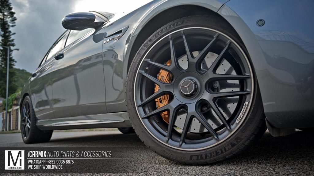

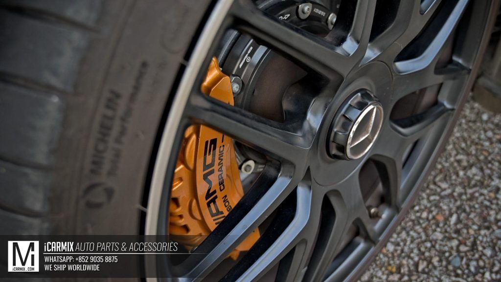

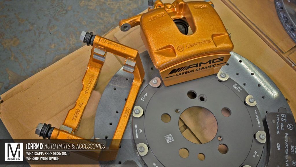

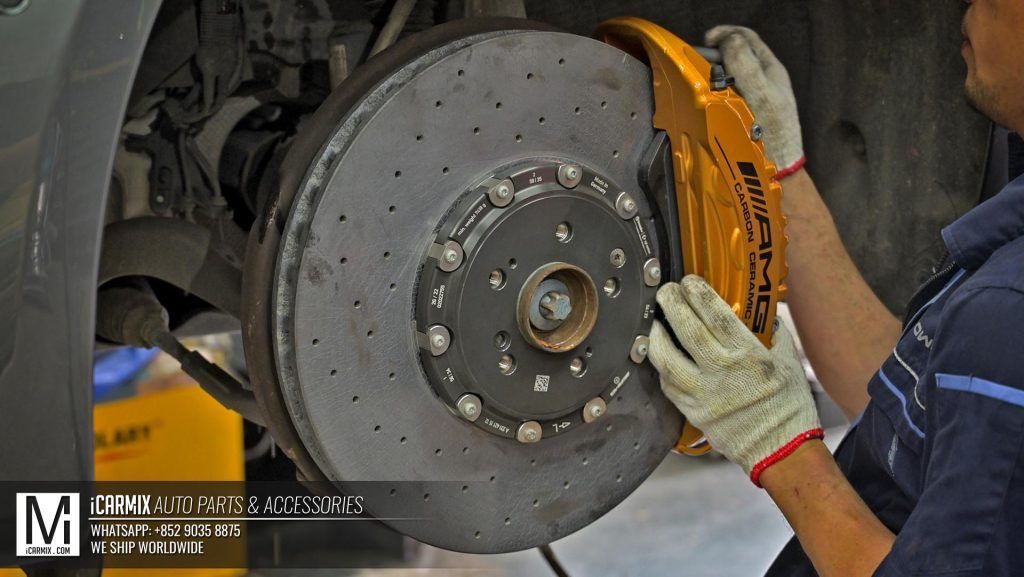

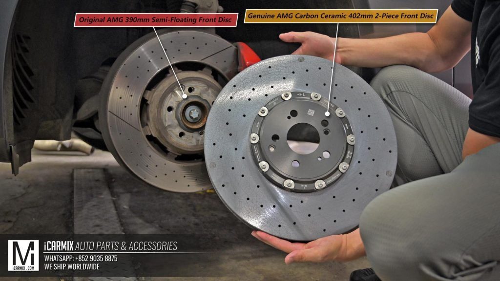

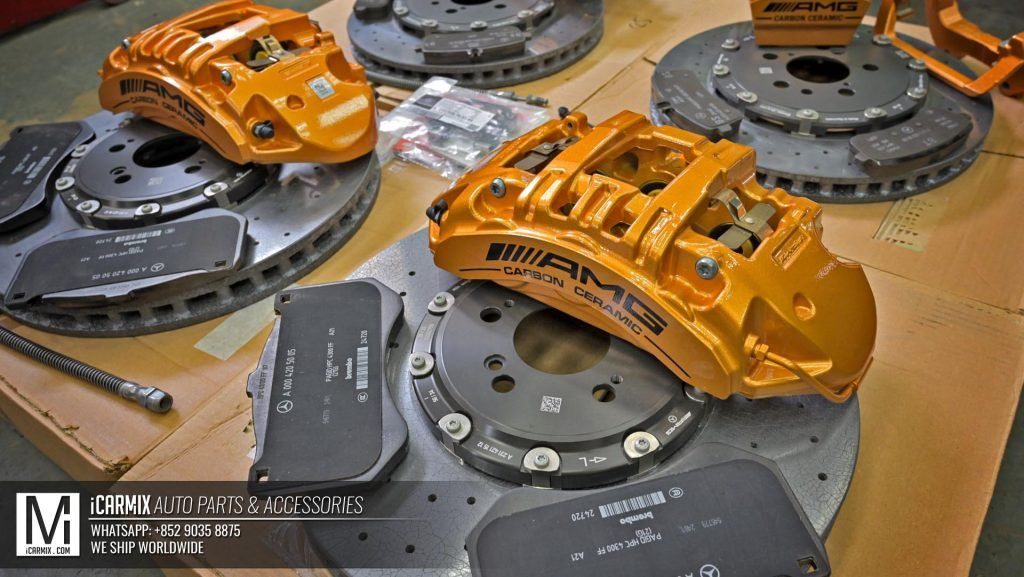

Above budget? AMG carbon-ceramic brake kit

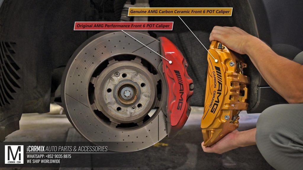

If there’s any upgrade considered unnecessarily expensive by a lot of people, and only appreciated by a few, this is it, the original AMG carbon-ceramic brake system.
Well, the owner of this W213 E63 AMG is certainly among the few people who personally appreciate the advantages of this part.
The kit adopts a 6 POT design for the front, 1 POT for the rear, and comes with larger, gold-painted calipers and 2-piece ceramic floating discs (402mm front and 360mm rear).
This is the highest level setup for the original E63, by the way, and to list a couple of its fully fledged features:
- wear resistant (long lasting)
- temperature resistant (1830°C)
- extremely lightweight
- minimal amount of braking dust
Enjoy the installation photos, I know I did!

Originally Posted by I.T. Guy
What is the change required? Thank you!
more than likely ABS will need tweaking since the CCB are bigger than the irons for the fronts
390mm vs 402mm.
Also there is a weight difference to account for of 7lbs per corner.
