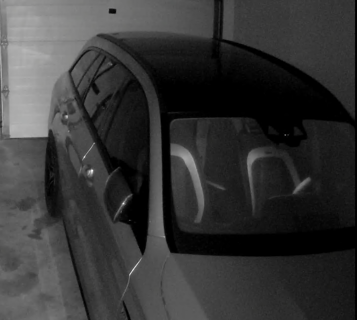

Here is a video of the car lights thing.
I have a pretty nifty commercial video system so doing an investigation is super easy. I drew my motion frame around the windshield and this has been happening for months. There is nothing going on outside on any cams in the same timeframe.

The dome/map lights coming on is definitely bizarre. Something is waking it up.
Do you think there could be a possibility it could be related to an external connected application like Mercedes Me (or whatever they're calling it this week)?
BTW, nice camera setup and footage. Nice.

Will a bug flying or crawling on the motion sensor trigger anything
I thought of that too. Thing is if I forget and lock a passenger in the car to run in and out of a store the alarm starts going after a few minutes.
Definitely something to look into more.
If you are serious about this thought - I think you are - the person(s) doing it would not need to be within camera range, or are smart enough to check for IR and avoid it. I have seen goofiness like this many times (not so much with cars...but, your an IT guy, right?). Tends to be an adventurous neighbor kid with some YouTube videos and an Arduino. If it was a serious player...I would find the cars home (in theory they did)...test, test, test in the AM when you are heading to work (a typical normal daily time to minimize the "stake out"). Then, finish the job at a more public open place while you are getting some eggs or something.
If your theory is right...I blame neighbor kids (and I am as jaded as they come and have left my former home/state due to crime).

Anyone else want to stare at their car all night? I wonder if this is just some dance it does talking to MB.
