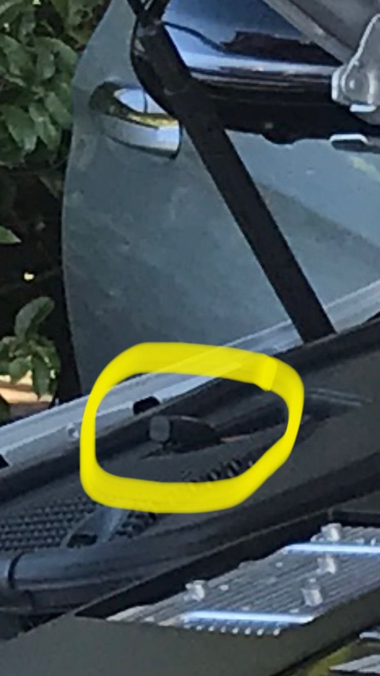

2018 e63 AMG. This car doesn’t get driven much so I’d like to put my CTEK on it. The battery was replaced by the dealer a few months ago when I bought the car used with 11k miles. I’m not having any problems, but would like to keep it that way. Dealer confirmed it’s an AGM battery. When I connect the charger to the positive blade and the negative stud under the hood, it only charges to 50%. I am new to MB but I know Porsches have a lockout mode for charging unless you do a certain door close/lock sequence. Is that what’s happening here? Recommendations appreciated. Thanks!

I would also recommend you install the dongle CTEK provides so you only have the connector peeking out from the battery compartment. I've found you can run the cable straight to the front, bring the hood down and even a custom California Covers cover will fit. Looks very slick when you open the hood.
