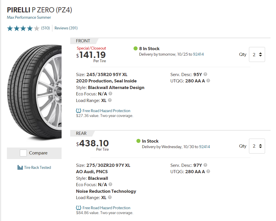

Only good news is TireRack is still blowing out fronts for $140.
Which tire are they blowing out for $140?????
Old Oct 23, 2024 | 05:37 PM
YYC53's Avatar
Joined: Mar 2024
Posts: 249
Likes: 49
2020 E53 AMG
PZ4'S.
Old Oct 24, 2024 | 05:01 PM
WildWolf's Avatar
Joined: Jan 2010
Posts: 179
Likes: 31
From: NorthEast United States
2019 E63s
Originally Posted by YYC53
PZ4'S.
Think they changed the price. I don't see that anymore.
Old Oct 24, 2024 | 05:13 PM
YYC53's Avatar
Joined: Mar 2024
Posts: 249
Likes: 49
2020 E53 AMG
It's the E53 size that's available. My mistake.
