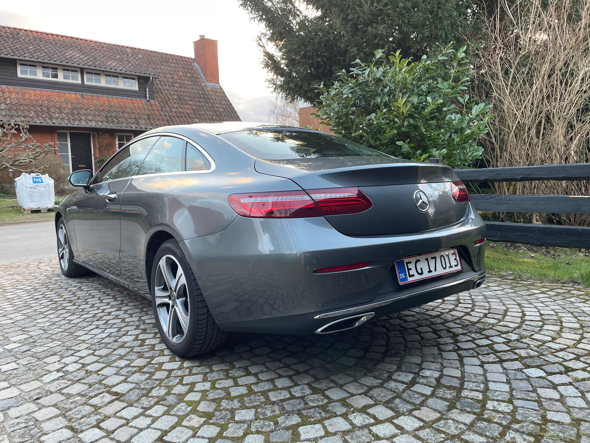

Don’t have the shocks as already picked up the car from MB. Car is presently on winter rims and tires. Brand new 20” summer rims and tire will go on when frost and salty roads end mid April

All good, and gorgeous vehicle, enjoy in good health.
