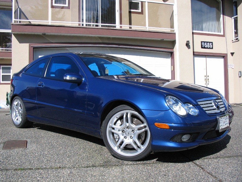

Tint Scratching on your car… how about an easy fix.
I have seen a lot of people talk about this so I had to come out and help you guys… this will fix all those problems your having.
This is really easy to do and its fool proof and it works really well and it will not scratch the tint of your car for life of the tint.
But however there is a small fall back to this… that is you will hear a little more road noise coming from the door you can barely notice is but if you pay attention to detail like me then you will notice the noise, but it is something that is so small that you can live with for sure.
The picture of my old car is attached with the tint and if you can tell it was not scratched at all…
Ok well all you need to do is:
1) Go to a local clothing store and buy some black velvet long enough to cover your door strips… (you know where I’m heading with this)
2) Take the door panel’s off the car
3) Take the weather strips off
4) Cut and rap the velvet around the weather strip there is no need to glue or anything to make it hold in place
5) Put the door strip back on the door and push really hard so that the velvet get wedged in and is not loose or dangling run your hand down the strip just make sure its not loose and then just put the door panels back on and your set.
All this does is put a little gap between the door strip/window thus is why you get a little more road noise. If your car is still under warranty and you have yelled at your dealer that your tint is scratching and they should fix it… follow through with that and provide them with the velvet and get them to put it on your car for free.. my dealer did that for me and I’m sure yours can do that for you. But I have also done this my self on my friends car so I can help you with the install if you like… if you have any questions PM me or e-mail at the address blow
Good luck
sorry i dont have better pic of this mod.

Velvet is too fragile and won't hold up for the long term. What my tinter did is sand the plastic that's being glued too and use the fuzzy part of a velcro strip and it sticks on good, never had a problem with it. He may have used a commercial grade velcro strip that has a better adhesive, I don't know but it's certainly easy, no glue mess, no cutting fabric.
