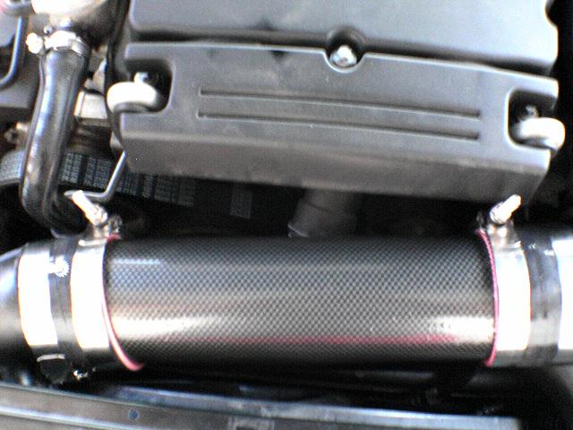

question
so how do i make one of these pipes? looks good.. metal or plastic? how does it connect? i cut the cloth and then? can some one explain... please...
Old Jul 20, 2007 | 01:10 AM
  #82
rlee02135's Avatar
Joined: Mar 2006
Posts: 6,665
From: Boston
2004 C32 ///AMG
that one above is carbon fiber.....very expensive
you can choose plastic or metal.....its a 12" long pipe, 3.5" diameter
use 3.5" silicone turbo/intercooler couplers to connect the ends.

Haha.. okay, why I did the CF piping is because 1) it looked damn good 2) presumably CF is a natural heatshield (and that was DRY CF piping). Generally you want to stay from metallic pieces as they just warm up and soak heat, so a thin plastic you might be able to get away with...but it has nothing close to the strength of a CF mold.

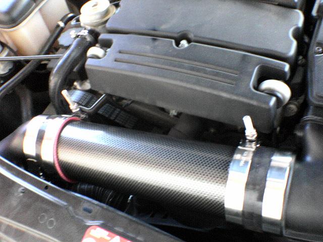

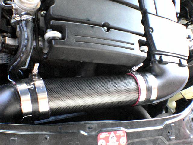

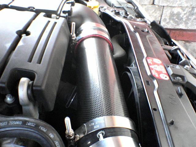

ok i did it too...
i made one of these pipes too... take a look...
Attached Thumbnails Its Done- Home Depot Customized Intake for M271-dsc00080.jpg   Its Done- Home Depot Customized Intake for M271-dsc00081.jpg   Its Done- Home Depot Customized Intake for M271-dsc00082.jpg   Its Done- Home Depot Customized Intake for M271-dsc00083.jpg   Its Done- Home Depot Customized Intake for M271-dsc00085.jpg

nicely done! love when people do custom work. notice a change in noise comign from intake? any increase on throttle response?
Is it real carbon fiber or wrapped? What flip did was cut a full carbon fiber pipe that was already pre-made for something else. If this is wrapped, you may not get as good of results, but looks good!
Nice work...and welcome to the forum!

its not real carbon fiber.. i wrapped it.. it's an 3.5" aluminum pipe. i got silicone connectors. but it looks good.. looks close enough to carbon fiber.. i cant find a carbon fiber pipe so this will do for now... but i dont think this gives any performance... sounds the same too... i might be wrong...

the more i looked at it, i was a bit more skeptical. you may end up losing performance/hp on this due to the pipe getting heat soak. hope for the best.....

the stock pipe is cloth.. so it gets heat soak too... what ever you put it still gets heat soak... everyone has a cold air intake the pipe is still under the hood right? the filter could be under the bumper or in the trunk... the pipe is still under the hood... heat soak is normal... how can you make a air intake with out heat soak?

the cloth pipe is there cause it handle heat better then metal, which im sure you know. but since you asked...
If it's wrapped aluminum piping, then it wouldn't have the same effect as the carbon fiber pipe Jose used before. Either way, it looks very nice, however it basically is for aesthetic reasons rather than practical or performance reasons. If that's what you wanted, then it'll work.
