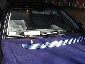

Okay, just took a pic. It's at night right now so the pic isn't the best, but you get the idea.
Pretty much all MBs 2004 and newer will have aero wipers, so you'll probably see them all over the street as well
Oh yeah, the only tool you need (instead of all that fancy schmancy OEM angle-adjusting stuff) is a 13mm hex socket. Try a position, tighten the bolts by hand, go switch on the wipers and see if you are happy with the positions. In the ideal position, the passenger wiper *just* overlaps (maybe 1-2cm) where the driver's blade sweeps, ensuring maximum coverage, and that the driver's side wipes as close to the windshield trim (driver's side edge)without hitting. Of course, you also want to make sure that nothing else (ie bottom of the windshield) gets hit by the blades or arms.
Don't use the socket until you are absolutely sure, as the bolt will jam the wiper arm into the spindle (it's an interference fit), making adjusting a real PITA, not to mention you slightly damage the arm "hole" each time you do this. Each time you adjust the arms, you slightly damage the arm hole (think of it as stripping threads off screw hole)
One recommendation is that you mark the old blade positions with a water-soluble marker as a reference. I found that I liked my aeros slightly "higher" than before during the rest position (to wipe closer to the driver's edge) and the passenger side slightly "lower" (to ensure they were out of sight when not in use). Personal preference here.

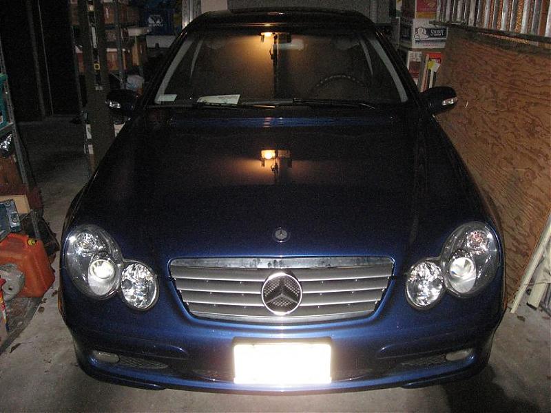

here's a pic of my MB aero wipers, installed on my 2003 Coupé in Sept 2004.
My wife's 2004.5 C320 SS came with aero wipers.
I love 'em !

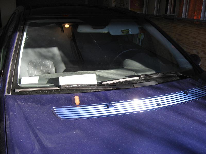

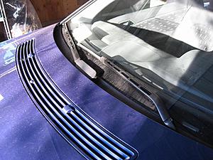

Here is the finished product.
Yes my car is dirty as hell, no need to tell me

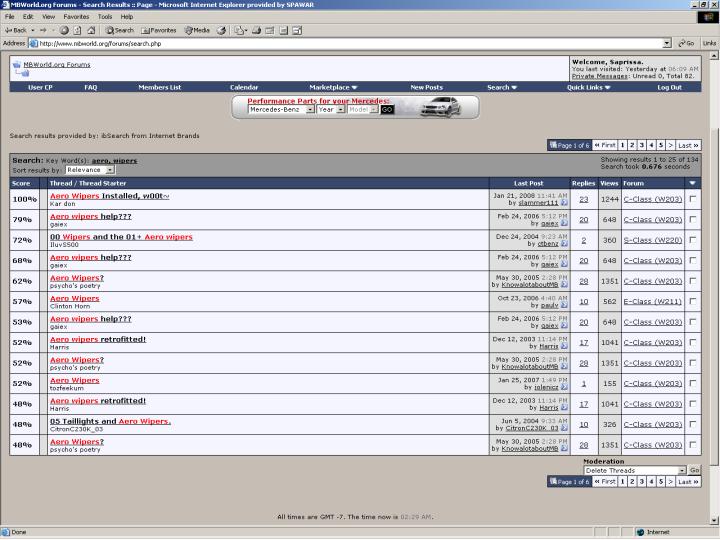

I quickly typed in "aero wipers" into the search function and came up with this:
I'm sure the part #'s are on there somewhere. Maybe all those threads should be merged.
