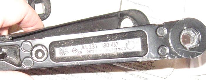

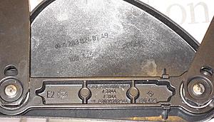

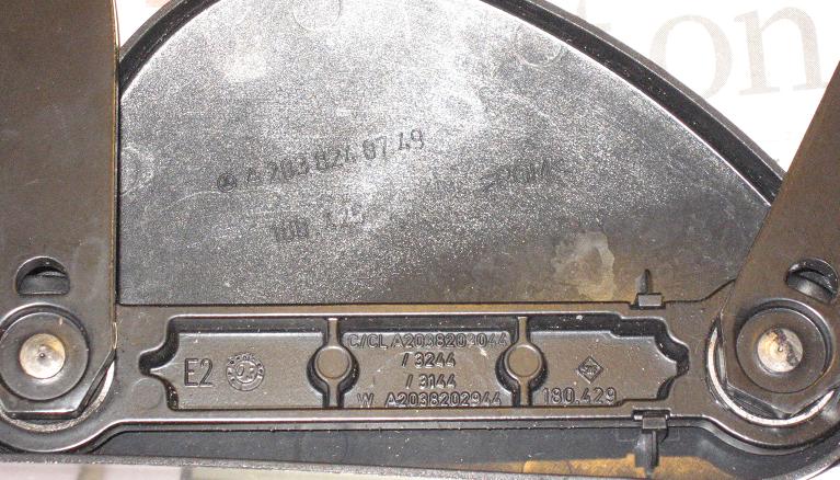

Aero Wipers Installed
Light rain today, installed them and tried them out. No pics as I installed them at 1am
Aero Wiper arm part #s are the SAME for all W203 C-class (coupe, sedan, wagon). Only difference is that the sedan and wagon require 22" blades on both sides, while the coupe uses 24" on driver's side and 22" on passenger, for the non aero
Since the blades I picked up came off a wrecked sedan and I drive a coupe, I decided to just keep the 22" blades that came with the arms for now. To be honest the shorter length works fine as well.
C = Sedan
CL = Coupe
W = Wagon
Taken right off the wipers themselves:
L Arm A203-820-25-44/27-44
L Cap A203-824-05-49
R Arm C/CL A203-820-30-44/32-44/31-44 W 29-44
R Cap A203 824 07 49
The trick is to get the driver's arm installed so that it doesn't hit the passenger's blade in the "bottom" position (I left a 2cm gap for safety) and also not to hit the driver's side windshield trim at the "top" position. Took a bit of unbolting/wiggling/bolting but after 4 tries, I'm satisfied.
They are not completely silent (still the occasional squeak) but about 75% of it is gone compared to the old wipers. That alone made it worth the $.
Highly recommended. Makes the car look more expensive too (I'd say bi-xenon is #1, aero wipers are #2).
Attached Thumbnails Aero Wiper Retrofit Discussion Thread-l-arm.jpg   Aero Wiper Retrofit Discussion Thread-r-arm.jpg
