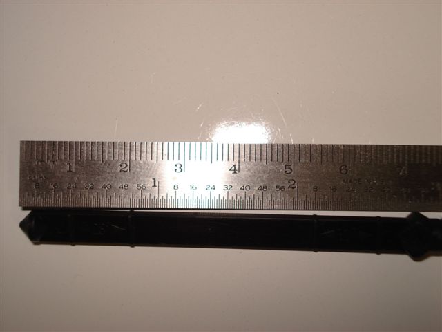

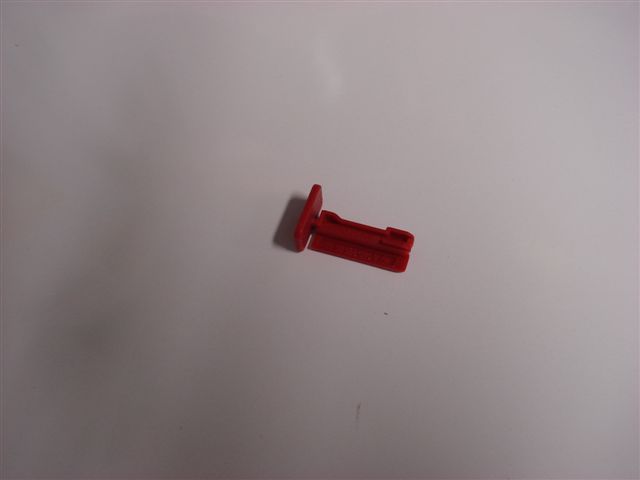

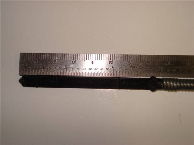

This might help until you get the tool...it's not universal, it's trans specific. You'll also need to replace the pin that locks in the trans fill tube cap that you break off when removing it. You can hold the cap on with tape until you get the pin, it's not critical. The other pictures are of the end of the tool...it's a long flexible shaft that you push down the trans fill tube until it bottoms. The two notches at the end of the tool are max and min for cold, and the two above it are max and min for hot (80C). Measure with engine running.
