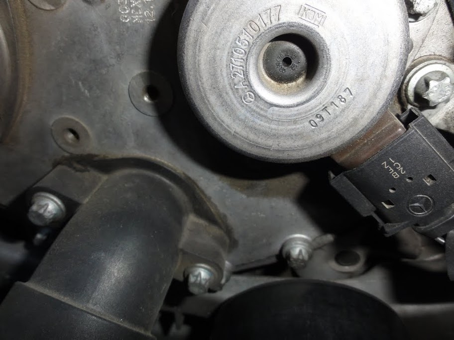

Mar 30, 2013 | 08:43 PM
Hey guys,
after a short trip (~400mi) I noticed a slight oil leak (sweating?) at my camshaft solenoids, and also traces of slight coolant seepage at thermostat housing.
With my normal driving, I do not think I saw any leaks before. Certainly not the coolant.
The solenoids were replaced about 25k miles ago, and thermostat and o-ring 2 years ago.
I have the pig tails on the connectors.
Is it something serious or do I just wipe it off and keep driving it as usual?
The car is at 129k miles now.
Reply 0
Mar 30, 2013 | 10:42 PM
the danger is not the leaking around the magnet but rather into the wiring. To me it does not look bad at all, maybe snug up the three bolts a bit, or buy a new O-ring and clean up around the area
Reply 0
Mar 31, 2013 | 04:09 AM
doesnt look too bad.. I'd clean it and tighten it up and see if it leaks again.
Reply 0
Apr 3, 2013 | 01:36 AM
OK thanks for the advice guys, I will report back if it gets worse. The wiring appears to be free of oil so far.
