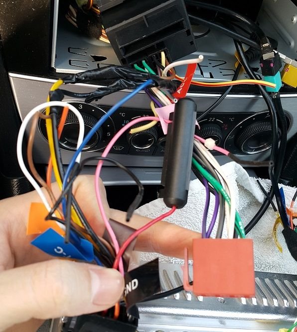

Ok, so the head unit I ordered should arrive anytime now, but the ISO adapter with CAN BUS support is still on its way, and I have no idea when it will come.
I've never done any installation, but since there's already an adapter in my car with a chinese aftermarket headunit, I thought to try and figure out how to connect it.
Until I get the adapter with the Can bus, , I will use the current adapter without steering wheel controls, to test it and then I'll install the new adapter with steering wheel controls.

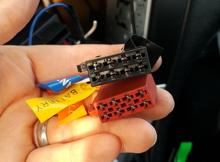

I began taking off the current 2din headunit, and it seems they used a quadlock ISO adapter like this one:
This is the quadlock interface of the Mercedes after detaching the adapter:
And this the connector to the Quadlock:
These are the ISO connectors to the headunit:
I ASSUME that the ISO connectors can be connected to the Joying ISO harness provided with the headunit:
https://www.carjoying.com/joying-har...g-adaptor.html
But I noticed that the installer changed a bit the order of wires, maybe because it was intended for a VW car, like this:
Also, I think he connected the ACCESSORY red wire to the cigarette lighter. It's visible in the first pic I posted
The question is: - should it be easy to connect the JOYING headunit using the ISO adapter and the install I currently have?
How can I be sure about the correct wiring ??
Thanks!!

Pulling the remote/accessory wire to the cig lighter is common. In fact it might be the only way. Personally I would tear out all of the wiring there and start over. To much electric tape for me. there is a a pin out posted above. That and a multi meter should be all you need.

Yes, it's quite a mess, but it's only a temporary solution until I receive this adapter with steering wheel controls:
https://www.dynamicsounds.co.uk/merc...rch=DS-MC001.2
My common sense says that since the current install works perfectly, and it's using a regular ISO connector, I should be able to connect it to the aftermarket harness that comes with the headunit :
Is that so?

Ok, so I received the head unit and have it installed. Until I receive the harness with CANBUS adapter for steering wheel cnotro, I needed only a small modification current harness.
The ACC accessory red wire is connected to the cigarette lighter, and it is working fine.
The head unit has an ILLUMINATE wire which turns on the lights on the panel buttons, but it is not working. ITshould be connected to the car's light control wire, but AFAIK the W203 with AUDIO 20 doesn't have one.
I read that I should connect it to the cigarette lighter or any 12v source so it will stay on all the time.
Is that so? Is it the correct method to connect the ILLUMINATE wire?

First, don't think "professionals" automatically do everything correctly. They are just people like you and me, and unless they know the quirks each car they work on they are just as likely to make wiring mistakes like you or me. I would expect their wiring connections to be neat and tidy ... I wouldn't necessarily expect their wiring connections to be correct.
When I installed my head unit the only place I could find to connect the illumination wire was from the cigarette lighter. And it's close by and easy to tap into. This is a different wire than the regular 12v switched.
I had the base stock audio unit in my car, and I still had the powered antenna booster hidden away in the car. So make sure you power that pin with switched 12v as reference by others in this thread.

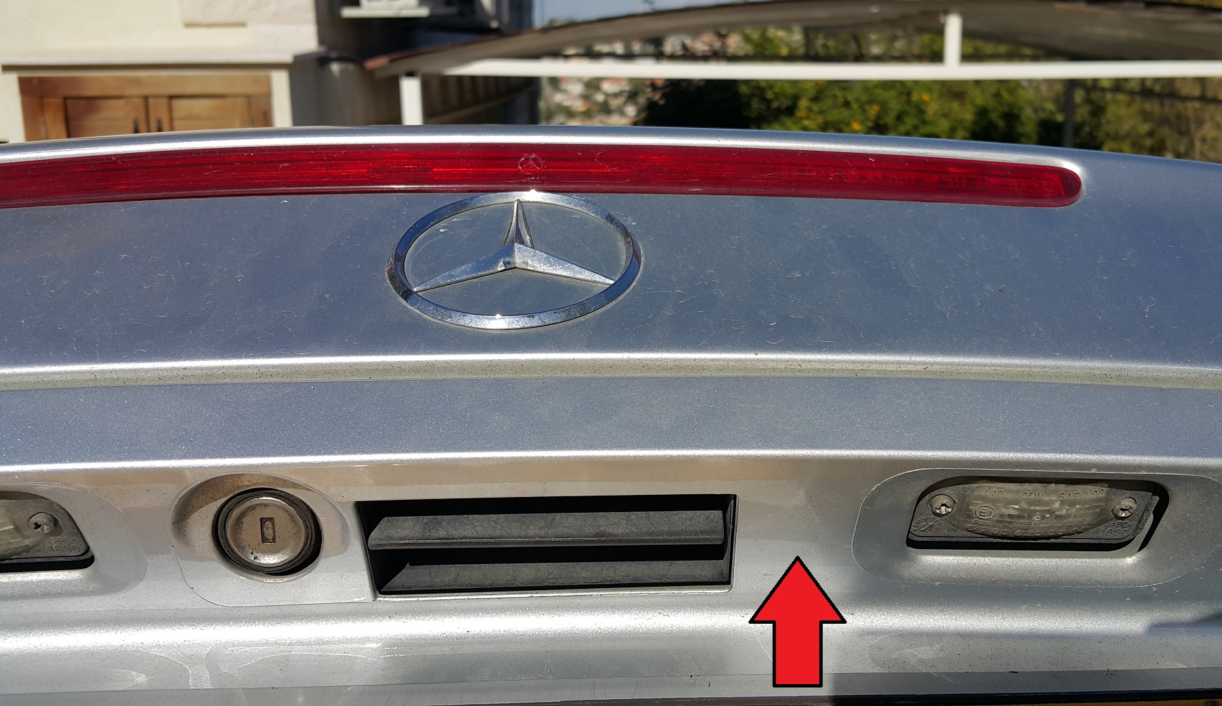

Now I want to install the rear view camera that came with the unit, butI can't find a good spot in the exact midline of the car, so I would have to attach it 2-3 cm on the right or left. Is that a big deal? Would it be reasonable to install it this way?
Someone suggested to drill a whole and install it with an adapter just like the parking sensors. It could be a good idea, but I don'k like the idea of drilling holes, even in the plastics.
Thanks!

Hi, apologies for not replying. I was away on holiday. good to hear you got everything working. It looks like its a difficult job but once everything is hooked up, it all comes together nicely.
I have also installed a rear camera to my setup. i had to move mine to the side because of the trunk handle and lights being in the way.
If you dont want to drill big holes everywhere, why dont you get a camera mounted to a licence frame? it will sit right in the middle and can be removed at a later stage also.

Looks like a great solution, but I already bought this rear view camera, so I'm trying to find a way to use it properly.
https://www.carjoying.com/car-access...ew-camera.html
So you say you had to move your camera on the side, I guess it's the same as I planned to do , I attached a photo.

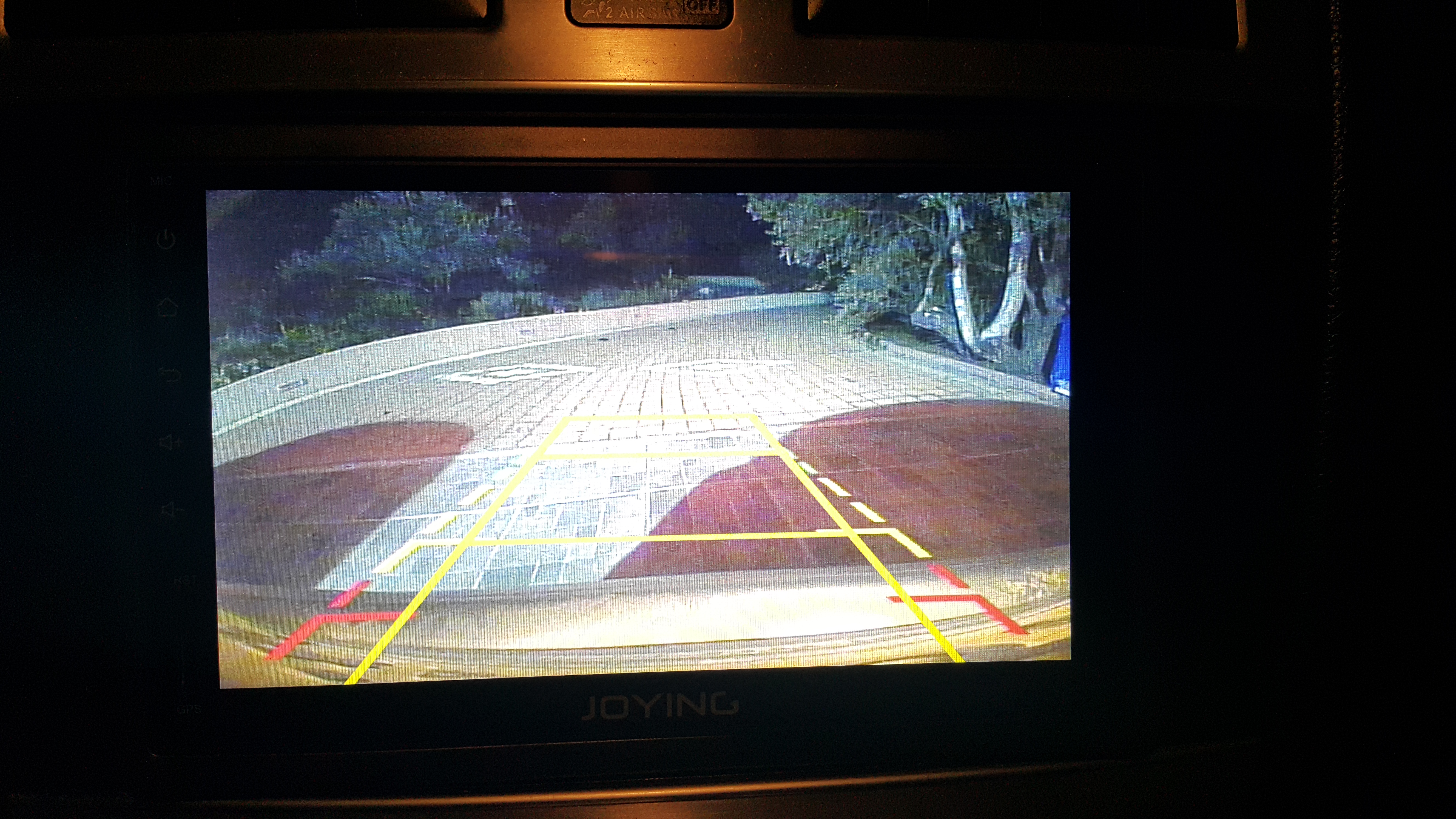

Does it work fine this way? Any problems with alignment? Are the grid lines in your head unit, and if so, are they aligned correctly when parking?
Thanks!

The camera works but the alignment is not 100%. It doesnt really bother me that much because i just use the camera to see whats behind me. If i miss anything, the parking sensors pick it up.

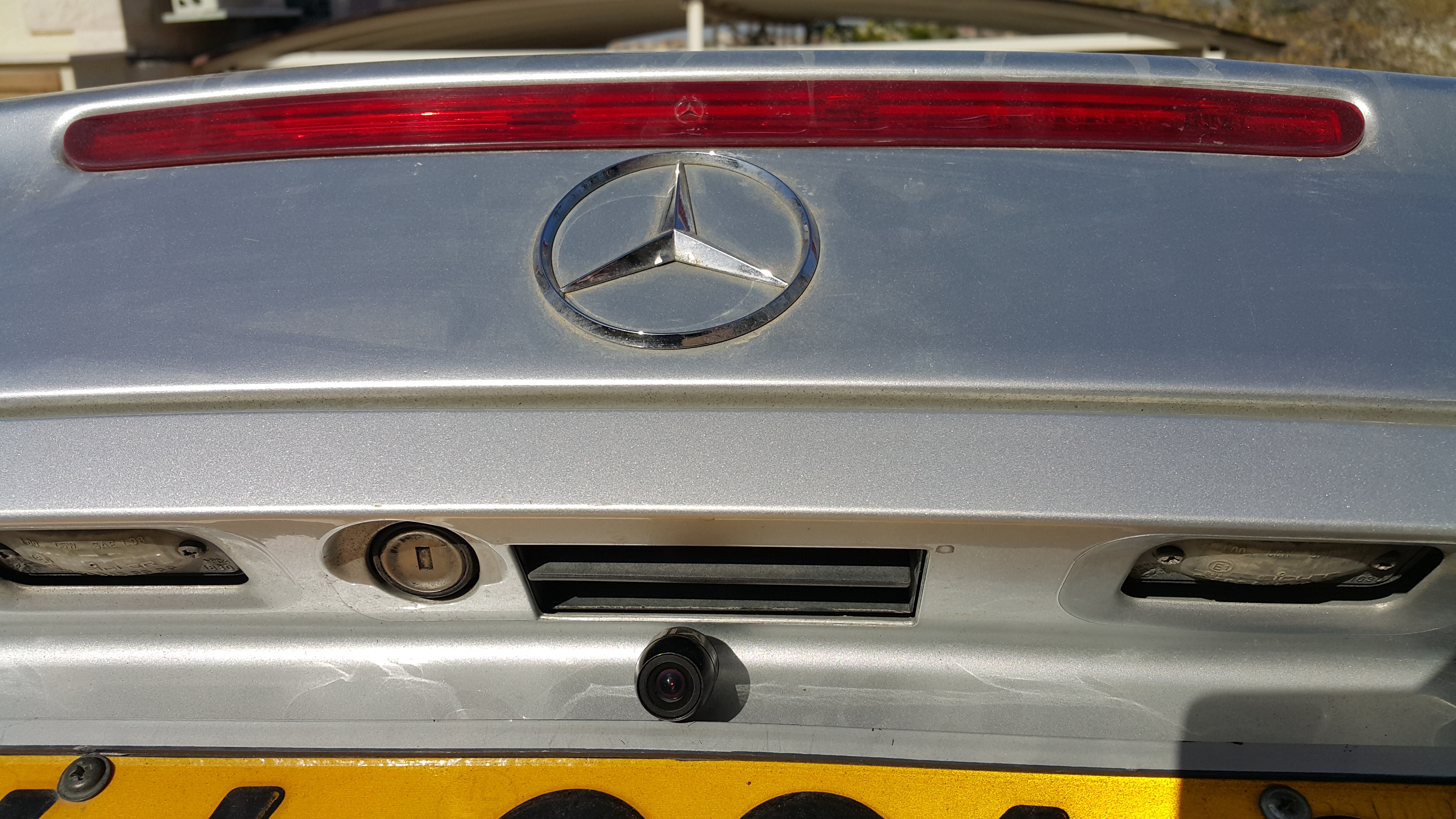

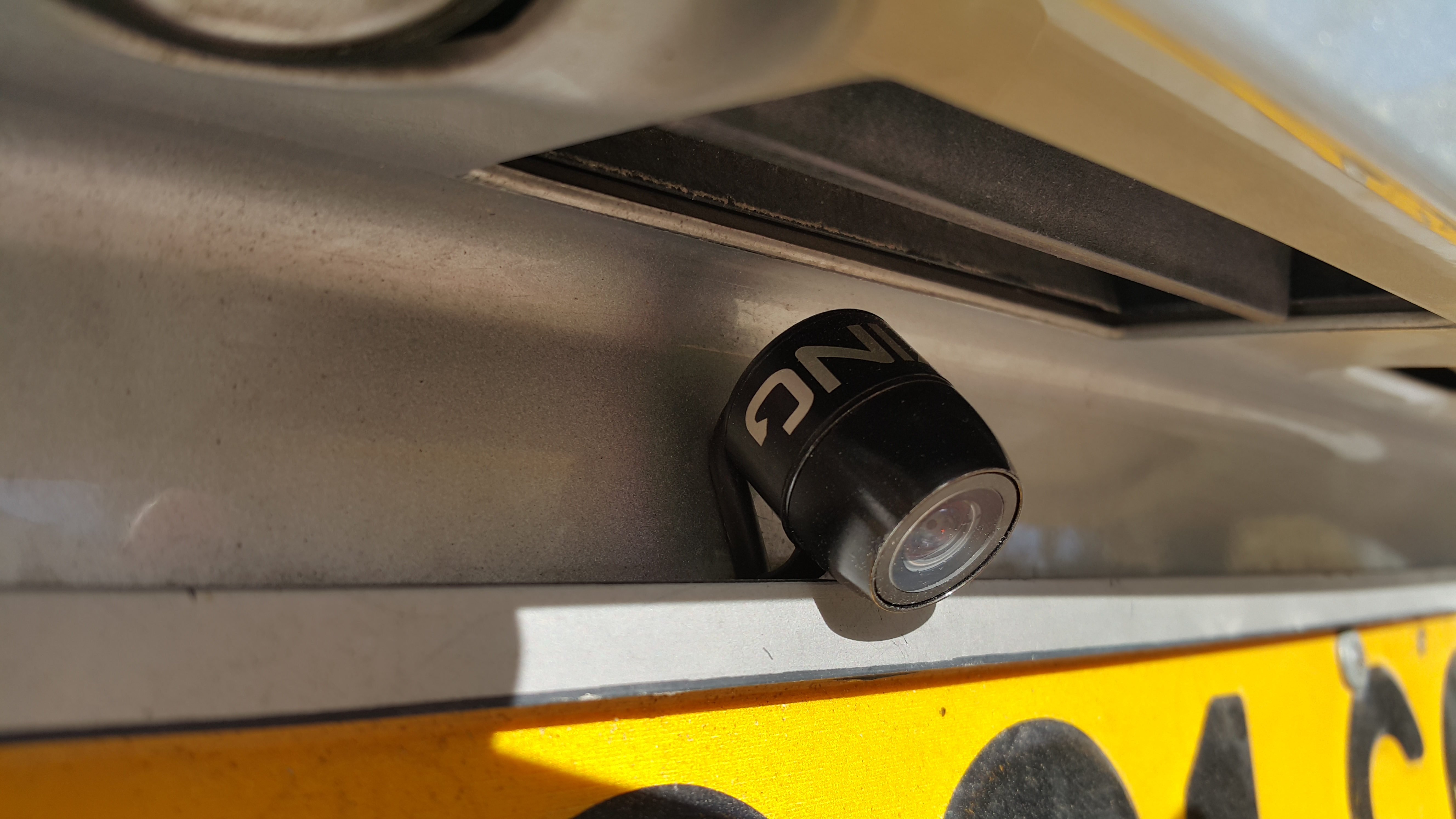

In the end I installed it just above the license frame, and all cables run through a hole hidden by the license plate.
This way, the camera is perfectly centered, I can clearly see the rear bumper, there are no visible cables at all.
The only downside is that sometimes you tuch the camera while opening the trunk, but it's not bothering me at all.
