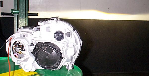

Originally Posted by I KOMPRZ
I dont know whats the difference between the Euro and US version, but if the pattern is Euro then I guess mine is euro version.
Actually what you have is UK spec.
Yes, there are 3 different specs. As Citron described:
Originally Posted by CitronC230K_03
____/ _____/ = US _____---- _____---- = Euro
And UK spec: \______ \______
Here are some pics: (order - EURO / UK / US )
Attached Thumbnails Bi-X: W203/CL203 OEM Bi-XENON Upgrade, Auto-Levelling & Programming thread-euro-spec-pattern.jpg   Bi-X: W203/CL203 OEM Bi-XENON Upgrade, Auto-Levelling & Programming thread-uk-spec-pattern.jpg   Bi-X: W203/CL203 OEM Bi-XENON Upgrade, Auto-Levelling & Programming thread-us-spec-pattern.jpg

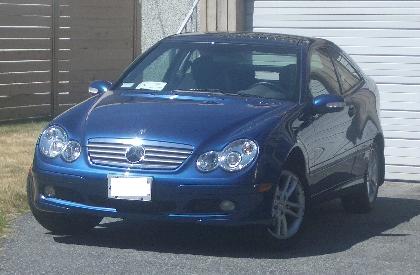

The Bix looks awesome, but my light pattern is kinda weird. I guess I need to take it to the dealer to have them adjust the level for the beam.
Welcome to the BiX club.
If you really want BiX, get them off Steve. (he had 2 pairs of bix about a month ago, I bought one of them). Yeah, there are flaws, but when I changed my halogens out my halogen lenses were much more damaged than the used bix ones, and I baby my car.
You can aim them yourself, not too hard. Play with the screw on the top of the assemblies. Yes, aim them too high and everyone flashes you.
Euro lights are like _____----- each light. That's normal, so you don't blind oncoming traffic. Definitely lights up everything nicely. There's a plate that moves between low and high beam (solenoid controlled), the bottom edge of the plate determines the cutoff pattern.

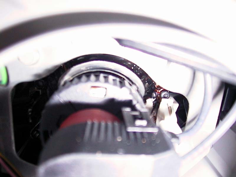

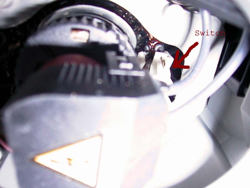

Damn after I removed the plastic cover, all I see is a big black connector behind the bulb with 2 wires coming out. I dont see any lever??
Please help! I am really tired of that pattern
Sorry to give you the wrong color on the switch..it's WHITE not BLACK.
Here is some pictures. It's kind of hard to take clear pictures since the wheel wall is blocking the way. The Switch is on the outter side of the xenon bulb which you can hardly see it but you can reach them by hand.
here are few pics...on passanger side(edit).
Attached Thumbnails Bi-X: W203/CL203 OEM Bi-XENON Upgrade, Auto-Levelling & Programming thread-switch01.jpg   Bi-X: W203/CL203 OEM Bi-XENON Upgrade, Auto-Levelling & Programming thread-switch02.jpg
uh huh! that explains it. I got it!!! Thanks a ton! I now have a clean straight cutoff line.
