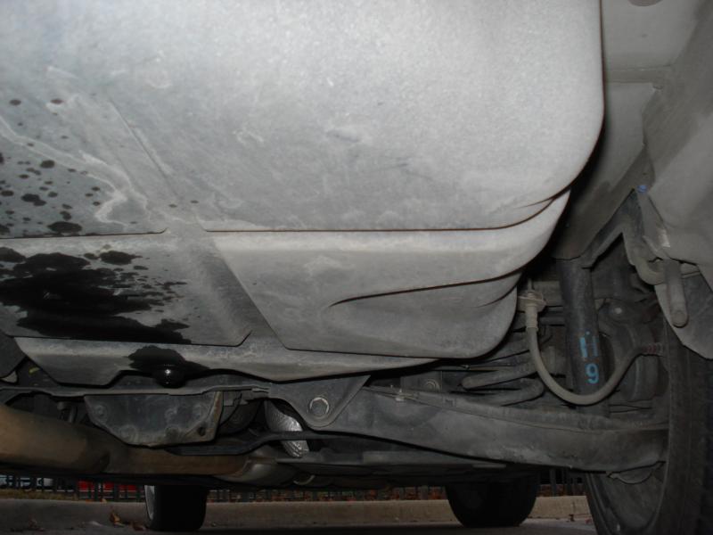

Question Bixenon:Do I have autoleveller feature in my car?
Hi:
I am a newbie and have been reading all posts avidly.I feel happy to have run into this group as I have been wondering to get bixenons for my C320 2003 model.My dealer says that if I didnt have xenons as part of the factory model then it means that I cant get bixenons done on my car.I hope I have posted this in the right place as its my first..

Wecome to the forum
Please complete your profile where are you?
If you are in America you can get away with fitting BiX without auto levelling. In UK, Europe, South Africa, Australia etc. you will get into trouble. Not permitted by law.
So technically you can fit BiX without auto levelling. The cost of retrofit of auto levelling to your car is prohibitive.
If you fit BiX all you need to do after fitment is get a dealer to use his STAR DAS to switch on Zenon = present in the cars menu system. Search the forum. A huge amount has been written about the conversion - Good luck
