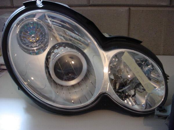

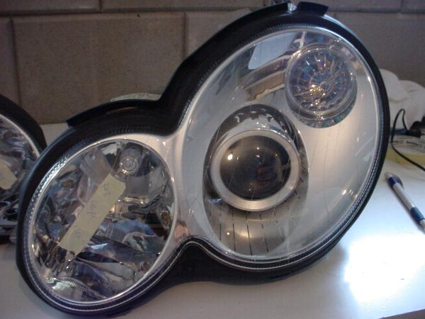

Here is a pic of what they look like once installed:
And some pics of the Bi-X before install:

After watching the installation on Saturday of my Bi-X, I would now dare to say that it is a do-it-yourself job, or at least for someone who is mechanically inclined. Really, all it took was the removal of the front bumper & grill with bunch of grommets and bolts, unplugging the old lights, replacing them with the new lights, plugging them in. And re-installing the bumper and grill. If you need instructions on installation, I'm sure that Steve will send some, if you ask, when you order your Bi-X. If he was in Puerto Rico, he would install them himself (included in the price).
The only thing you will need the dealer for is to set the car's computer to read/understand the new Bi-Xenon lights. That is called setting BIXENON=PRESENT. They will need to plug in the Diagnostic Star computer to your car to do that. At some dealerships in the USA, the Service Rep might do it for FREE, others will charge $10-$25 to do it. It takes less than 3 minutes to do it. You might want to take your Service Rep to lunch or something, and have them do it for you as a favor.

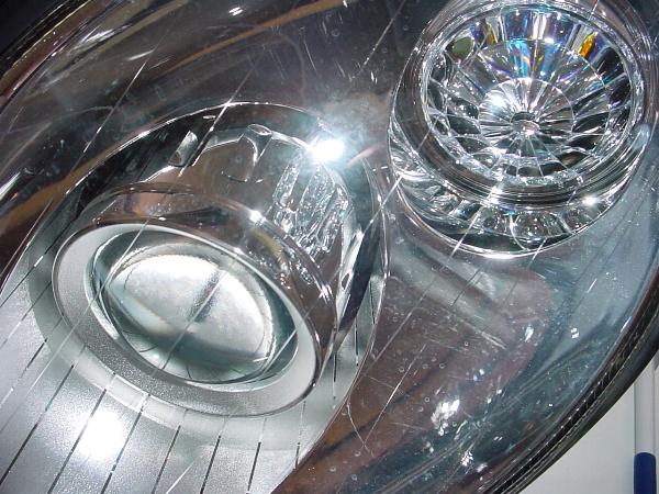

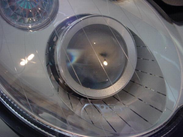

Mine had a very minor flaw on the glass, but I probably only noticed because I'm extremely picky. Then again, it's not enough to even bother me and probably not even worth mentioning. Point is, there may be minor flaws, but it's unlikely to be something that you'll notice.

here's a pic...find the flaw and I'll give you a shiny nickle!

dude, there's a rock chip on the lower left edge of your right fog light !!!
