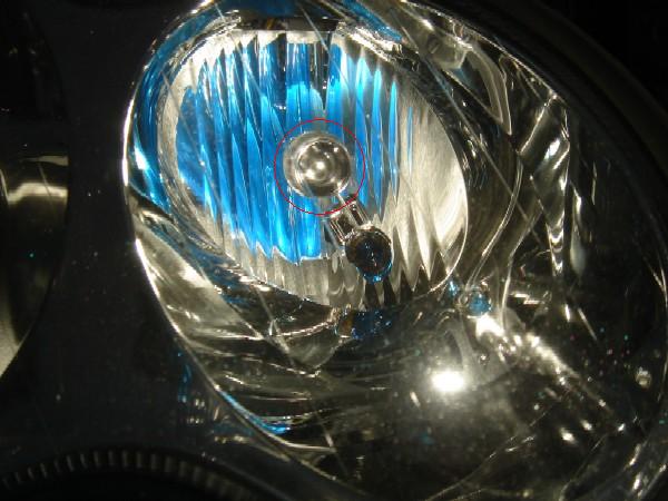

Okay, so I circled the cover that you have to open in order to get to the halogen high beam in bi-x.
I also circled where the high beam bulb is on the headlamp assembly.
Attached Thumbnails Bi-X: W203/CL203 OEM Bi-XENON Upgrade, Auto-Levelling & Programming thread-picture-078.jpg   Bi-X: W203/CL203 OEM Bi-XENON Upgrade, Auto-Levelling & Programming thread-picture-079.jpg   Bi-X: W203/CL203 OEM Bi-XENON Upgrade, Auto-Levelling & Programming thread-picture-077.jpg

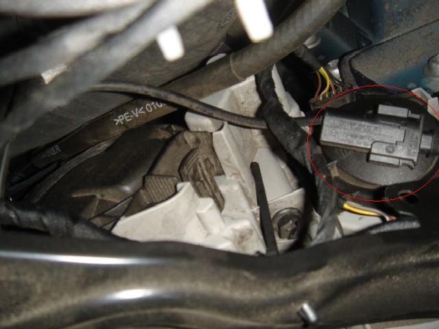

Heres what it looks like.. Jeez, do i have to unscrew those in order to get the bulbs out??
Attached Thumbnails Bi-X: W203/CL203 OEM Bi-XENON Upgrade, Auto-Levelling & Programming thread-bix.jpg
Old May 17, 2006 | 02:41 AM
  #1334
14cue's Avatar
Joined: Feb 2006
Posts: 2,144
From: Vancouver, B.C. Canada
05 C55
no you dont have to unscrew those - i dont think. what year is your car?
mine looks very simliar but i didnt need to unscrew any screws. it actually very easy to do.

You are looking at the correct place, but it's been so long since I replaced that bulb, that I'm trying to remember exactly how the bulb comes out.
If memory serves me correct, I think you squeeze on the top and bottom portion of the (black surround) and twist quarter turn to the left (lefty loosey, righty tighty). I may be wrong about the squeezing, but I know it was a twist out bulb replacement.
